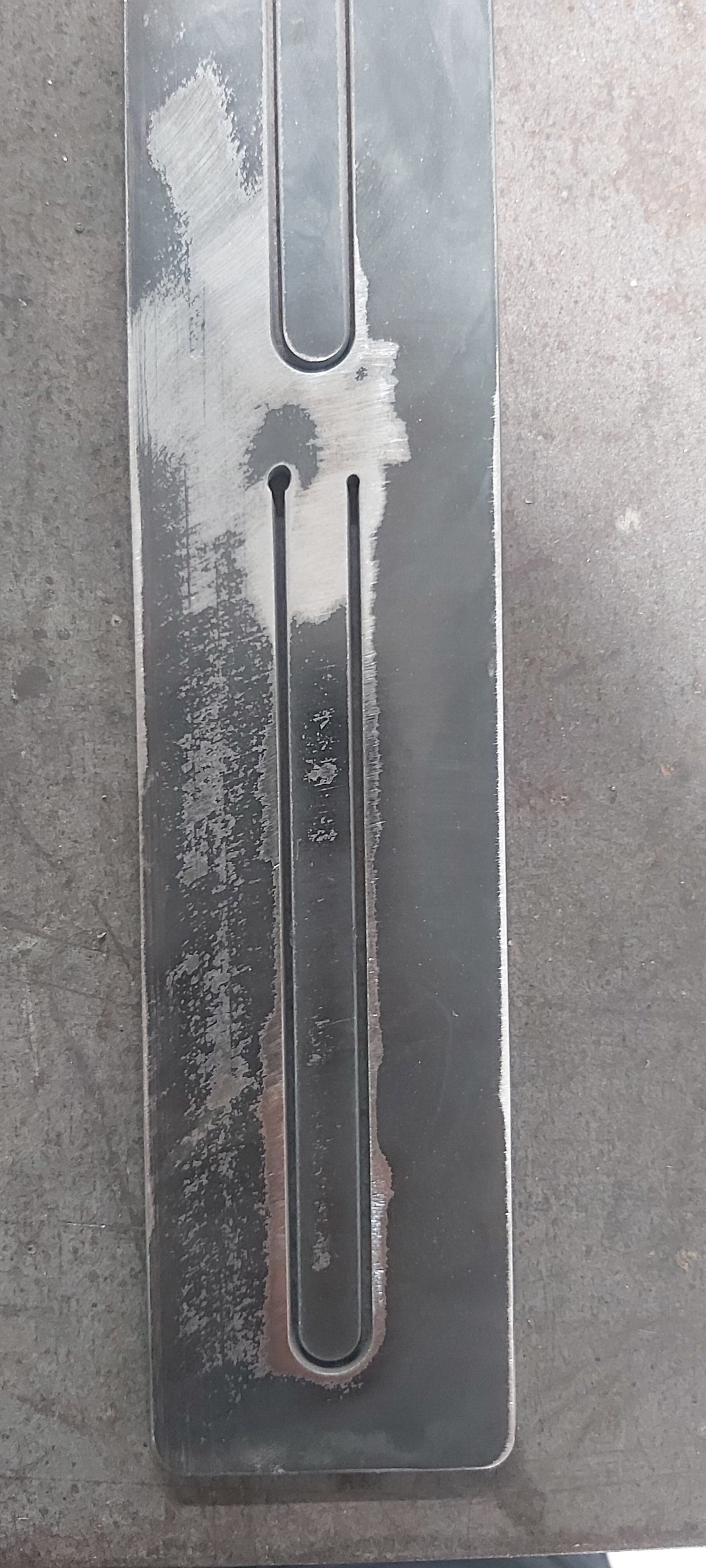

Hi all,
I am currently having a few issues with my pierce delay on straight lines. No lead in or lead out, kerf width set to 0. Using a hypertherm 45XP with standard consumables with sheetcam and fire control. Currently not using my THC due to a faulty unit, which Langmuir are replacing !!
Sorry for using metric units but I am from Australia. Steel is Hot rolled 3mm sheet (11G I think), starting point was at hypertherm’s recommended cutting specs then pushed the pierce delay out to 1 second.

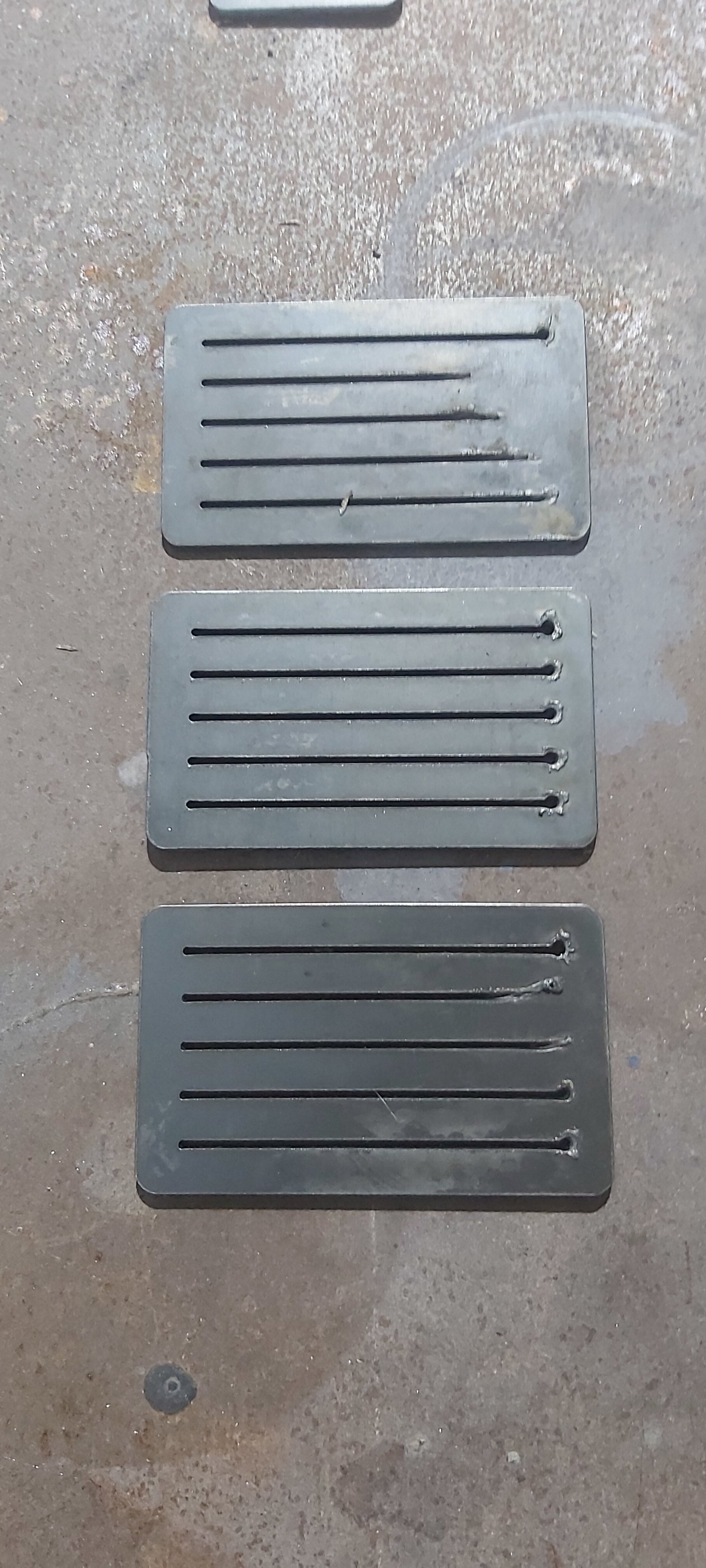

The first pierce no matter how low I set the delay always blows out. The top line on each plate in pic 1 is 0.3 and the last is 1.0s. Anyone have any suggestion on what could be going on ? Is it a voltage issue ?

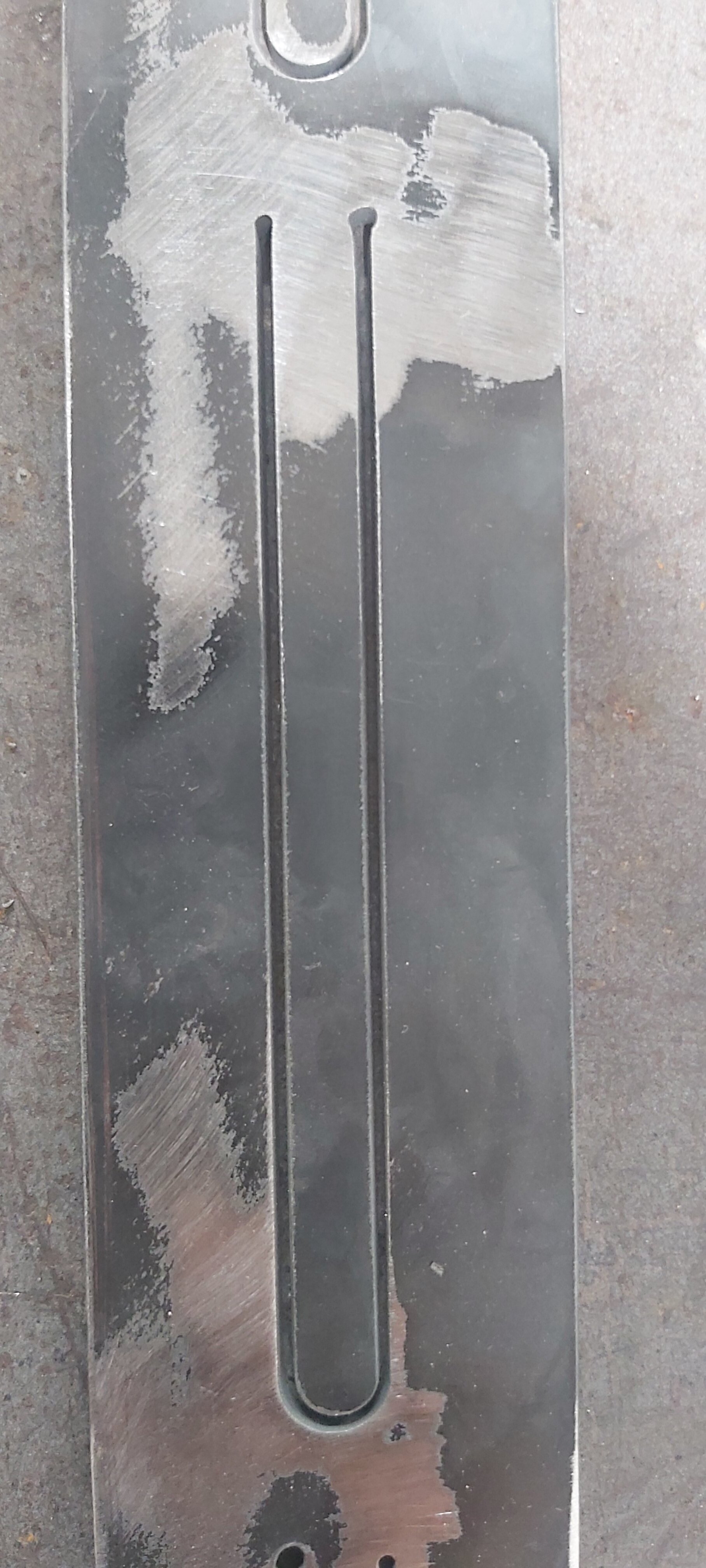

Second photo show the same “Blow out” on the first pierce of the program. 3rd shows the 2nd pierce which was actually set longer then the first.
I think subsequent pierces are always shorter than the first because of post airflow. I think.

Do you have your kerf width set to zero or your pierce clearance set to zero?
You’re going to want your kerf size set to whatever your kerf is and your pierce clearance set to zero.
When I cut break lines in 11g I set sideways compensation to center, pierce clearance at 0 and a .3 pierce delay at 45 amps.
The first pierce will always be a tad longer. Either make your first cut something with a lead in or trigger the airflow somehow prior to running your program.
If the top line on each plate is .03 and the bottom line is 1 on each plate, then I don’t understand the variation in the pierces. How was the test program run? Did you cut all three plates and lines in one program or did you run each plate separately?

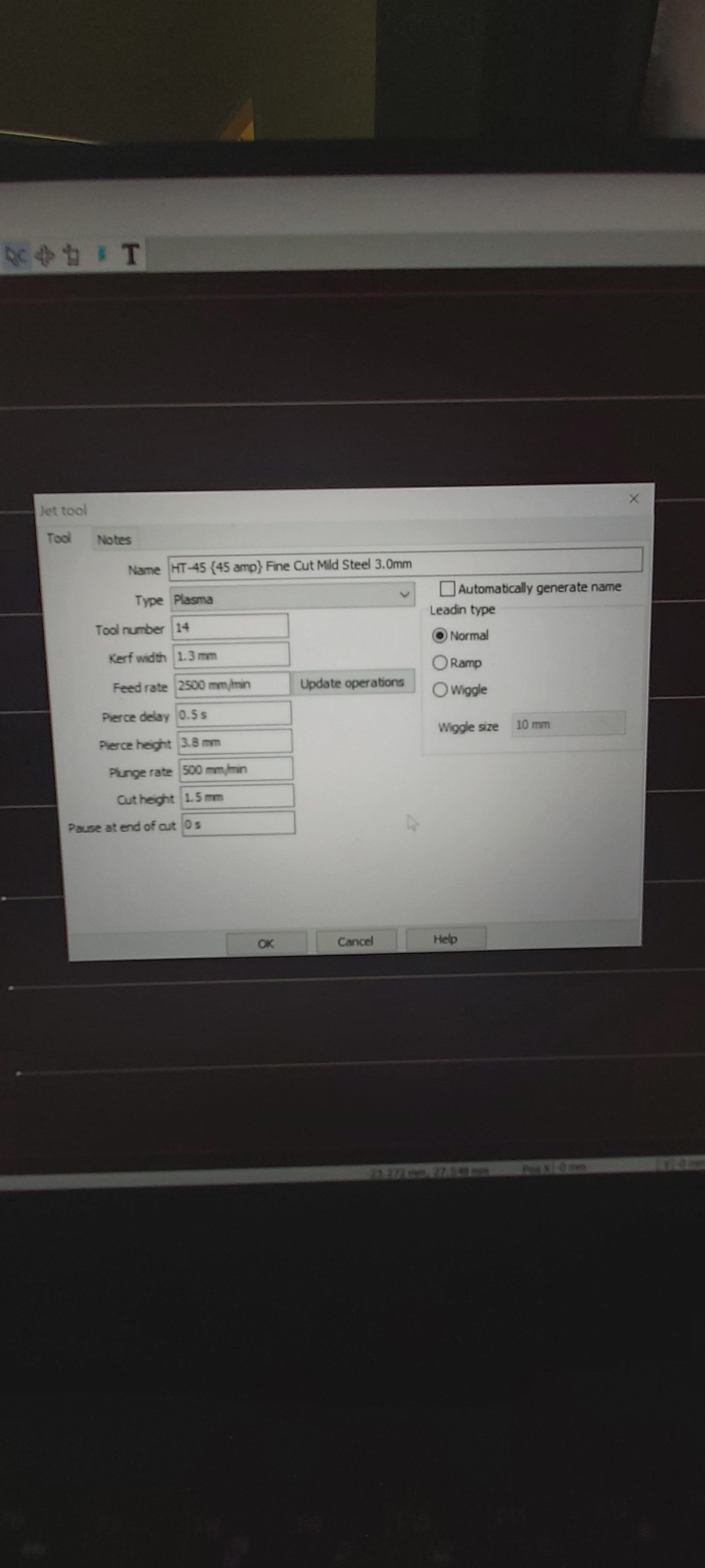

Yes kerf width was set to zero as recommended in another post of this forum. I am unsure how to set pierce clearance tho ? Is that the same as plunge rate? I am using sheetcam, is that possible ?
The test cuts where done one plat at a time. Each line is a separate layer with its own tool settings (Kerf width at zero and pierce delay changed)
Sorry the second plat was at 0.6 , 0.7, 0.8 , 0.9 , 1.0 delay

Now that you clarify that your test samples make perfect sense. Your initial pierce at .06 is too long for the first pierce of a program without post flow, and with the post flow on hitting the second pierce, is just ever so slightly too long.
To get a close to perfect as possible, you would want your first pierce slightly shorter to account for this, then subsequent ones slightly longer. Or just have your first cut of a program have a lead in. I do three layers for my programs that have in, out, and no offset cuts.
Thanks mate, the first pierce of the top plate is actually 0.3s then it goes to 0.4 on second cut where you can see the torch has travelled already. i will start playing around with it a little more once my new VIM box arrives !
I’m talking about your second plate. You will likely see slightly different results when your THC is working. Unless your IHS is working normally, then nothing will change. But the second test plate settings are very close to what I use.
