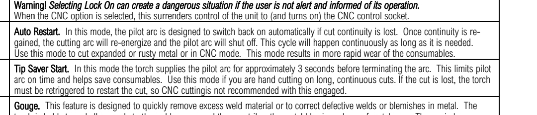

Ill give that a try. What is odd is its consistency of working on the first cut. I can have a program with 2 small cuts. The first will delay and the second will not. I can instantly run that program a second time and it will do the same thing. Delay on the first cut but not the second.
Like I said put it in tip saver. Were you have it its for expanded metal when hand cutting.

Interesting. The only reason I question that is because everlast says not to use tip saver with cnc.
Just do it.
@jtpfarm …that is what I was looking for… @mechanic416 George is right…
Place it on tip saver…
george has forgotten more than most of us will learn about plasma…
