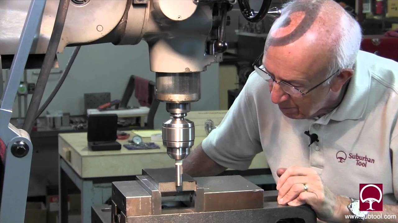

Do you have an edge finder? Could try that and possibly narrow down if the problem is with the probe or elsewhere.
The only thing I have to find edges is the touch probe Langmuir supplied and the dial indicator.
This is the edge finder I’ve been using, which I’ve had for years.
https://smile.amazon.com/gp/product/B002SG7PPM
It is so inexpensive, I should probably order a spare. The version without the point I one end is a few dollars cheaper:
https://smile.amazon.com/dp/B002SG7PPC/
The major draw back vs. a digital touch probe is that a wobbler can’t be used to set Z.

Has anyone ever tried something like this?
It would have to be done manually and it can only be used with conductive materials which is fine for me.
Its a Precision Easy-View Electronic Edge Finder
I have never used one but I can see the attraction for finding the Z offset.
I saw a YouTube video many years ago with a demo showing that mechanical wobblers should always find the spindles true axis of rotation, even if the collet isn’t running concentric.
Of course, the same issue should apply to any electriconic touch probe. Which is why they need to have a calibration mechanism and be constructed to tight tolerances.
