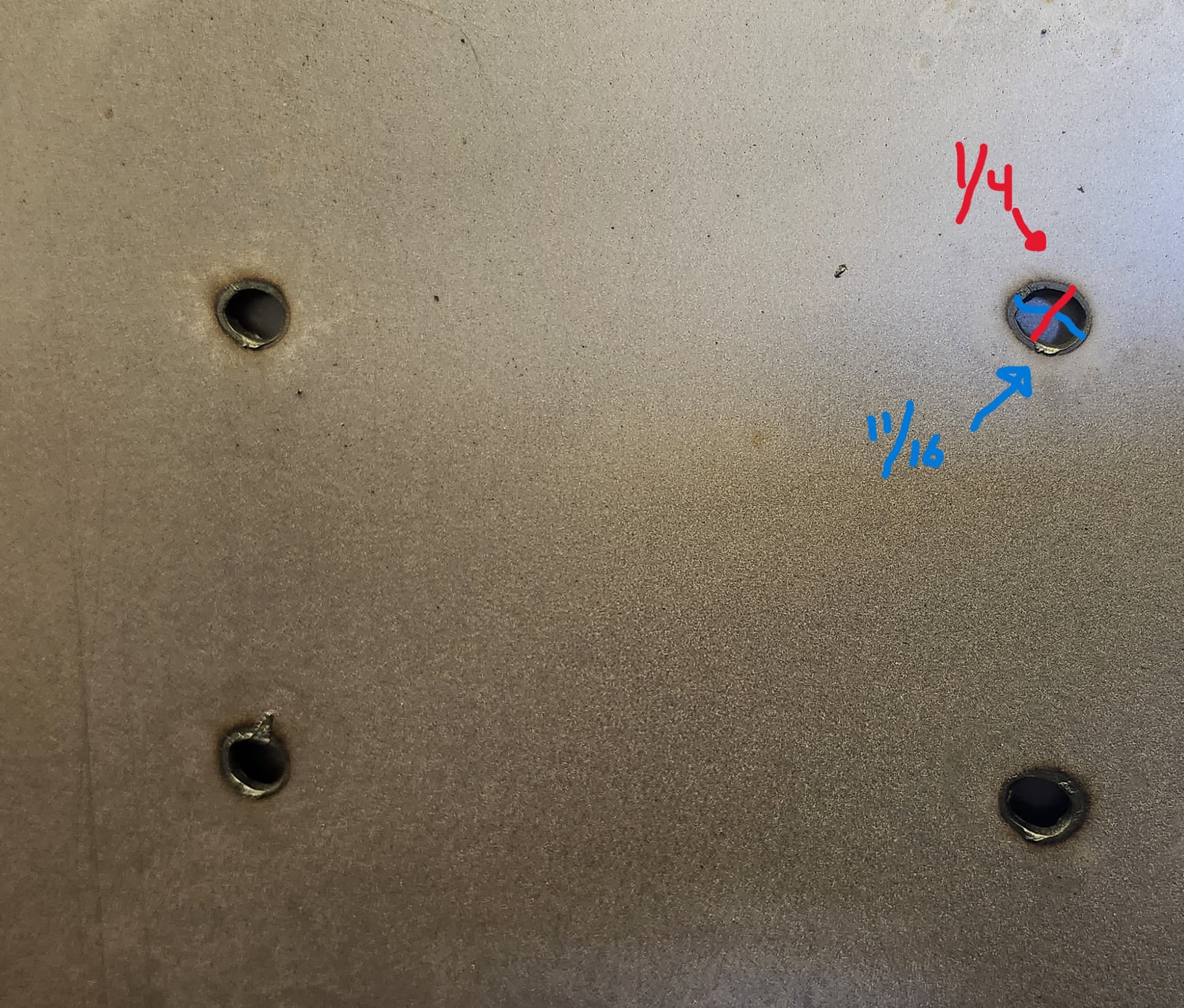

Hello all,
I have a Crossfire XR with a Hypertherm Powermax105 cutting 14ga at 90IPM, 40 amps and I’m getting slightly oblong holes. The holes are all oblong in the same orientation. I have a 60 degree lead-in, 0.0625 length. Everything is tight, and nothing has changed from yesterday when I made circular holes. The oblong-ness is most noticeable in the 0.25 holes as opposed to the .375 or .625 holes. Is there something I’m missing?
Thanks.

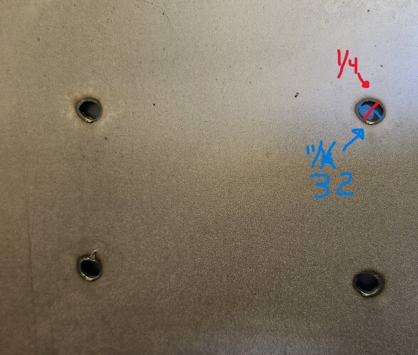

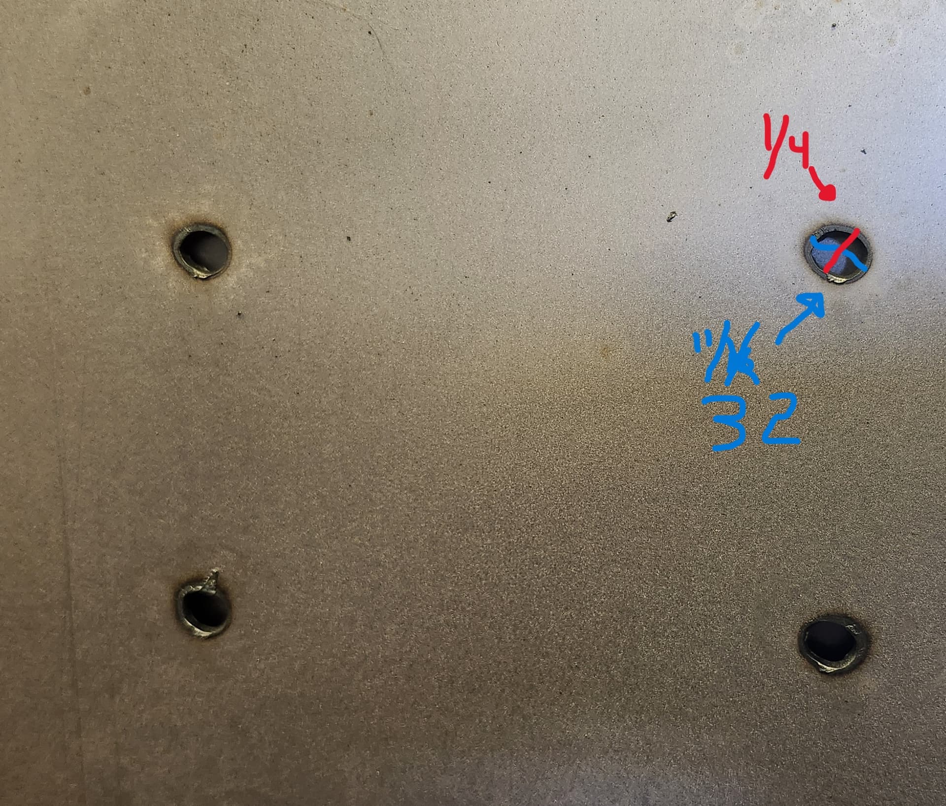

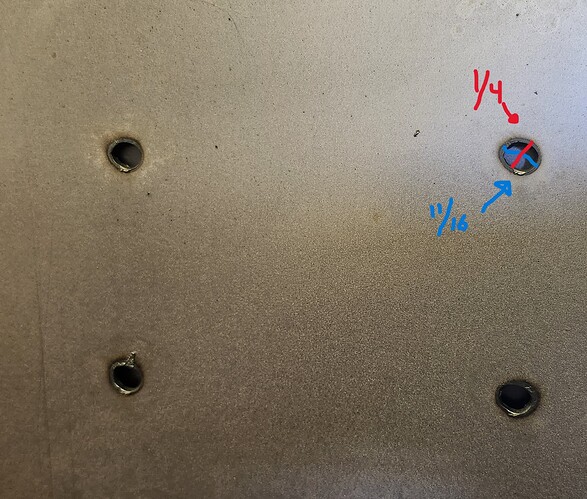

Updated, correct dimension:
Here is a pic of what’s happened:
1/4" hole with a long axis dimension of 11/32". Everything “feels” tight, but I’m at a loss now.

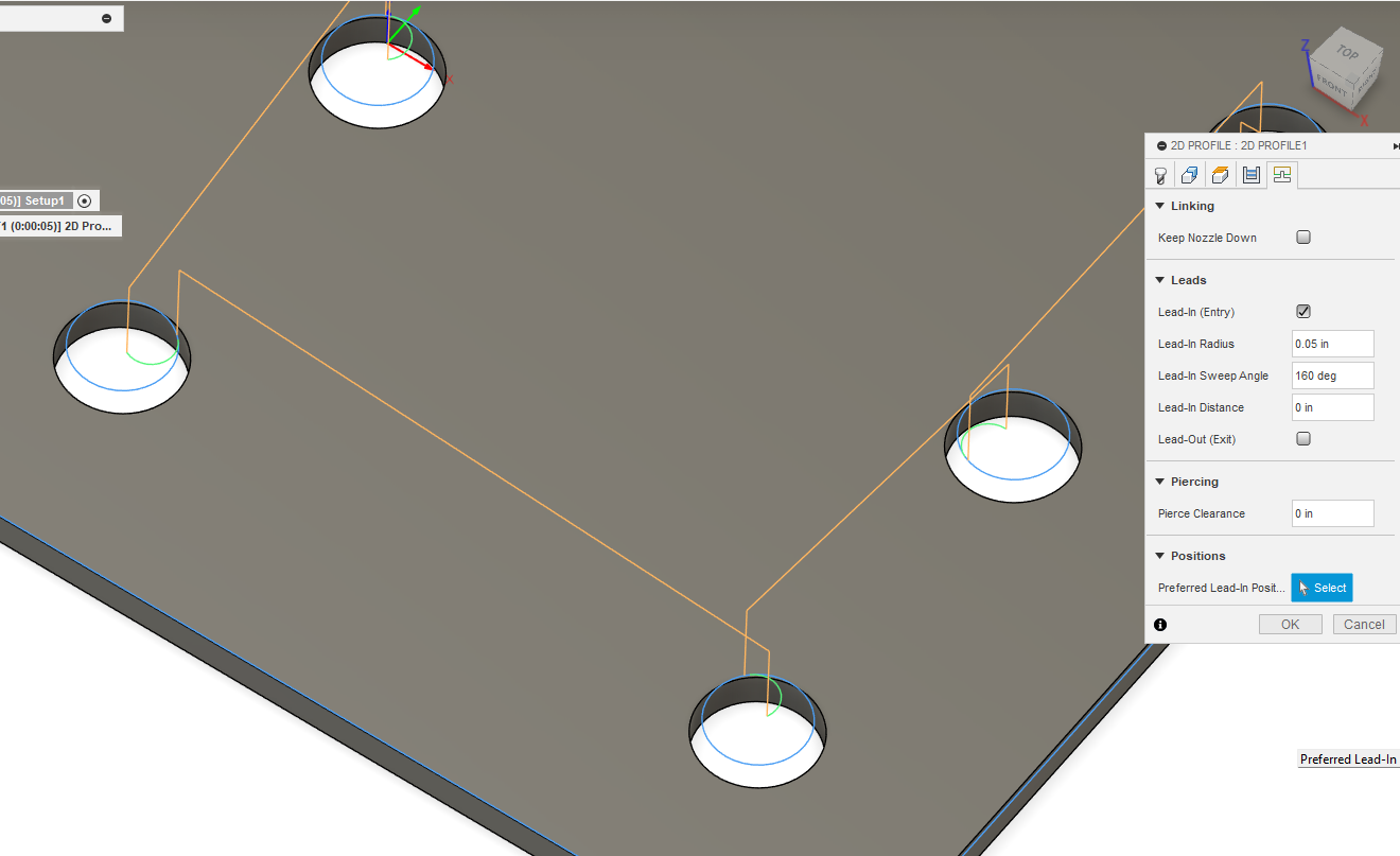

Here is an example CAM with 0.25 inch holes:
Depending where your lead-in/lead-out is at, that could be distorting your hole. As Phillip said, it is challenging to get a perfect cylindrical hole with 1/4". Starting in the center and don’t set a lead-out is your best bet.

I’m going to give your linking settings a try. My pierce clearance height was set at 0.052", which might be part of the issue, but I also only had a 60 degree lead-in sweep angle.
I used the charts as provided by my boss. I checked all the settings, measured the heights, and everything was as programmed. We have heaps of air, and a dryer, and that is input at 65 psi. We’re going back to the other consumables today (and cutting 12ga) so we’ll see how that works out.
The “pierce clearance” setting in Fusion has nothing to do with height. It is just additional length added to your lead in. It isn’t necessary and should usually be set to zero.
