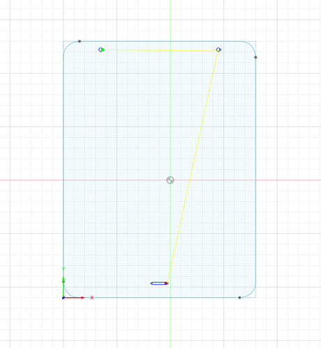

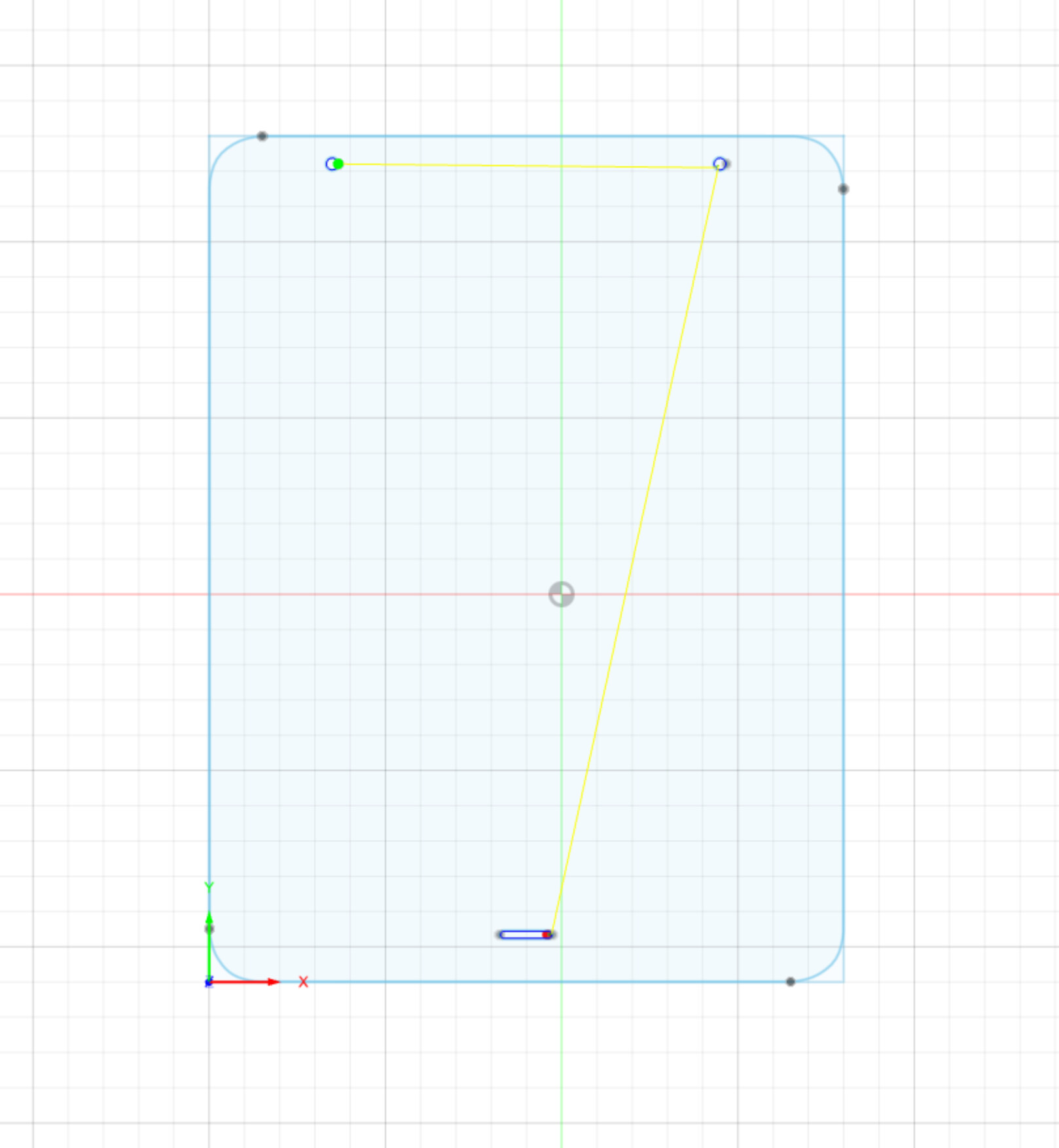

Doing a project to cut three holes in a piece of alumnum sign blank. First two cuts are fine third one gets error when I hit retry cut, generate, start it cuts the third hole fine. What am I missing?

I’m using fusion360

There is nothing wrong with that code, that would prevent it from firing on the third cut loop. The problem is not in the code or Fusion.

SOLVED I added +10% to the pierce delay and that took care of it.
