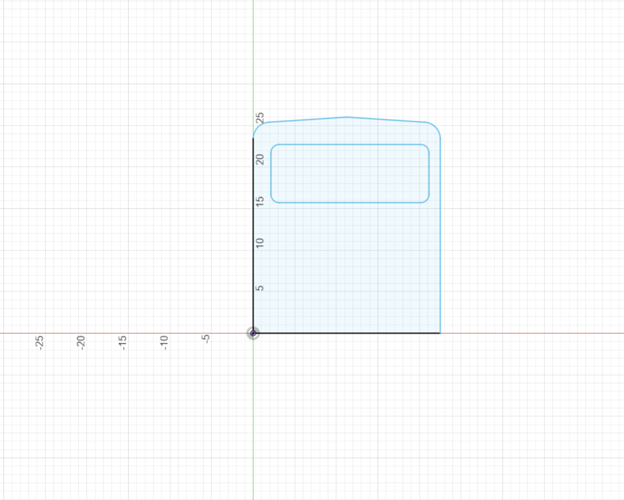

Can anyone help with a question about fusion 360?
I have googled and can not come up with the answer.

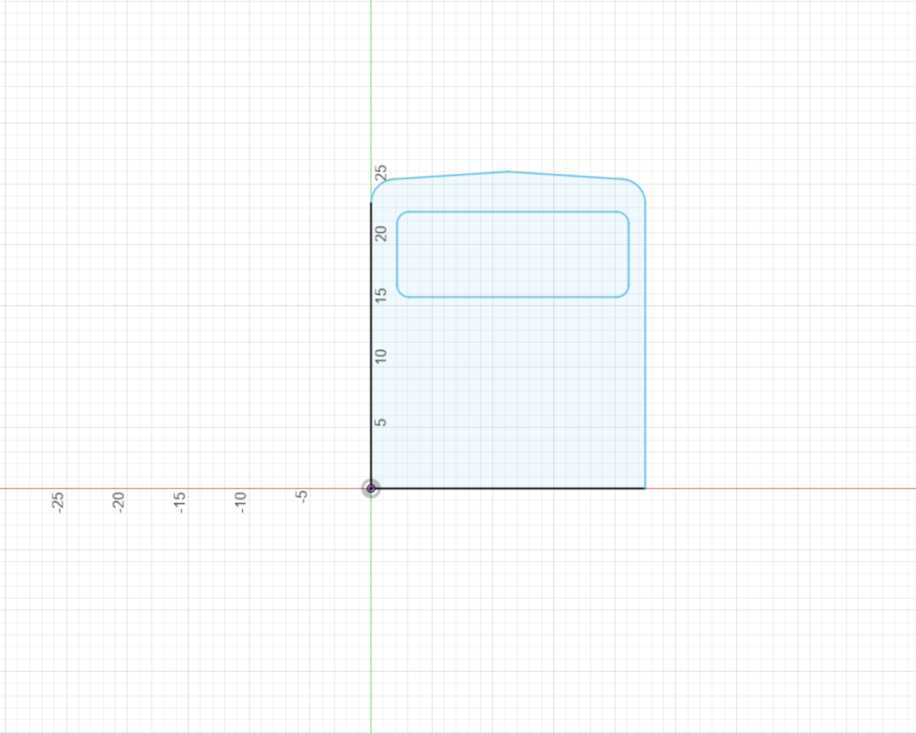

What I need to do is cut out material inside a shape. I’m using sheet metal, I drew a door, then a rectangle inside of it for a window opening and need to remove the material inside of it. it still shows it as blue color and I assume that it is not going to be cut out???
I did watch the video here where he makes the bottle opener and draws a circle then the circle turns white and I assume that will be cut out. I cant get mine to turn white.

I have been trying to do this for a couple hours and I’m unable to have the window cut out of the door.
I have watched a few YouTube videos also but they are on 3D objects. this is flat sheet metal.
If anyone could help with the correct steps I would be most appreciated . One other thing I did not find a place to set the thickness of the sheet metal, do I need to do that?

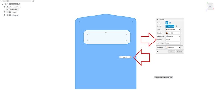

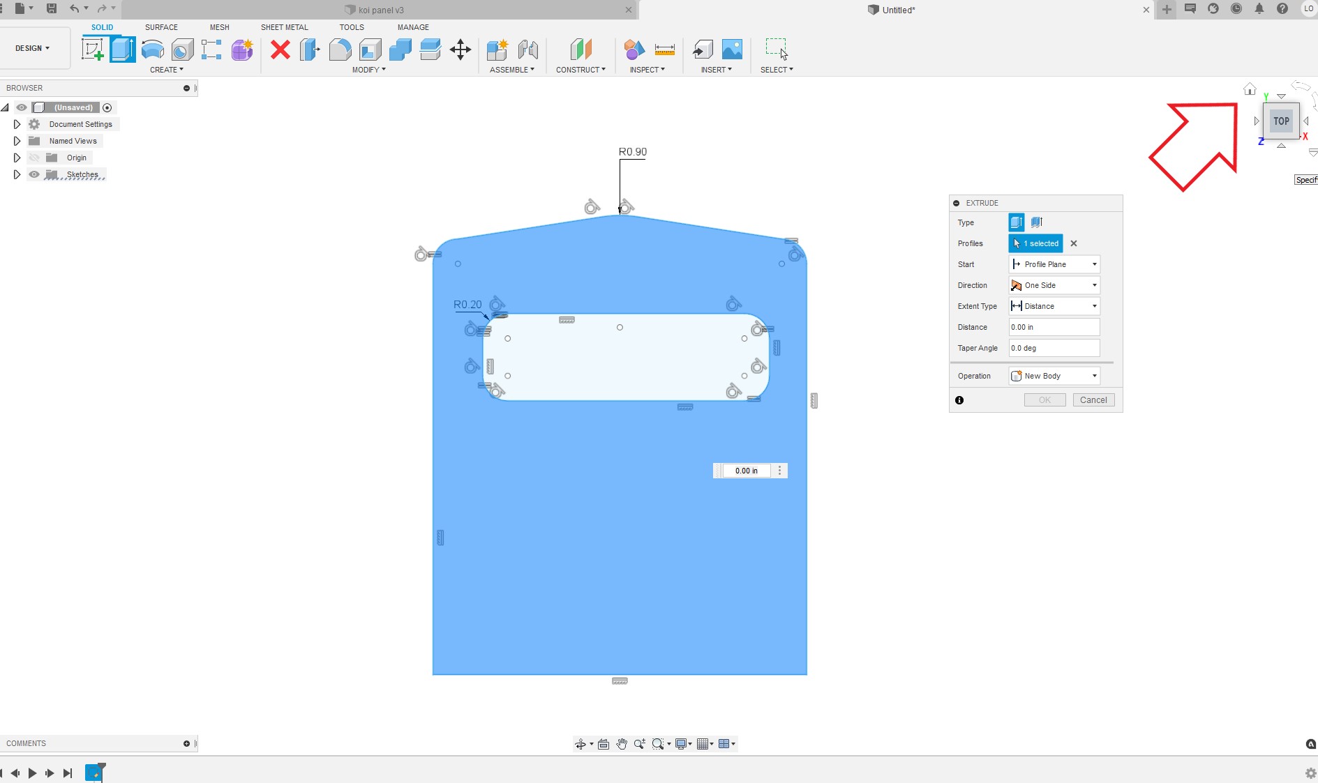

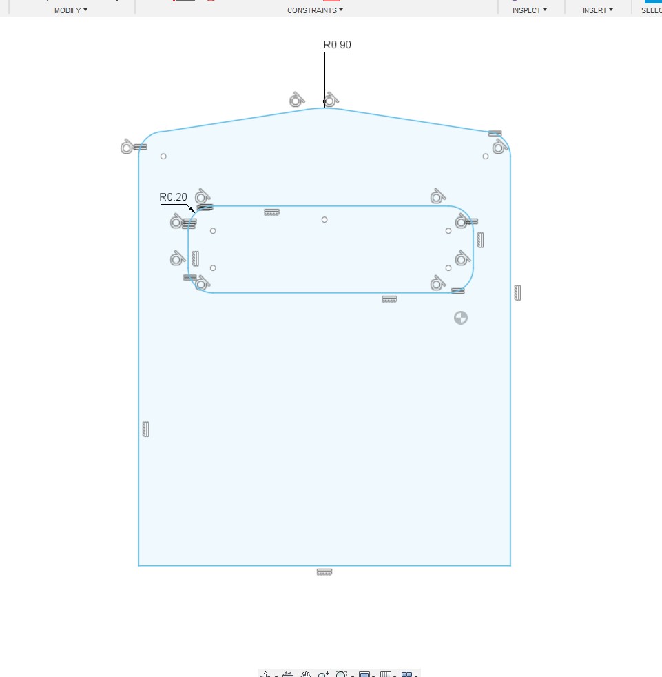

when you select extrude/ push pull and hover the mouse over the scetch does it turn blue?

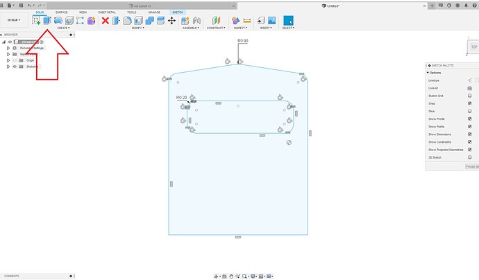

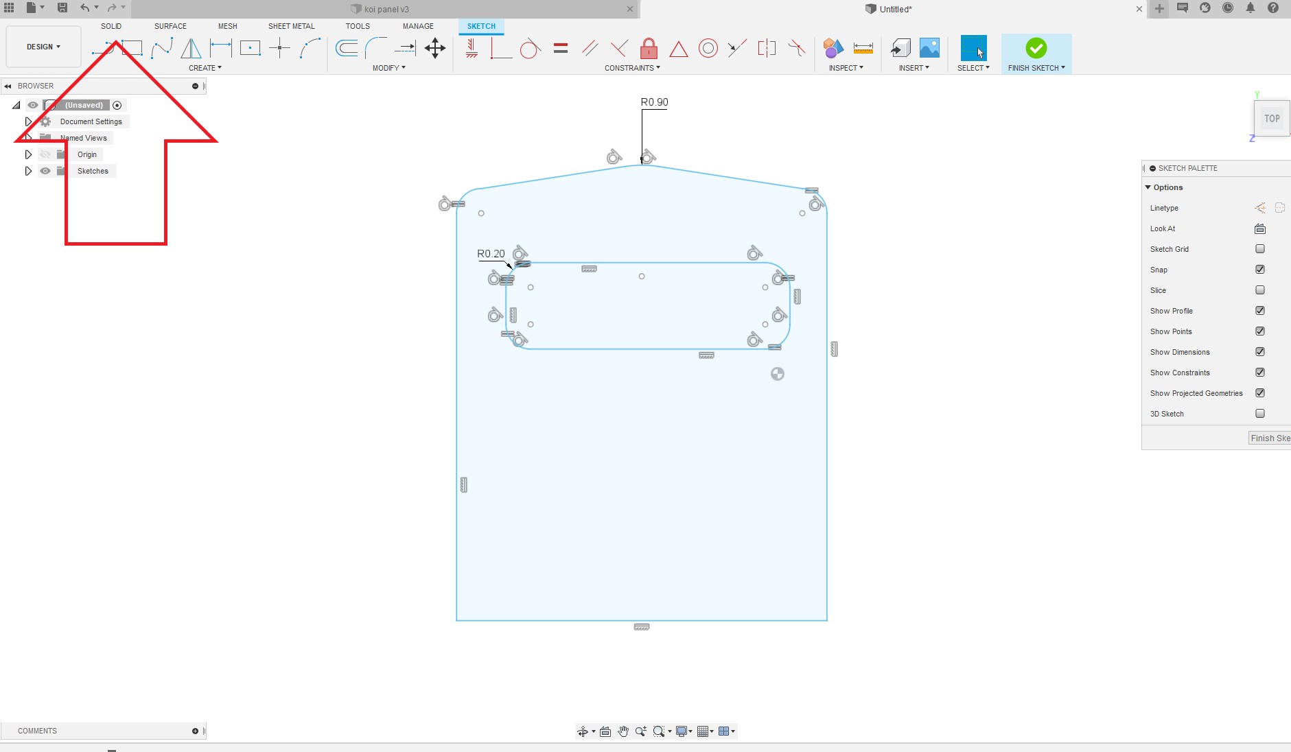

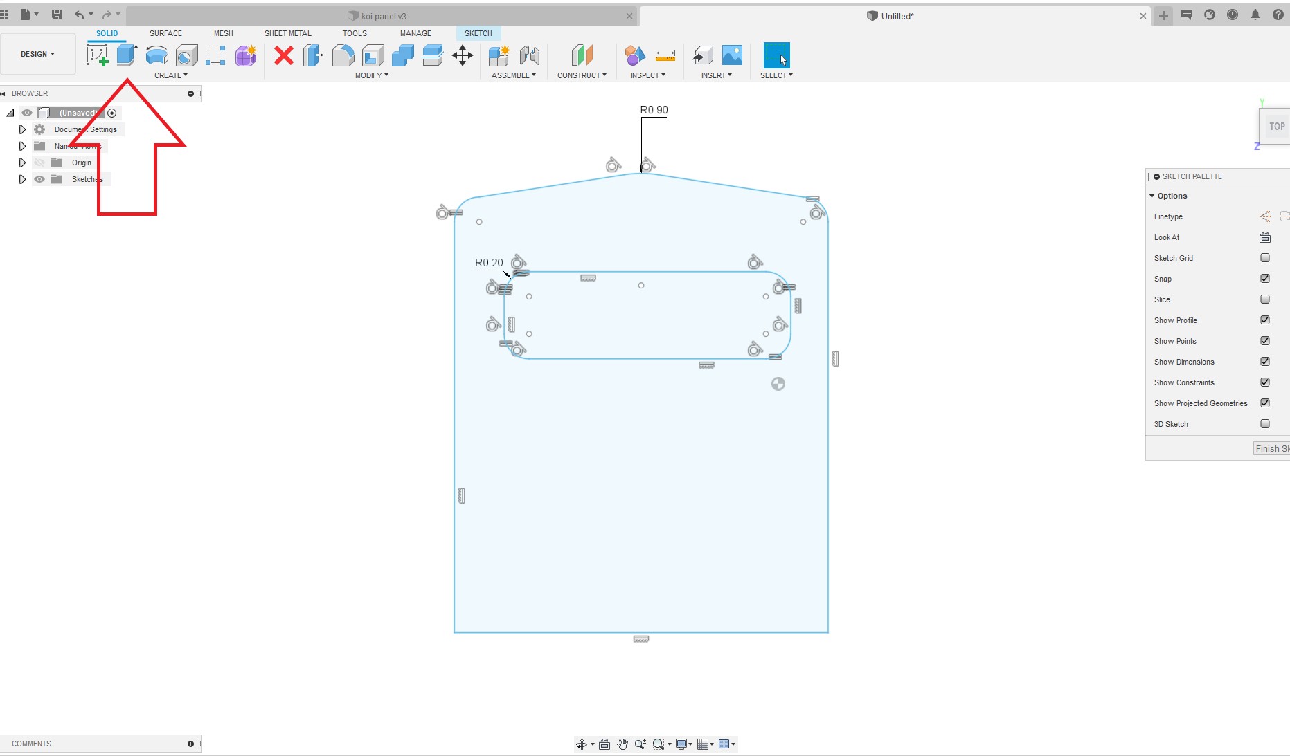

Are you in the sketch workspace?

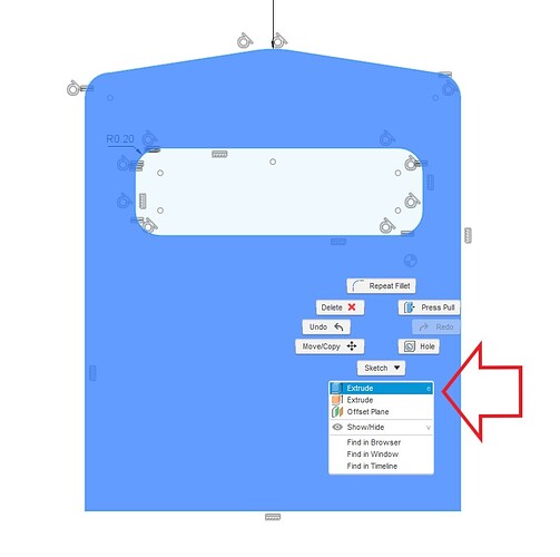

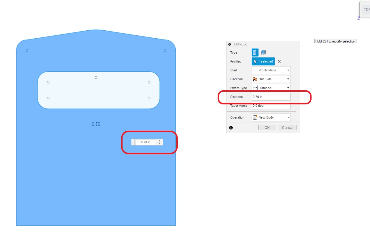

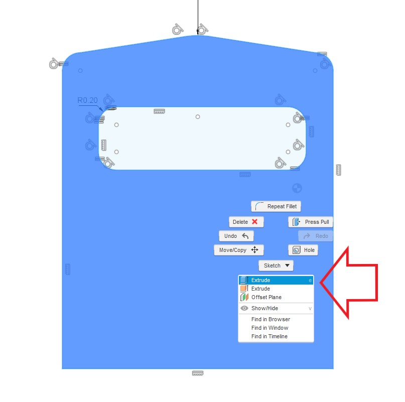

Right click on the surface that you want to be solid.
Then click extrude. It will be available in the menu that pops up when you right click.

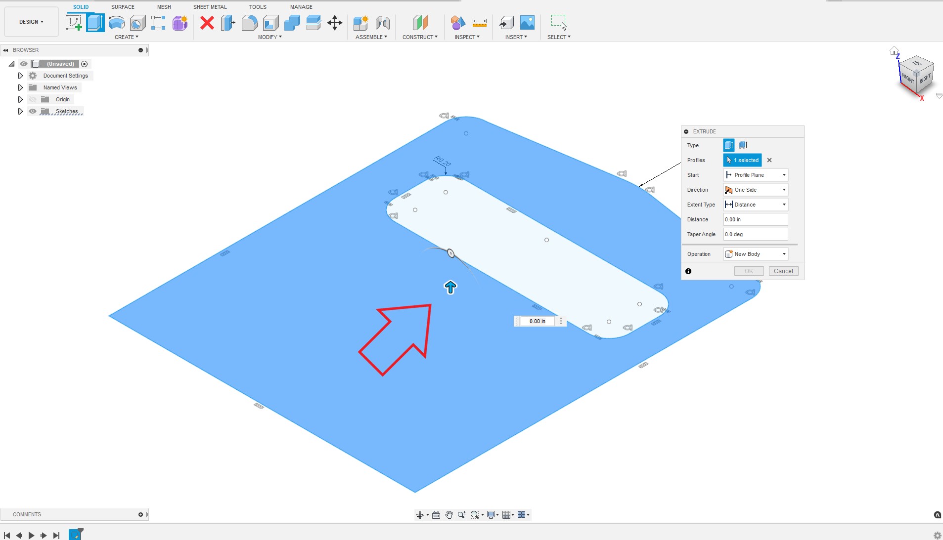

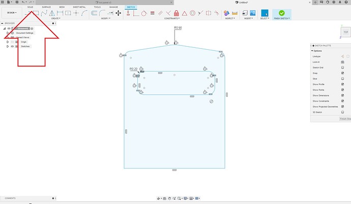

Sometimes it’s helpful on the top right hand corner in the navigation area to click home and extrude from that isometric view
Right in measurement of desired thickness hit enter.
As soon as you extrude a sketch you will go from the sketching workspace to the design workspace.

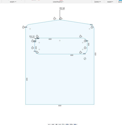

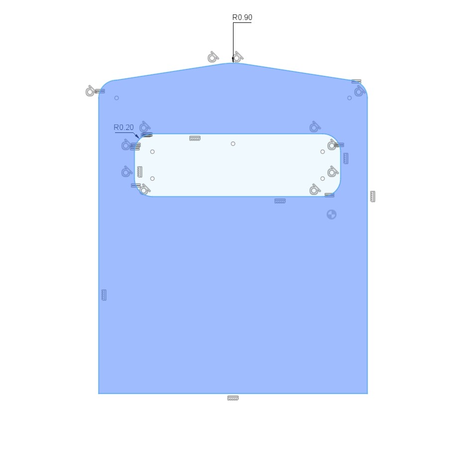

hoover over the area to be extruded. it will highlight in a darker blue
right click and this menu will pop up.

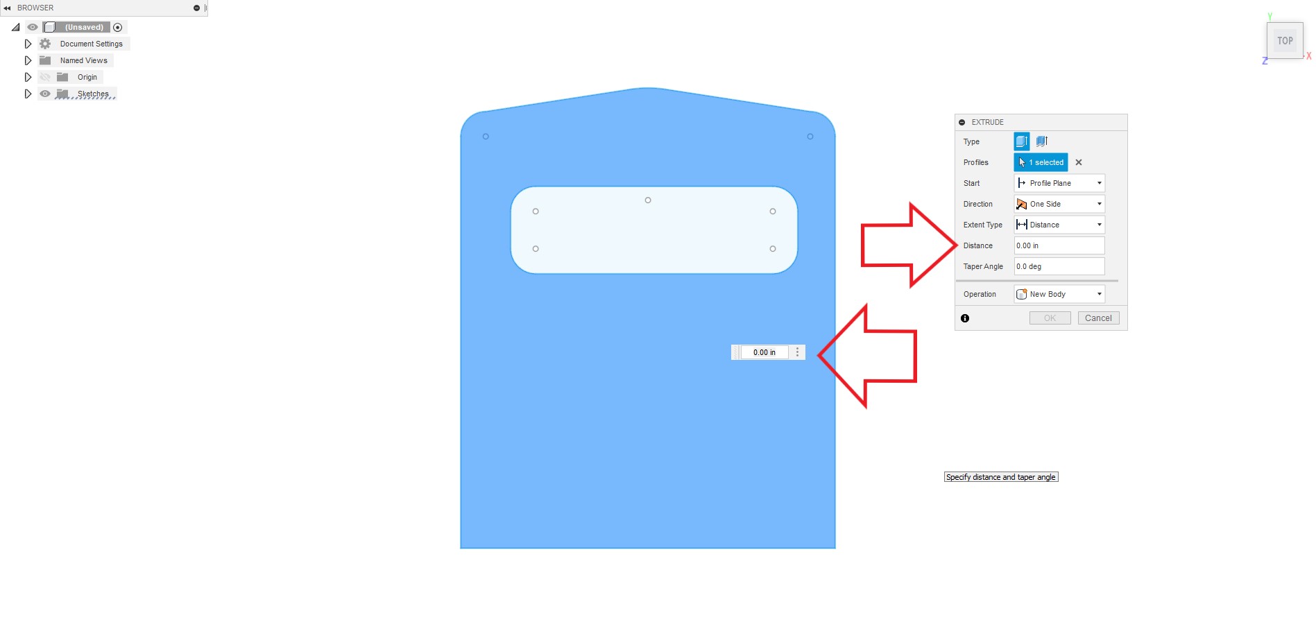

here is a alternate way to select the extrude tool.
once selected this menu will pop up fill out thickness in either of these two spots
some find it useful to be in a isometric view for this
in the isometric view you will also get the option to pull your extrusion.

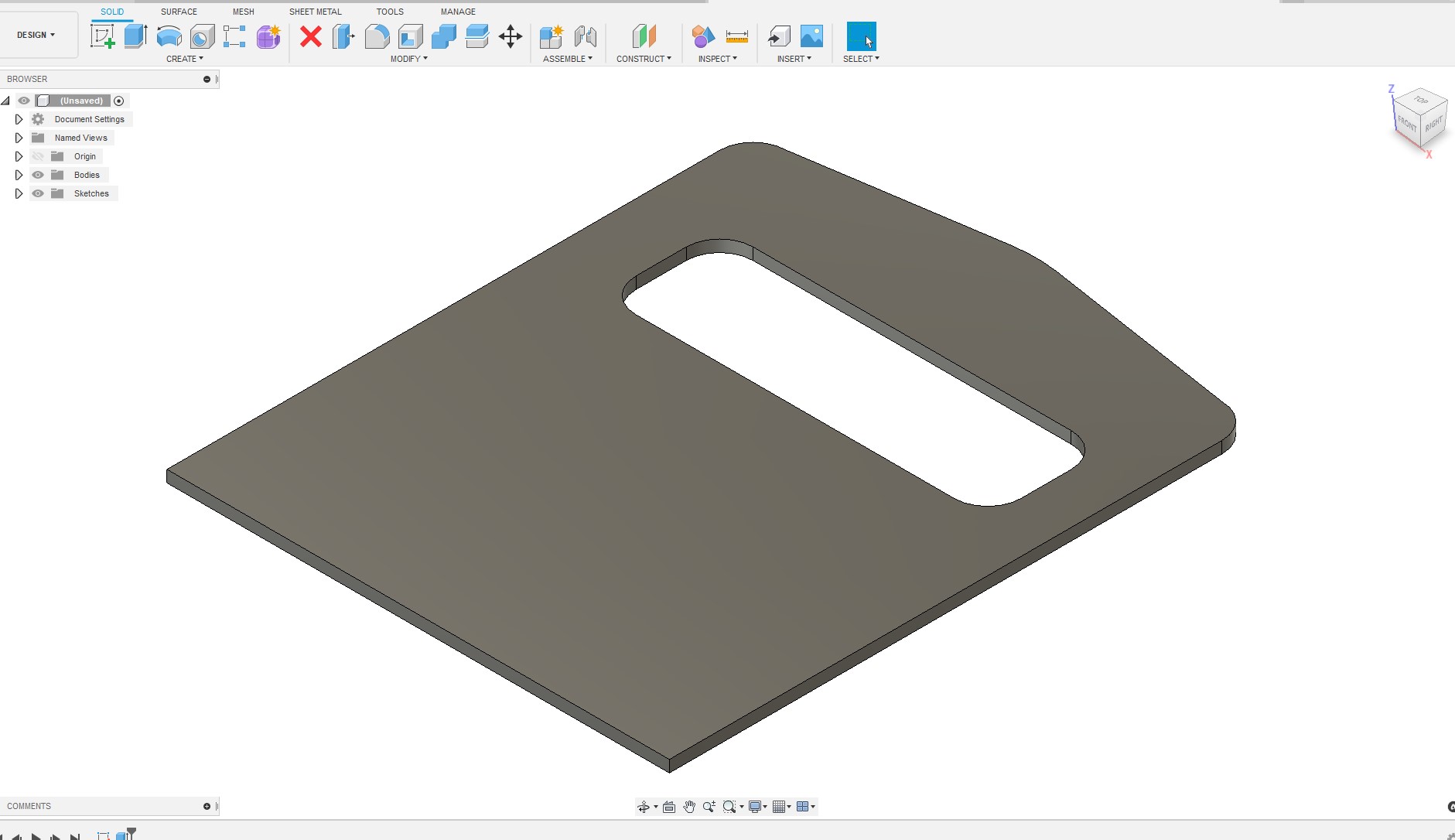

once extruded will will be in the design workspace with for new 3D model
this is fantastic, thank you! for taking the time to make me a tutorial! I had watched the training video several times but this step just was not clear to me.
