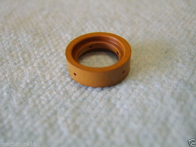

That swirl ring is for the PT/IPT/PTM 80 torch’s. The PT/IPT/PTM 60 torch’s is this one.
s45 swirl ring

I hear your the wizard whith the 62i to crossfire pro connection!!! Im having troubles, my plasma wont fire. I have a 62i with the machine torch, ive got good air pressure, good consumables installed correctly, my torch is clamped to the mount correctly ive looked at every possible problem, if i jump the 1and 2 pin on the cnc port the air clicks on but no fire anything helps???
Welcome to the forum.
Do you have a hand torch? Has the torch ever fired? Is it a Everlast machine torch? Are the consumables the right ones? Air must stay in the green about 70psi with air flowing from the torch. Swirl ring installed?
I do not have a hand torch, the machine torch is an everlast torch that came new with the plasma cutter. The torch has never fired, my consumables are correct and swirl ring is installed, air psi is good when flowing through the torch
I did not ask if air was good, it needs to be at least 70 psi or the torch will not fire.
Air is at least 70 psi
You could also change the electrode and try it again or when you are with the plasma cutter you can call me and we will check it out.
Copy that ill try reaching out to you tonight
Yes or no?
That is also good to go
i tried calling you earlier, im still not having any luck after checking continuity in my torch and a short conversation with everlast tech support. im getting a bit discouraged and would love to get this thing working correctly
problem solved… thank you George. turns out it was a few issues 1. air pressure -fix. not enough 2. bad consumables we swapped out the consumables and bumped up the air pressure and BOOM fire baby!!! cant say thank you enough for the help and after hours time to get me cutting.
