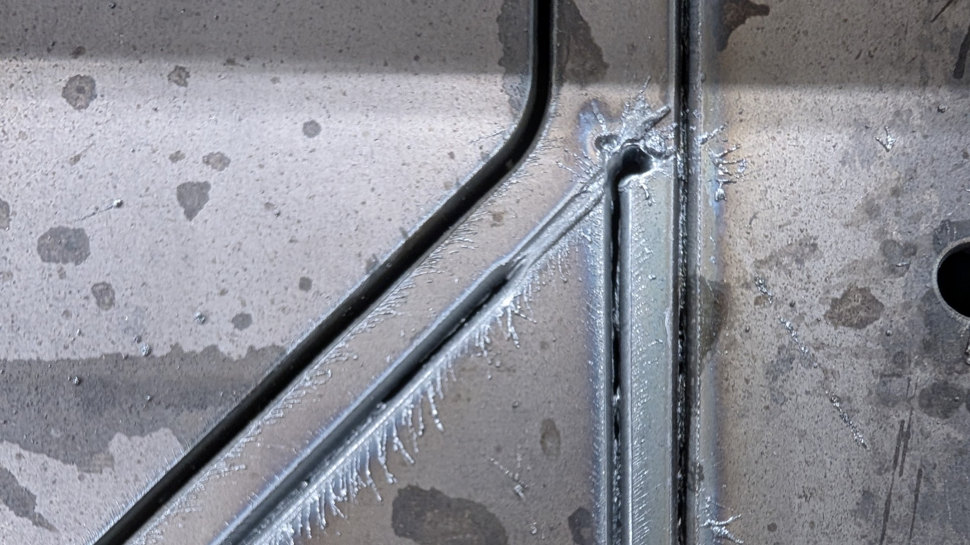

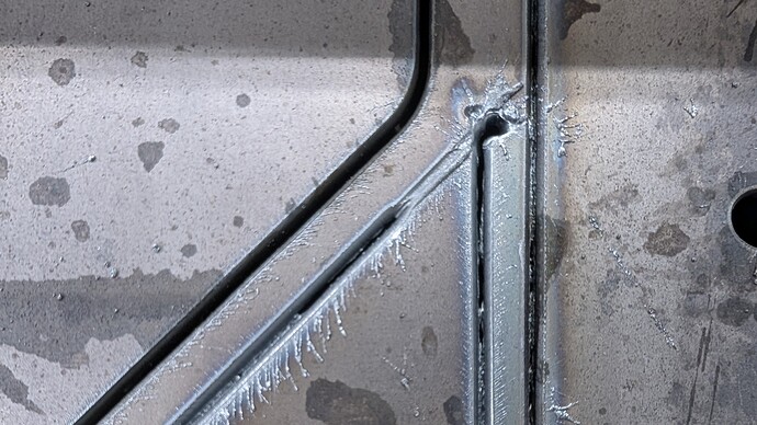

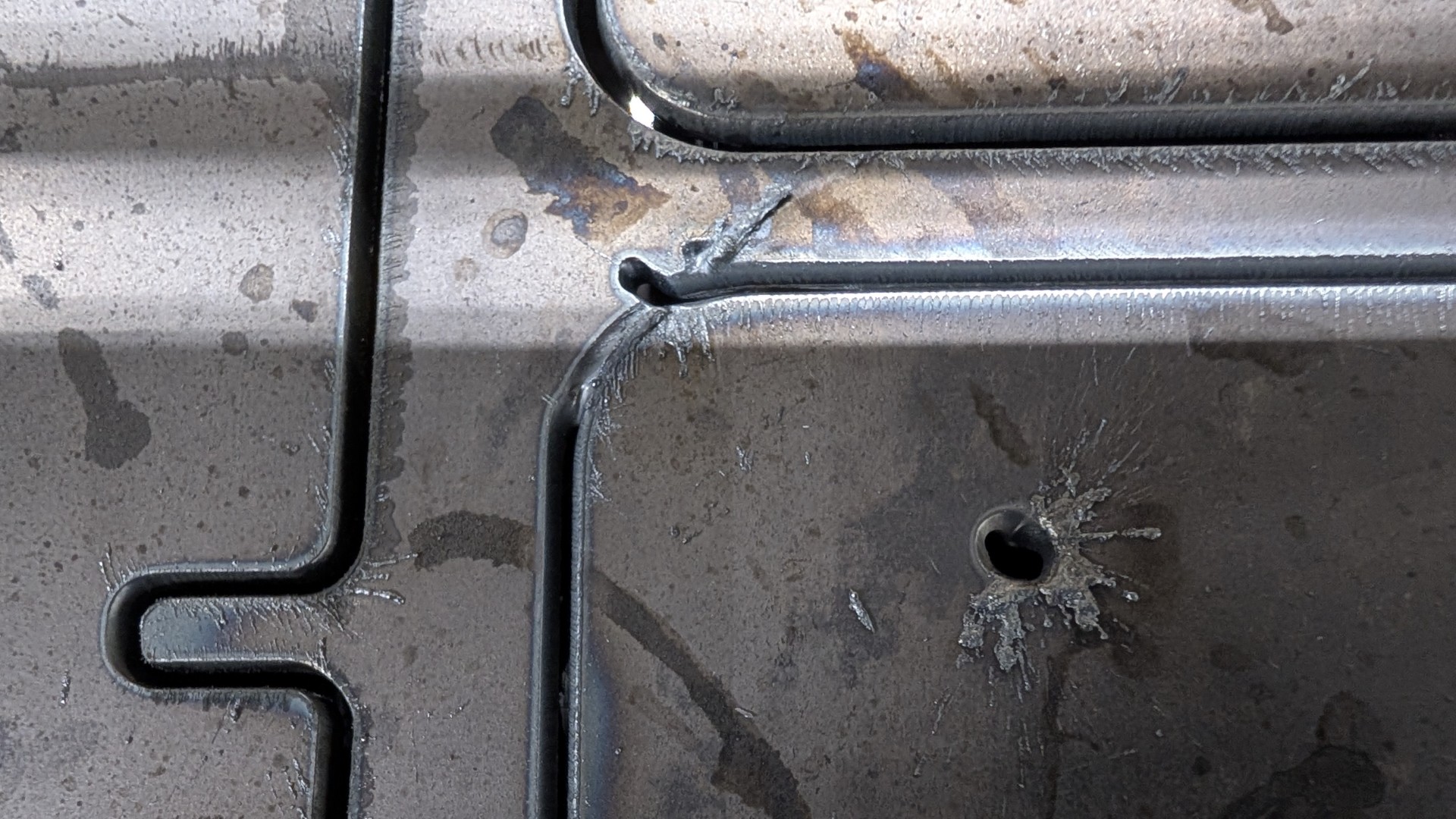

OK, the pictures tell the story for the most part. I’m running 110 ipm on 12 GA steel and the cuts (once it cuts) looks fine, but I’ve set the pierce delay from .5s, to .7, to .75, to .9 to 1 seconds to 2 seconds and the thing just takes off and starts cutting no matter what I set it at. Even on the machine itself I ran a quick straight line cut with a 1 second pierce delay and it just took off and started cutting, no delay. So it’s not the G file from SheetCam that’s the problem.
Any clues?

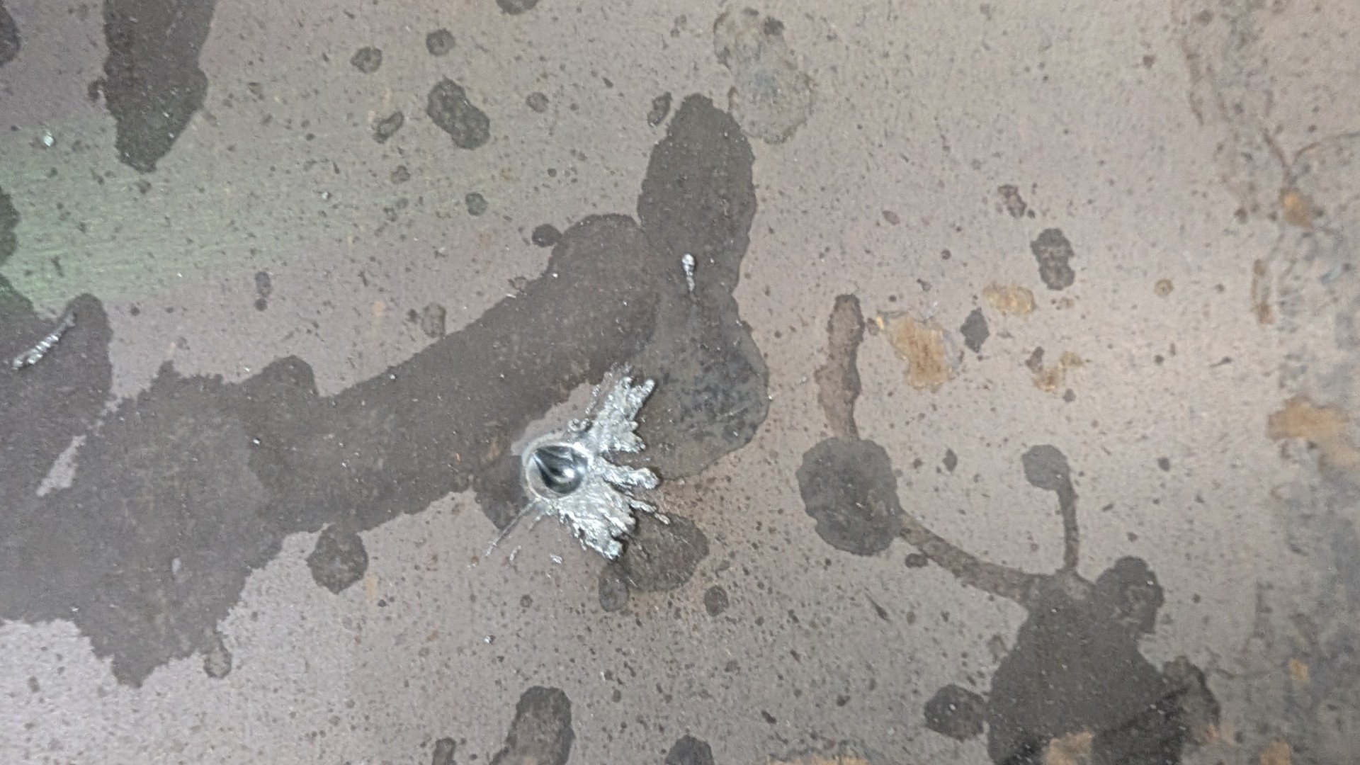

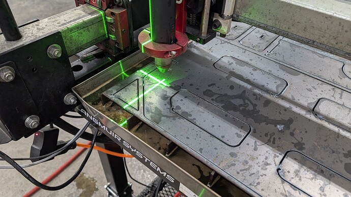

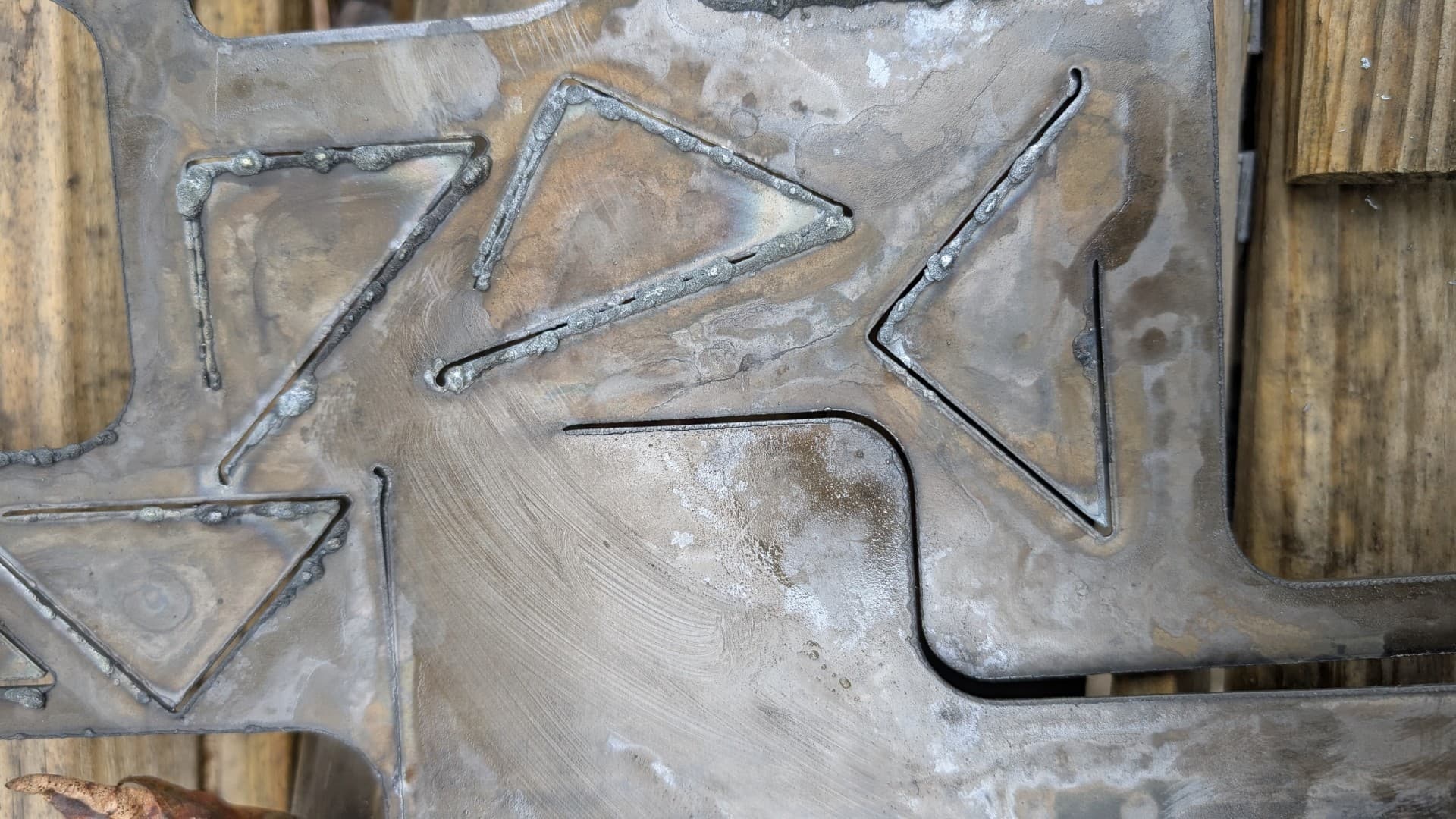

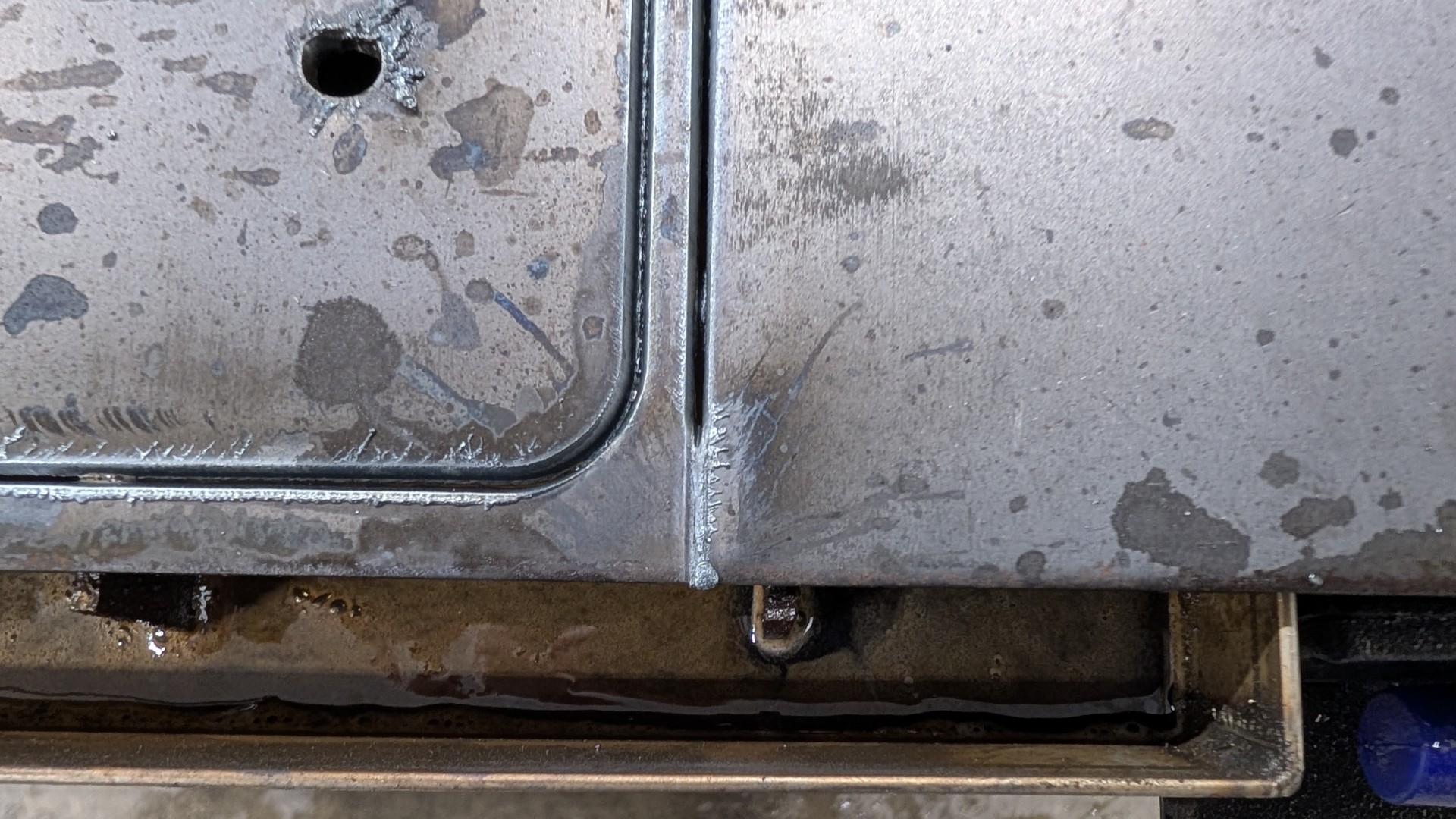

These all failed when starting the cut
The line to the right had a 1 second pierce delay set manually ON THE MACHINE, not through SheetCam

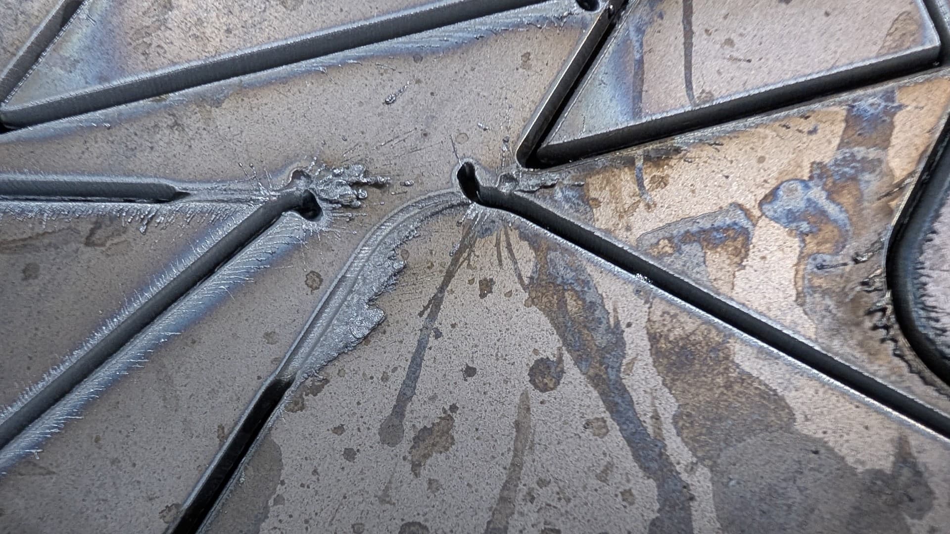

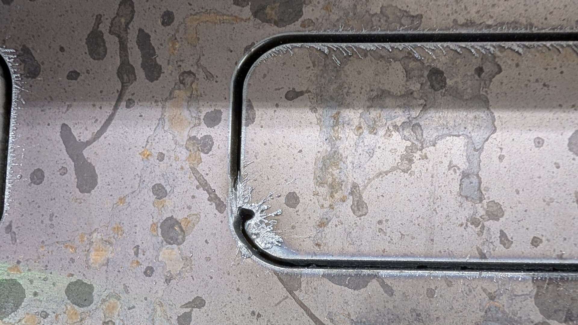

Small holes don’t stand a chance, this is what it does.
Lead In it fails to cut without a delay, cut you can see the lead out after it’s going cuts clean all the way through
Same here

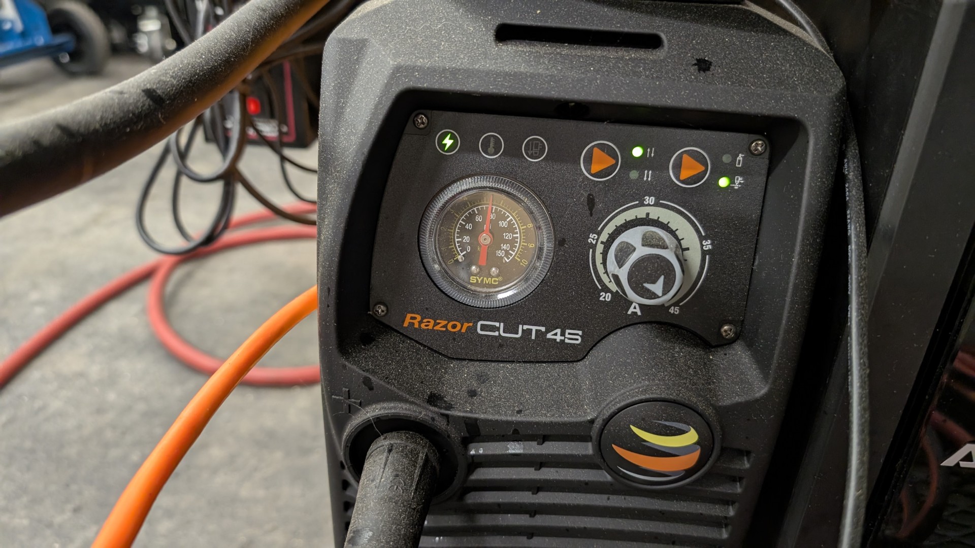

I’m maxed out at 45 amps. Air is clean and dry.

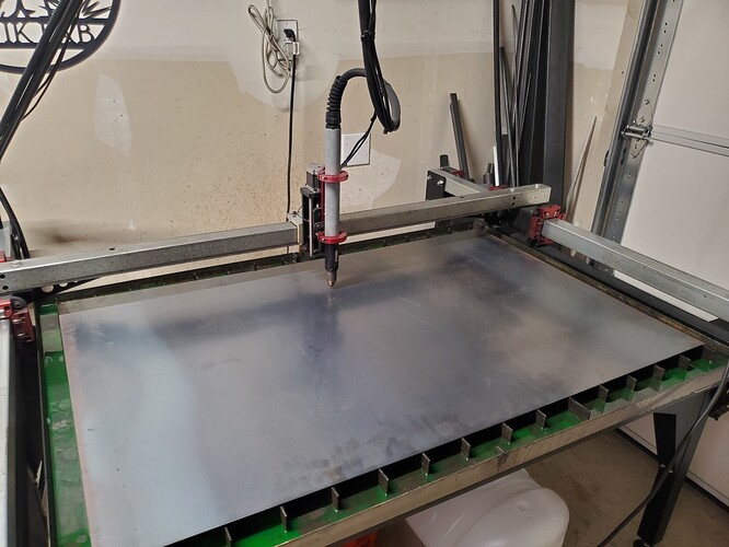

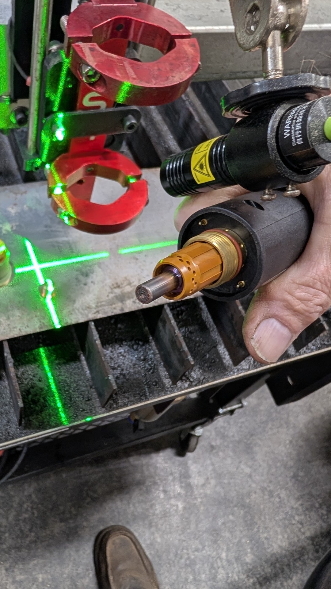

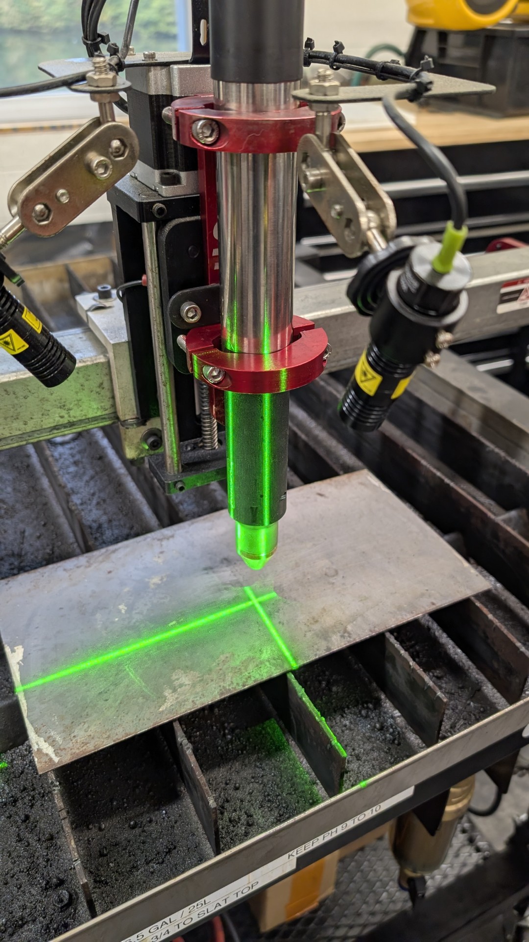

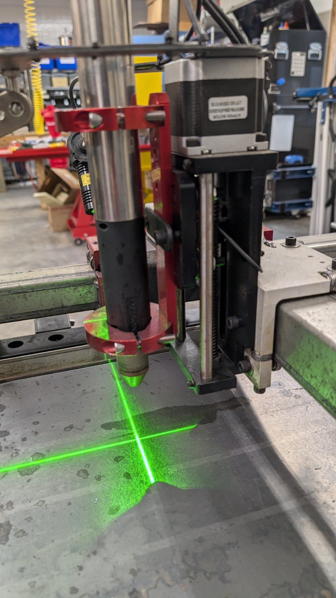

It certainly appears that you don’t have the work clamp on the metal. Plus your torch is mounted incorrectly. I would also add some water to the tray before you are starting a new thread.
My Z is all the way up here, while I could move it down some… this is how Langmuir sold it to me, I don’t see enough room to mount it any different. But I’ll look at it and call them to see what they suggest.
Loosen the screw that secures the torch holder to the Z carriage and raise it up. Then loosen the torch and slide it down so that the bottom of the bracket is above the pilot arc mechanism.
That clamp on the bottom will squeeze the pilot mechanism, causing it to missfire or not fire at all. The electrode must be able to move up and snap back into place. I do like your laser setup.
I completely overlooked the torch clamping but @Bigdaddy2166 is right in that many users have experienced issues with the torch head being clamped.
Most of these torches have moving internal components that can be damaged when clamped.
You’ll have plenty of room to adjust the torch on the holder as the holder can be moved on the Z axis assembly.
No need to contact Langmuir - the picture shown is one provided by other manufacturers themselves.
You have 3 holes on the holder, move the clamp to the inside hole and turn the holder up side down then you have plenty of room.
Super old picture but you can see the mounting setup.
Similar fashion here on my other table.
The mount can be moved up or down as needed for proper mounting.

  1. I installed the control software FRESH and now I’m getting delays again. I have no idea what setting where screwed what up and it’s possible I was playing and did something somewhere and have no idea what. But when I asked for a 5 second pause before cutting started in about a second. The less pause the more immediate it seemed to move. I’m guessing it thought 1 second was equal to about .2 seconds, so a .7 second delay was nothing to it. So I don’t know if there is a setting somewhere that calibrates timing… no idea. But now it pauses 5 seconds when I tell it 5 seconds.
  2. The torch was removed, all components checked (tell me below if you think they are ready to replace) and everything moves as it should I turned the bracket UPSIDE DOWN (thanks for that hint) and set it back up so the clamps are only on the silver part. I have less Z travel, but I can clear the work piece by about 2” when fully up, so I’m going to call that good.
  3. I double / triple checked all the spacing, I get about .125” for a pierce height when I ask for .12. When it goes to cutting I get like .065 when I tell it .06 so I might cheat both down a little in the file. When I ask for a 1” gap I get .92 inches. It looks like it is setting the torch height as it should though a tad off, it shouldn’t be a problem.

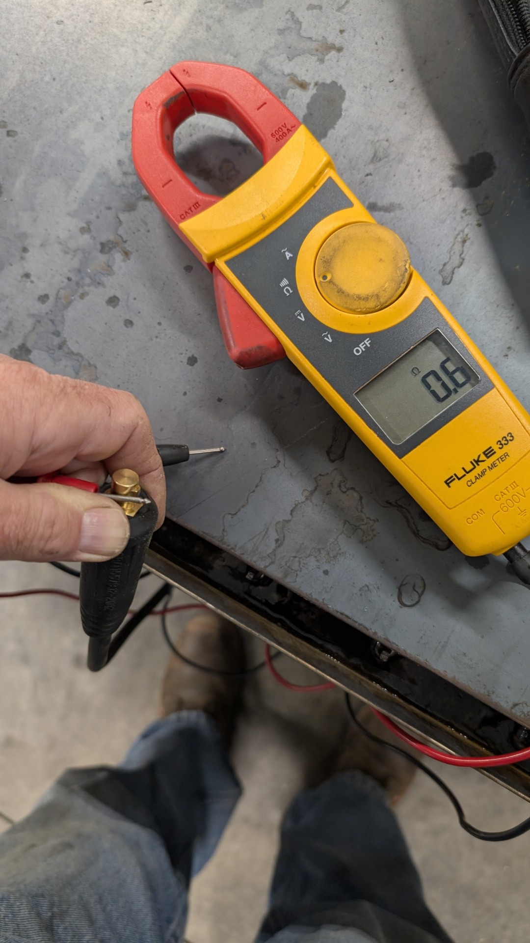

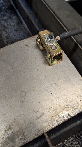

  4. Since the first thing everyone tells me is GROUND GROUND GROUND :smile: I sacrificed one of my magnetic welding clamps and made a ground “booster” to make SURE it is grounded.
I have not run it yet, but hopeful this has sorted everything out.
Images below for those that like eye candy.
Clamps only on the silver part of the torch.
My magnetic “booster” clamp. The table is grounded and the cable on this runs to that cable directly.
I checked with and without the booster clamp and see less than 1 ohm all the way back to the input for the cutter.

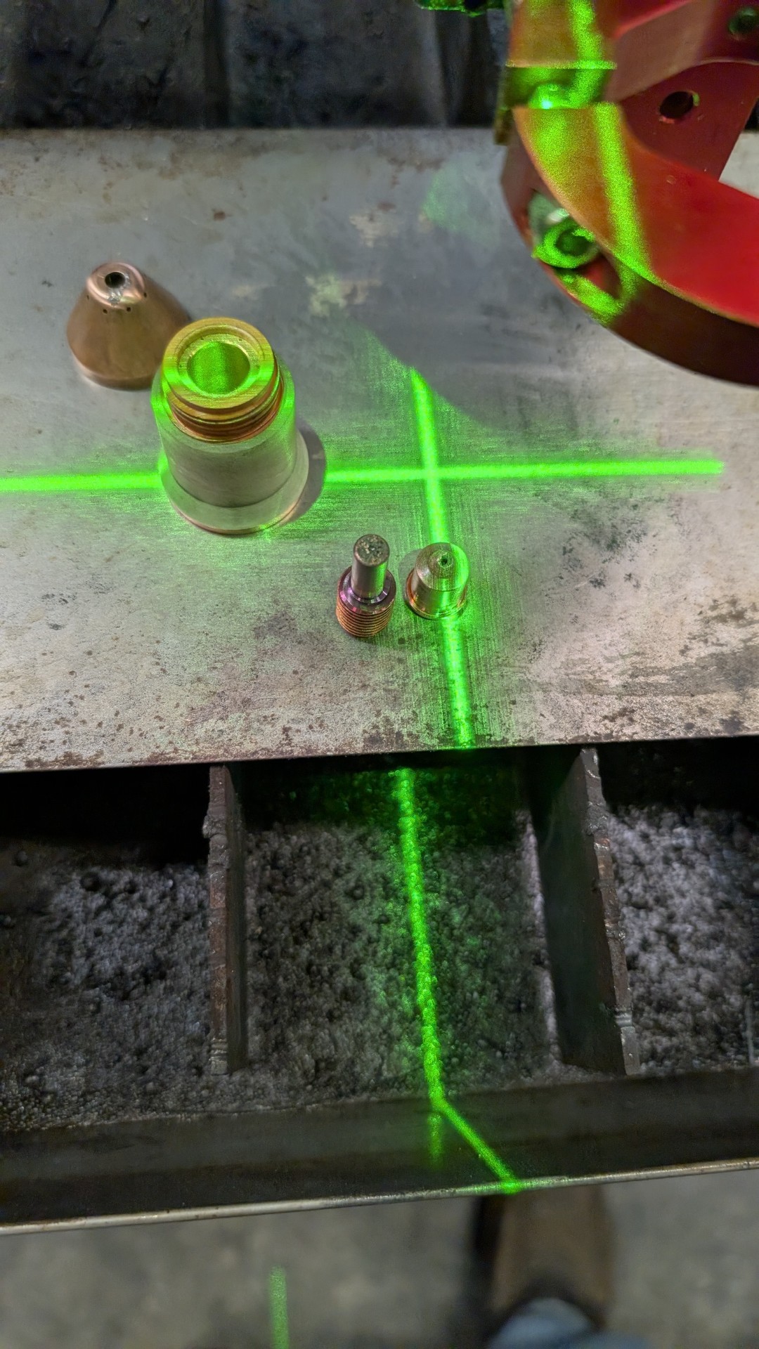

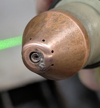

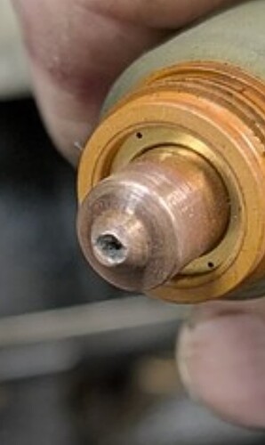

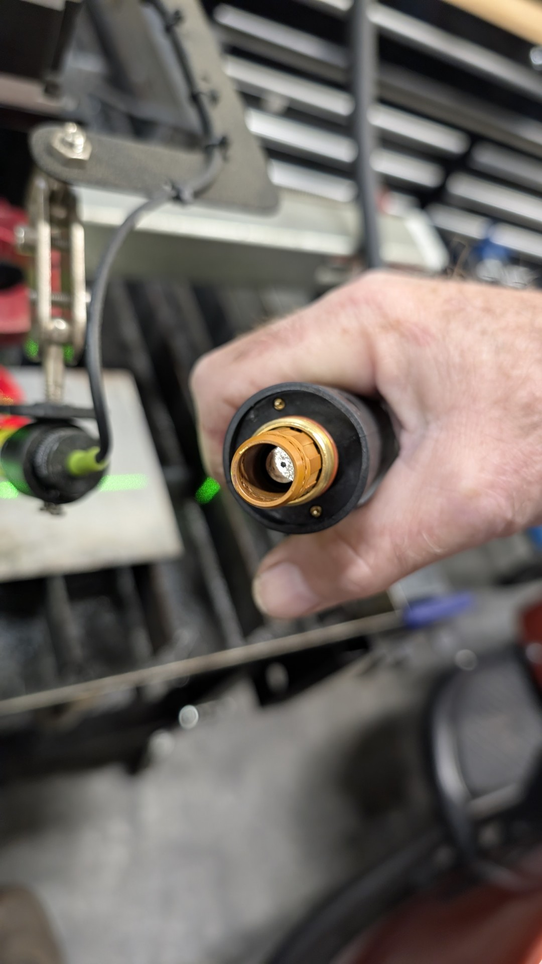

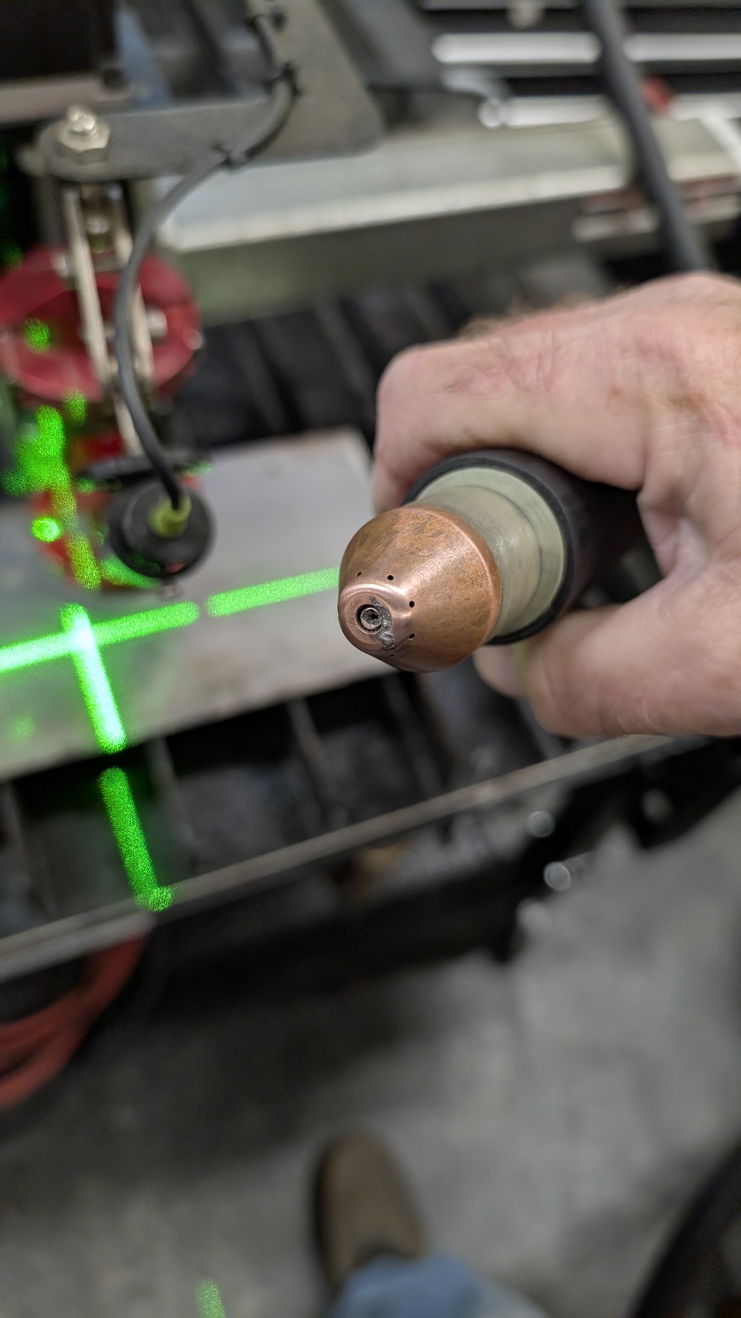

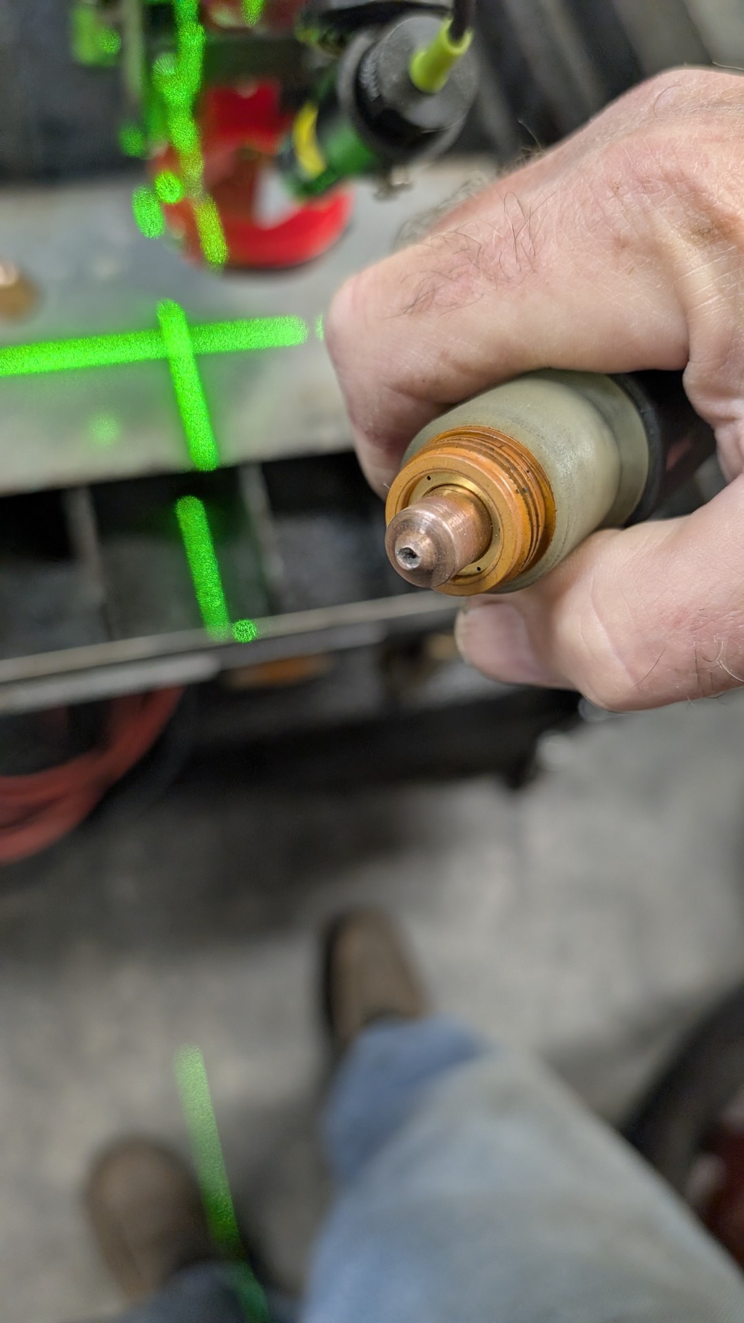

I’ll be honest, I don’t know if these are good or not. The seem OK but I did pick up a bit of splatter this last time cutting so I should probably replace at least the tip.
That nozzle is tortured. That will not work.
And you have some significant scarring/dented on the shield and the nozzle is no longer centered. Looks like this torch was dropped on its nose. That needs to be replaced.
I would replace the electrode, just because.
George can get you some good consumables: @mechanic416 (He is very well trusted and knows his stuff)

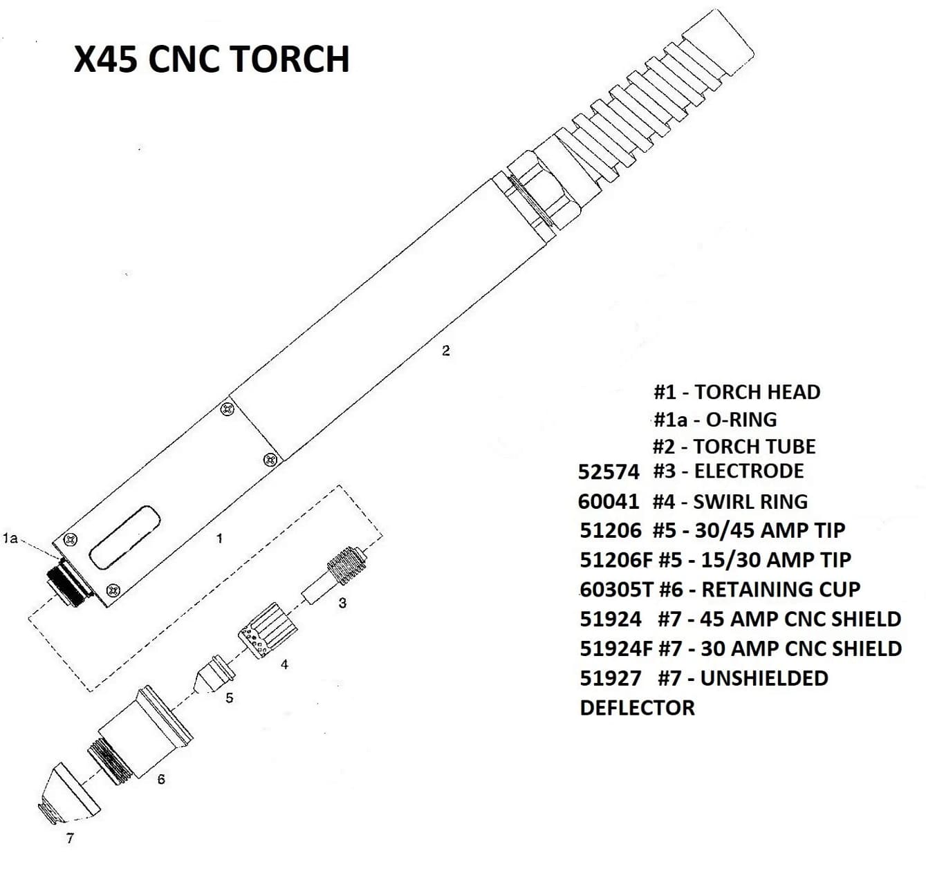

So you’d replace 7, 5 and 3 in this image?
That nozzle was toast long ago.
The electrode from the picture looks not terrible.
Normally the nozzle and electrode are replaced as a set.
And then replace any other worn components as needed.

Definitely. Ordinarily that shield will last a long time but if it gets physical damage, it will alter the air flow. For me, the nozzles (#5) wear the quickest.
But yes, as Tin says
Your nozzle died long ago.
Here’s a set with +1,000 pierces that I consider bad/used up and they look much better.
If you’re new to all of this, you need to periodically check your consumables. Maybe every 100 pierces or so, pull them off and inspect them.
Once they’re about worn, make a note of how many pierces that set had and then replace them.
Around 100 pierces or so before the first set wore out, check your consumables again and see if they’re tracking around the same number of pierces or not.
You’ll do this several times until you figure out an average, this way you’ll know when to replace them when you get close to that pierce count.

Oh and, it’s a work clamp not ground :wink:
