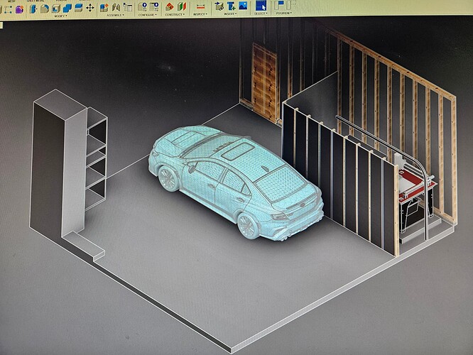

I saw someone else asked this but didnt get any replies, is anyone able to confirm noise levels during “normal” operations? Im meaning cutting aluminum or plastics.
I asked Jake over email and he said 70dB typical, 90dB worst case and i want to confirm or correst this.
My plans have changed to where noise is now a concern, and i need to be able to mitigate 100% of the sound coming off of it.
Im already planning on getting the enclosure, and am thinking about anti vibration pads under feet, rock wool insulation in my garage, and hell - even buulding a mini room around the mill.
Any help is appreciated.

Thanks again for the input all, heres a mockup of what im working with, but the orientation of the mr1 isnt quite right.
Right now im noodling isolation pads under the feet versus an “island” of an aluminum/wood/sand/concrete to help dampen noise and vibration.
You may want to look at https://www.footmastercasters.com/. They have leveling casters with a rubber foot that lowers. I bought some for my custom frame that I built for mine. They have a number of models to pick from. I got these. You can also find them on Amazon.
I wouldn’t want walls on 3 sides of my MR1. I considered this in my own build since there is a niche like that in my basement, but I find myself using side access fairly often. Your design would be equivalent to not being able to remove the side panels or rear around to the back panel.
My machine is up against a wall (pulled out 4-6" so that I can reach behind for cabling purposes) but I have about 2’ of clearance on both sides (on the left side there is a roll-away cart that normally lives there).
What is the goal of making the walls?
