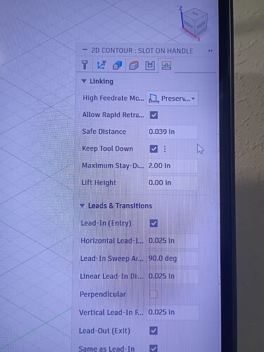

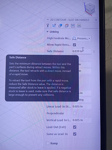

This is what i use in fusion 360, assuming im following you correctly.
Thanks for that. I think there are a couple of ways to drive the z-up-first behavior in an individual post file, but I’d like to have it be a default that just always happens.
