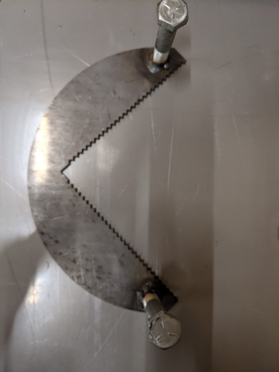

I run librecad for brackets and such. I’ve been using it for a while on the CNC mill. It is a little odd to learn, but once you figure it out (via youtube) it is pretty decent and can do CAD stuff pretty well. I did a push-stick for my bandsaw and once I had the software figured out I could redraw the bracket in 15 minutes. Note the ultra high end bolt handles…
I had this laser cut from sendcutsend, It was around $30 in 1/4 inch (versus $300 from doall).
