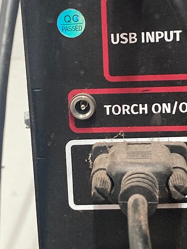

Is there a way to buy a new cable for the torch height controll? I sent them a msg but it’s the weekend so it will be a few days before i get a response. I tripped on the cord and the end broke off where it plugs into the back of the control box, surely amazon has one ,what’s it called though?? its plugs into the torch on off slot and the other end into the plasma cutter…….thanks

It is called a Barrel Connector, 5.5mm is standard, but there are two variants, 2.1 and 2.5mm pin. You can get plugs that match either, but, 2.1mm works in this case.
if it’s the on off when you’re talking about just above that I believe it’s a 12V DC 2.1mm sytle Connector
Sounds great thanks, Amazon had it and I will have it tomorrow!! Thank you for the info!!
