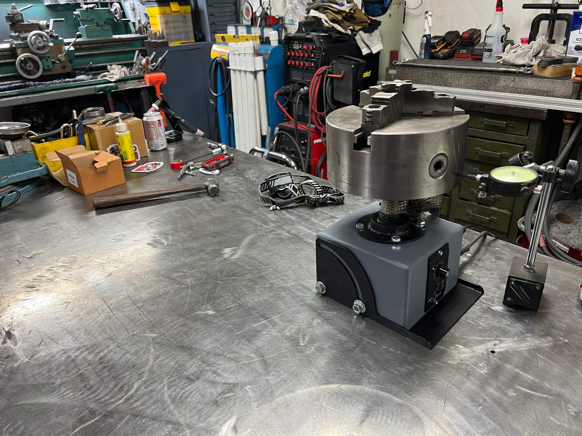

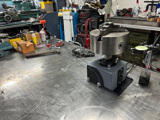

New tool made on my table kinda
Well i decided to build a turn table on my Crossfire Pro. What would i do differently?
The size of the box is 6x6 i would increase to 8x8 the sides were sliced so it could be hand bent not the easiest way. It would of been easier for me cut all the plates and tig instead of mig the job would be nicer and save time.
Right now, the speed 1 rpm in 75 sec might have to slow down a little? Run out .003 good enough for me and works.
Look at that monster! Nice job on the machine and the grounding strap.
Very nice!

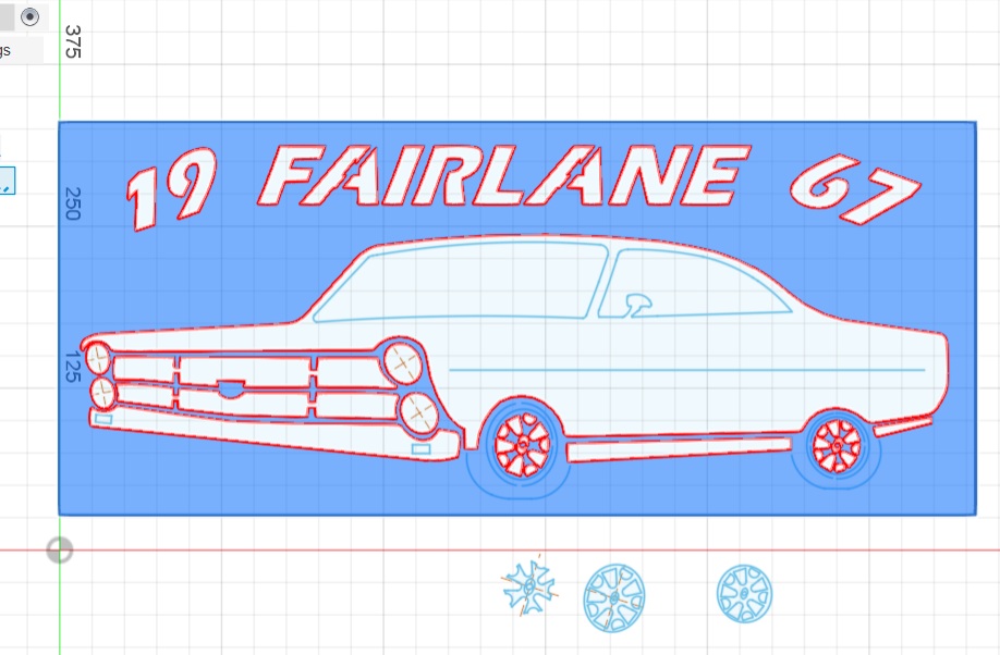

BTW is that a Ford Fairlane in the background? Just curious because I have a sketch I’ve been working on of a Fairlane. I’d be about ready to share it with you. I have a friend whose doing a total resto on a 67.
