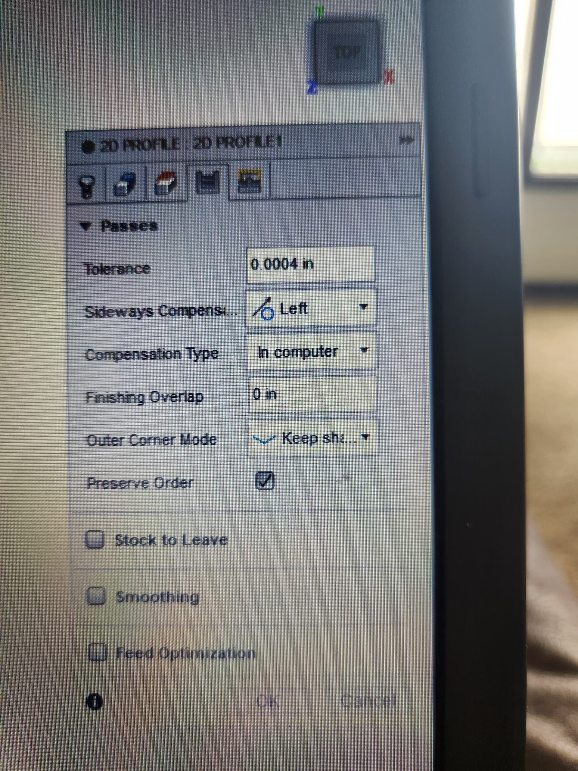

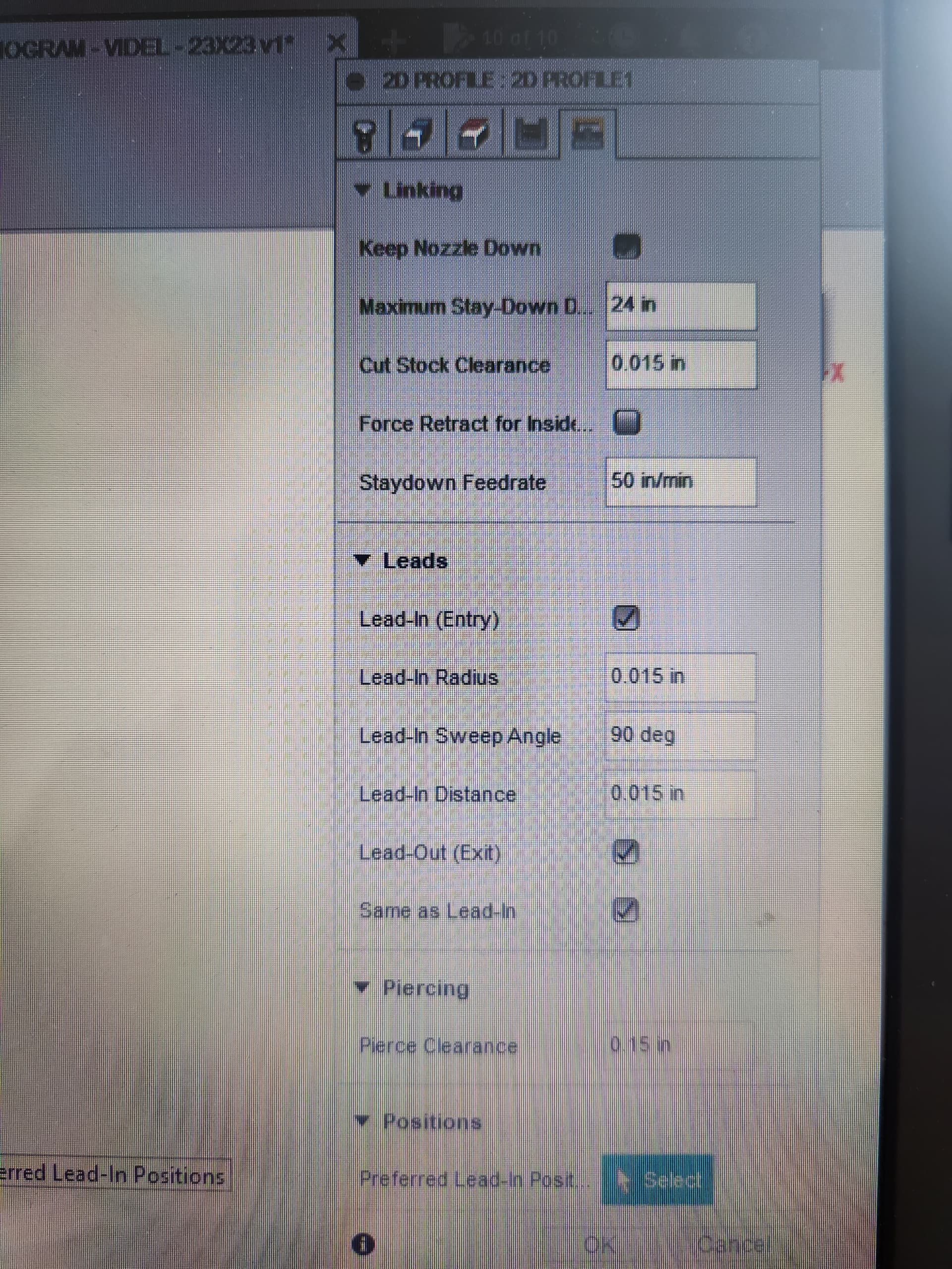

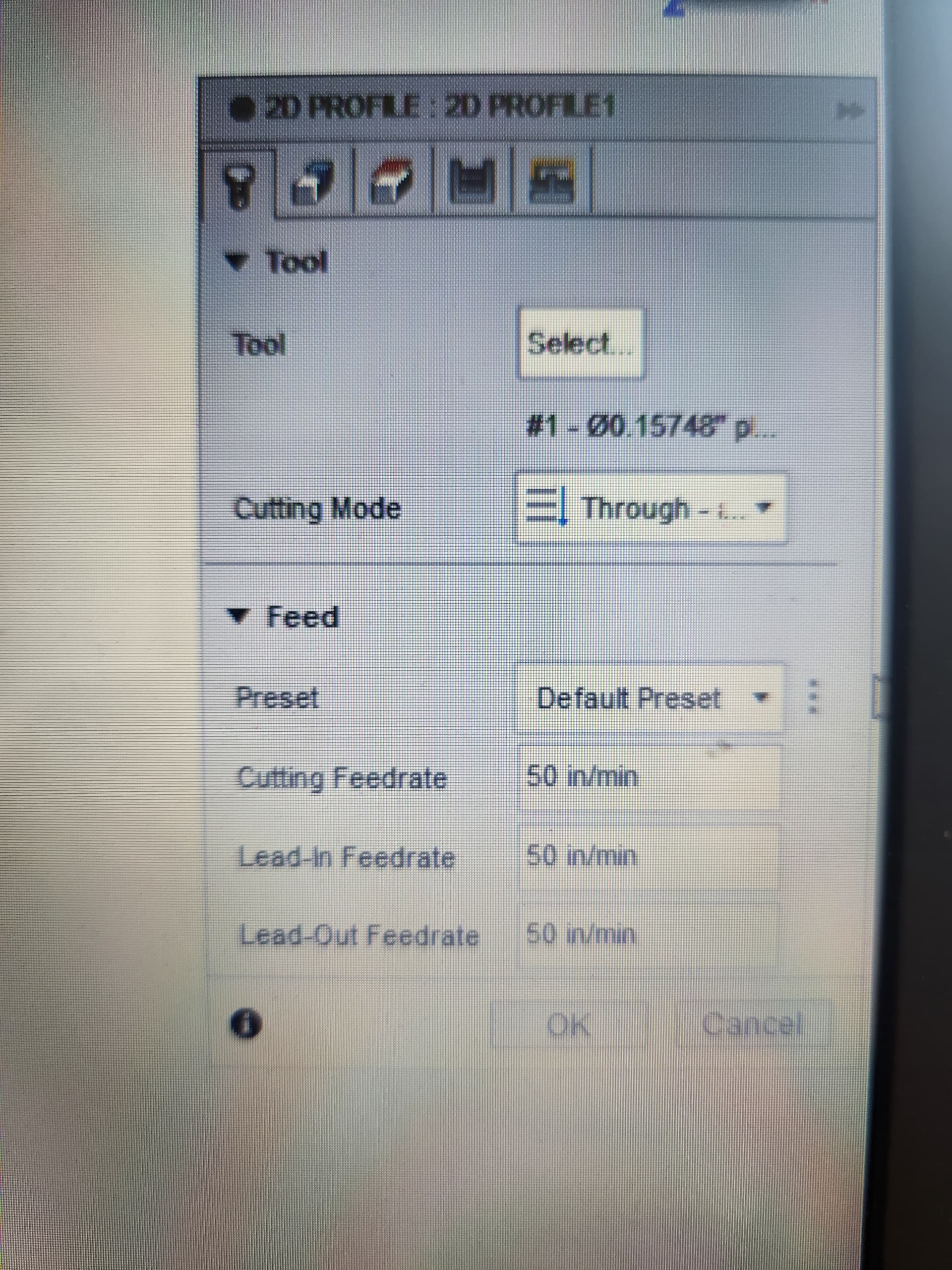

New Issues Creating Toolpath on F360
Loads right up for me. You have several open section that need to be addressed.
Go back to design and blow up your drawing to see the 10 + open sections.
You can download “sketch checker” from Fusions website. It’s free. It will tell you if you have any open or non connected lines.
Is it cutting the all the letters around outer edge?
Fix the open lines and you will be in business.
I cannot find any open lines on my end…
Where are they showing on your end? I have ran fill gaps sketch checker and connect the dots to no avail…
Let me do a quick video so you can see how i do it. Just FYI…i don’t have THC which shouldn’t change getting toolpath. give me few minutes
Go back to the original drawing and hit edit sketch. Blow up the drawing right under the two letter s on the top. That one shape that looks like an iron has several lines not connected. Once you zoom in you will see them. Do the whole sketch. I count 10.
