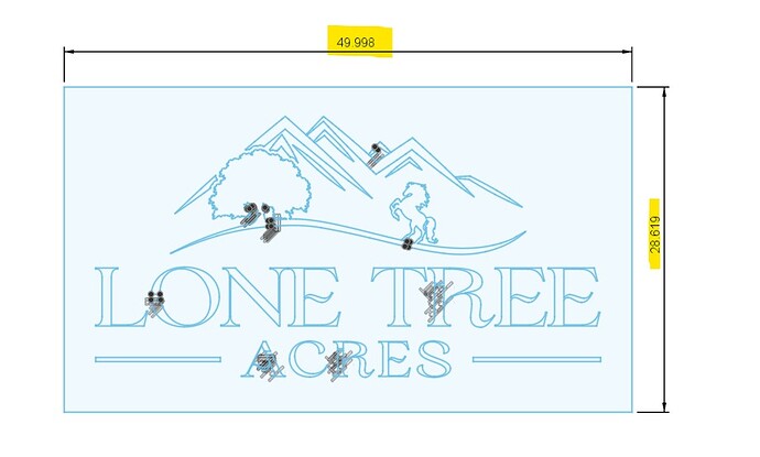

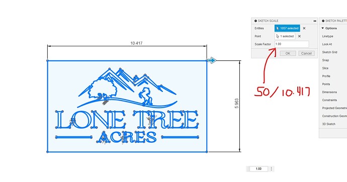

Not sure if you did this to make your original measure 50" but super easy to get things the size you want them.
