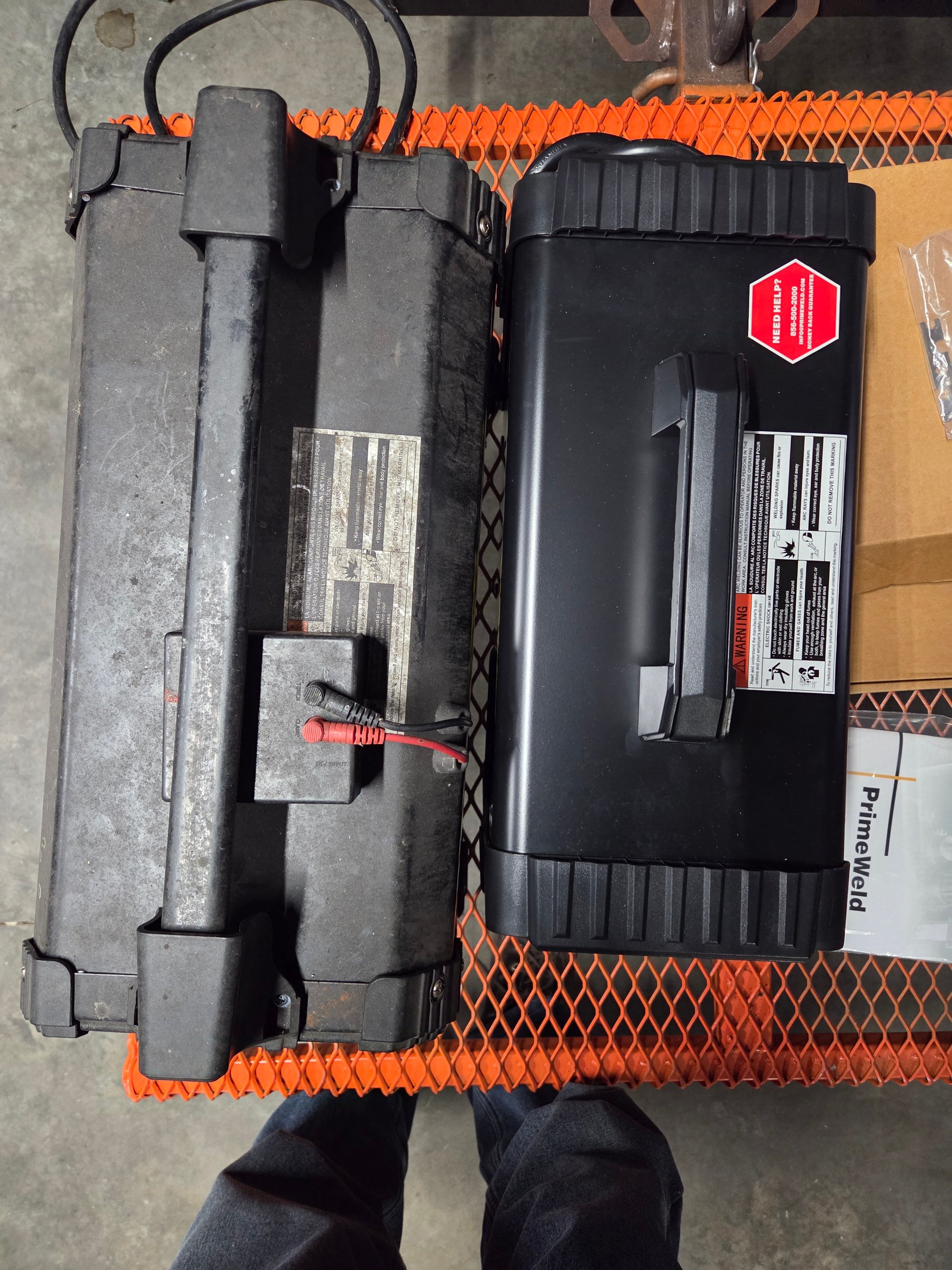

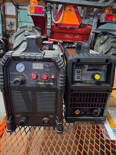

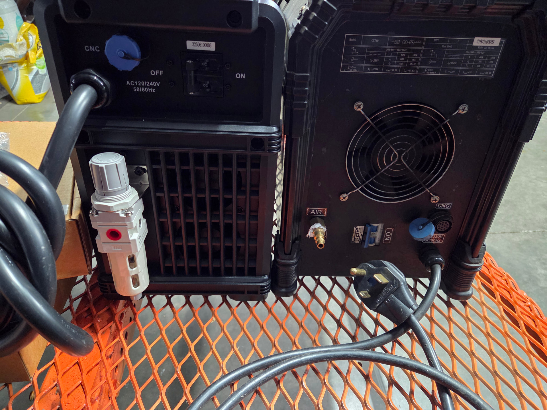

Since there was a request in this thread for a comparison between early and new gen, I’ll add a few pics:
this view is a bit deceptive because the external regulator adds to the overall footprint of the new model to the point they are almost equal in effective depth;
new has the external regulator and obviously larger voltage supply plug wire gauge and/or shielding;

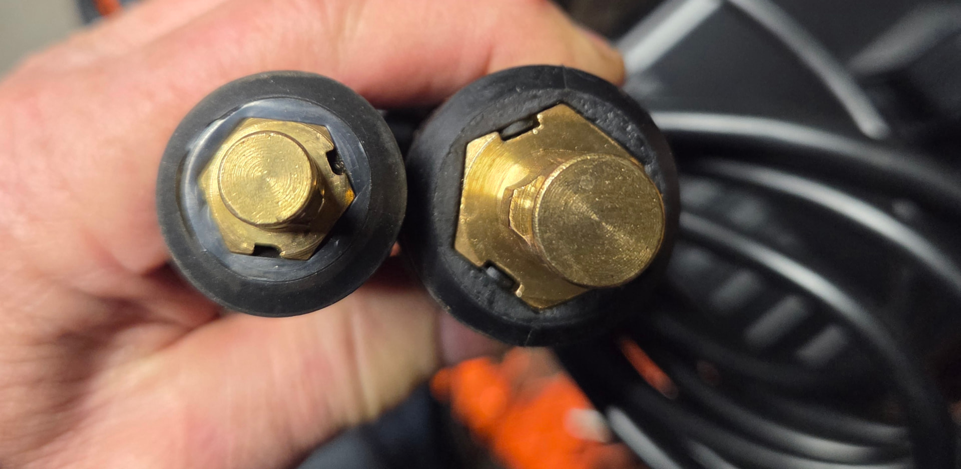

Work Clamp: new is much larger diameter.

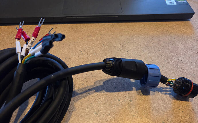

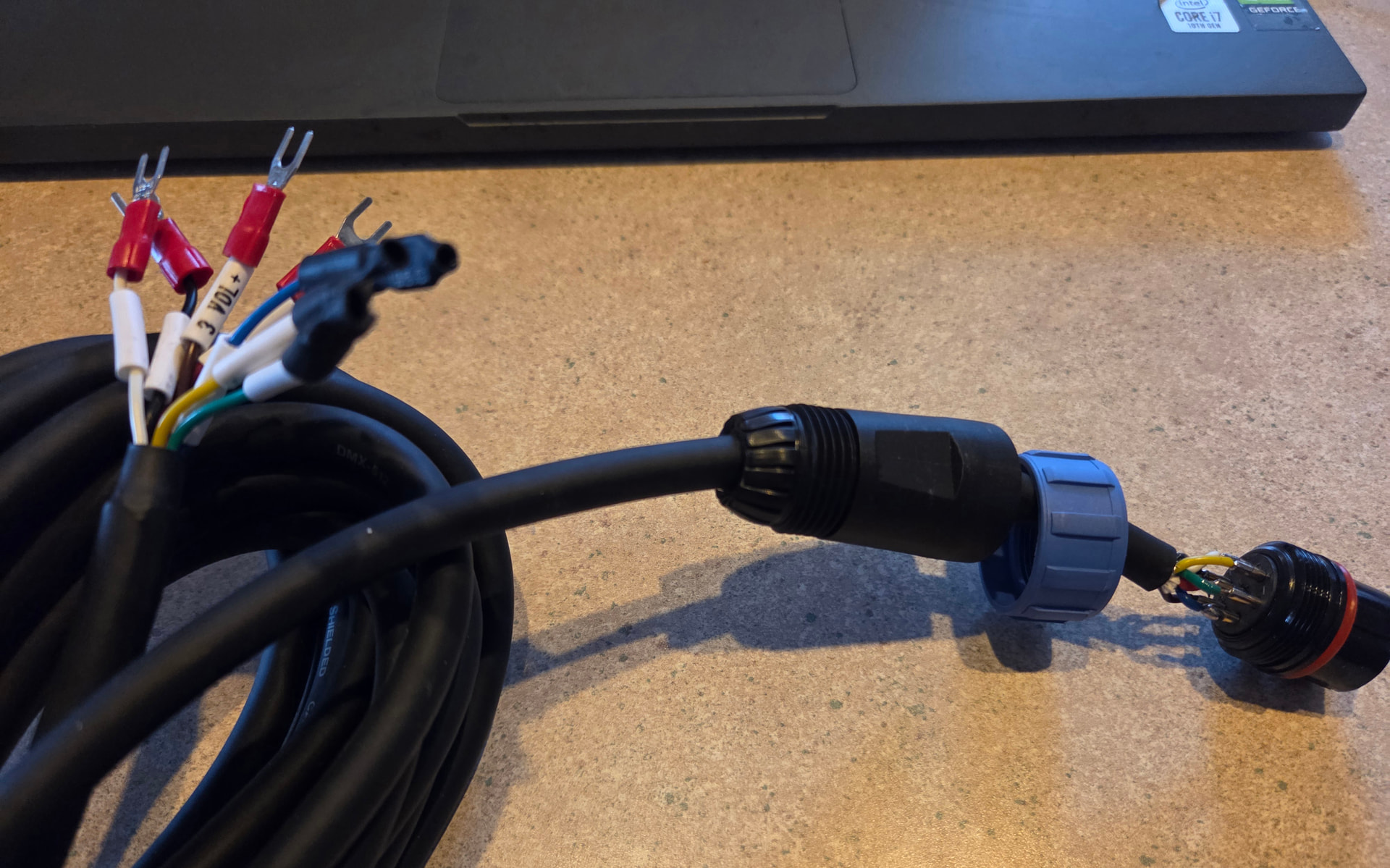

The new CNC cable connector end actually has fewer pins. I am guessing the original was an off the shelf that was used even though there were pins that had no use even if you used did not wire up raw voltage.
Since PW says no need for raw voltage on this model, I am leaning towards at least initially hooking it up using their divided voltage board. Hey, 36 month no questions warranty, right? @bLouChipBlacksmith didn’t mention using raw and seemed to have success, so I am inclined to at least give it a try.

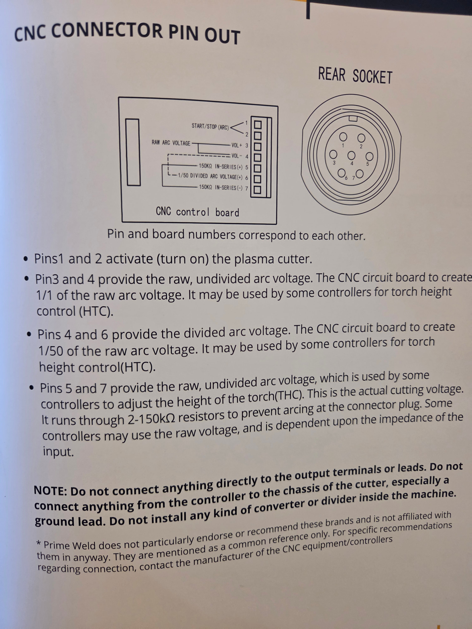

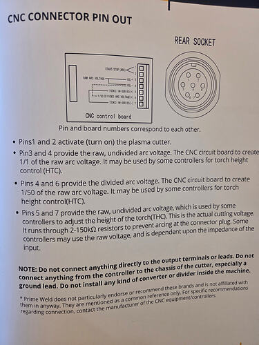

I got a hardcopy that is definitely updated. But, Tin is correct: that pdf offering on the website is NOT the new version. I checked both the pin out and machine layout drawings and they are outdated.
They did improve the new manual some since gen 1. Here a a few of the critical pages:

They removed the “Arc Ok” pins from the cpc port?
Unfortunately that is correct. I called PW a couple of weeks ago to inquire if the circuit was still available to tap the signal from inside the unit, unfortunately no.
But it just occurred to me that an externally applied Hall Effect amp clamp type sensor could be applied to (around) the work lead to obtain the same signal. Easier said than done of course. A quick search on amazon of “hall effect DC amp clamp sensor” yields several options, the more industrial component(s) at $70 or so by the time you include a relay to serve as the normally open contacts most controllers use as input.
A roll-your-own toroidal core and PNP hall effect sensor may do the trick also, we are sensing for current flow of > 10-15A DC for gosh sakes. My guess is @TomWS may be able to fab one up as a test case from his spare parts :wink: I would but I don’t have the parts, yet.
As far as I know, no controller uses the Arc Ok signal, consequently it should have no impact to your system. As @bLouChipBlacksmith describes it is easy to ADD a circuit that would provide such a signal but what’s the point? :thinking:
