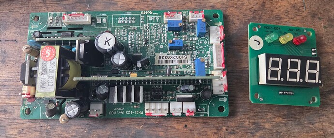

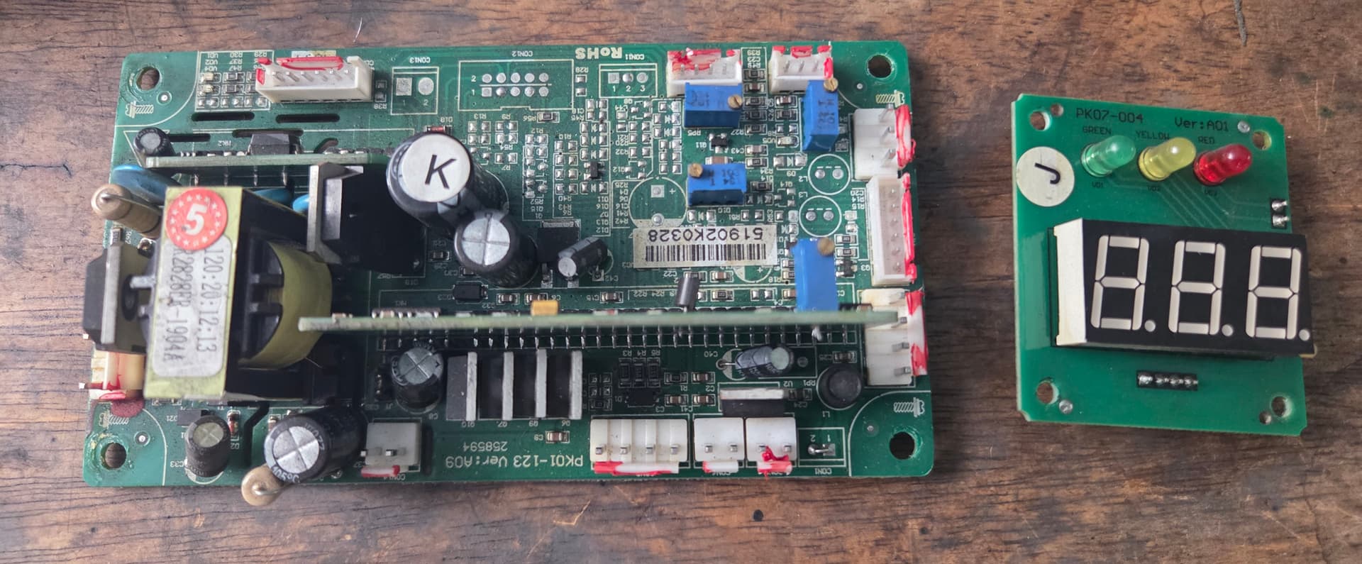

Return call he said the advise was to replace the display and the “upper control board”. He said I could either ship it back at my expense and they would do the parts/labor for free, or they’d send me the parts and I could do it. I said send me the parts and if it’s beyond me, I’ll send the cutter and the parts back to them.

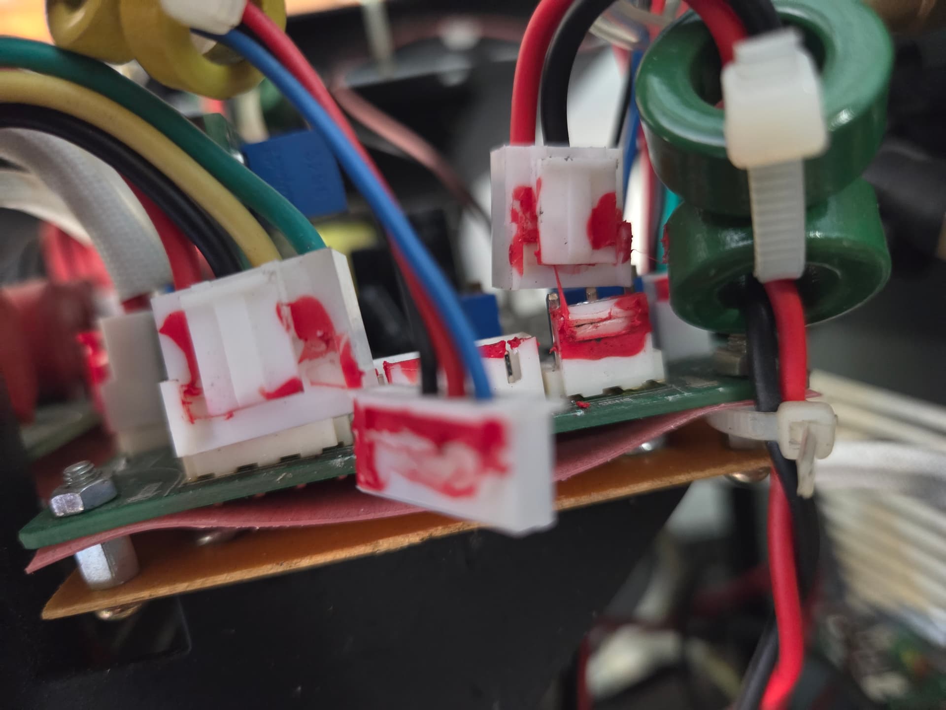

Got them installed this afternoon. Fixed the issue. Other than getting the wire harness connectors unplugged (adhesive was used originally) the job was pretty straight forward.
These are the boards that were replaced.

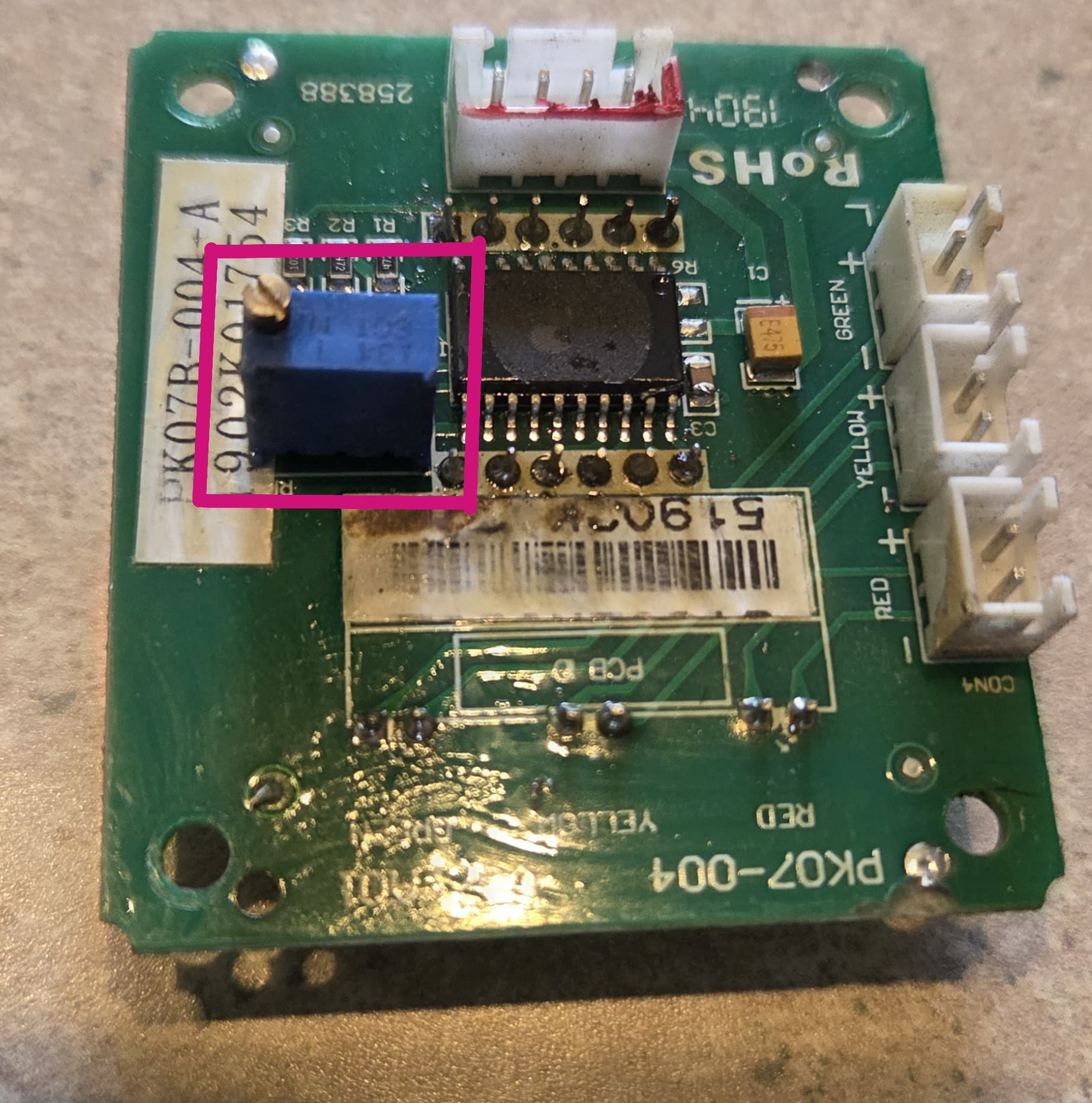

I forgot to mention above, that the new display board needed to be calibrated to my machine. They never mentioned it when talking on phone, so maybe not always necessary.
Before I re-assembled my cabinet, I plugged in the cutter to make sure the repair had worked. The display read from 24 - 70 amps. There is an adjustment on the board. I set dial to the low amp end and adjusted to 20 amps first. Amazingly it hit 60 on the nose when I went up.
