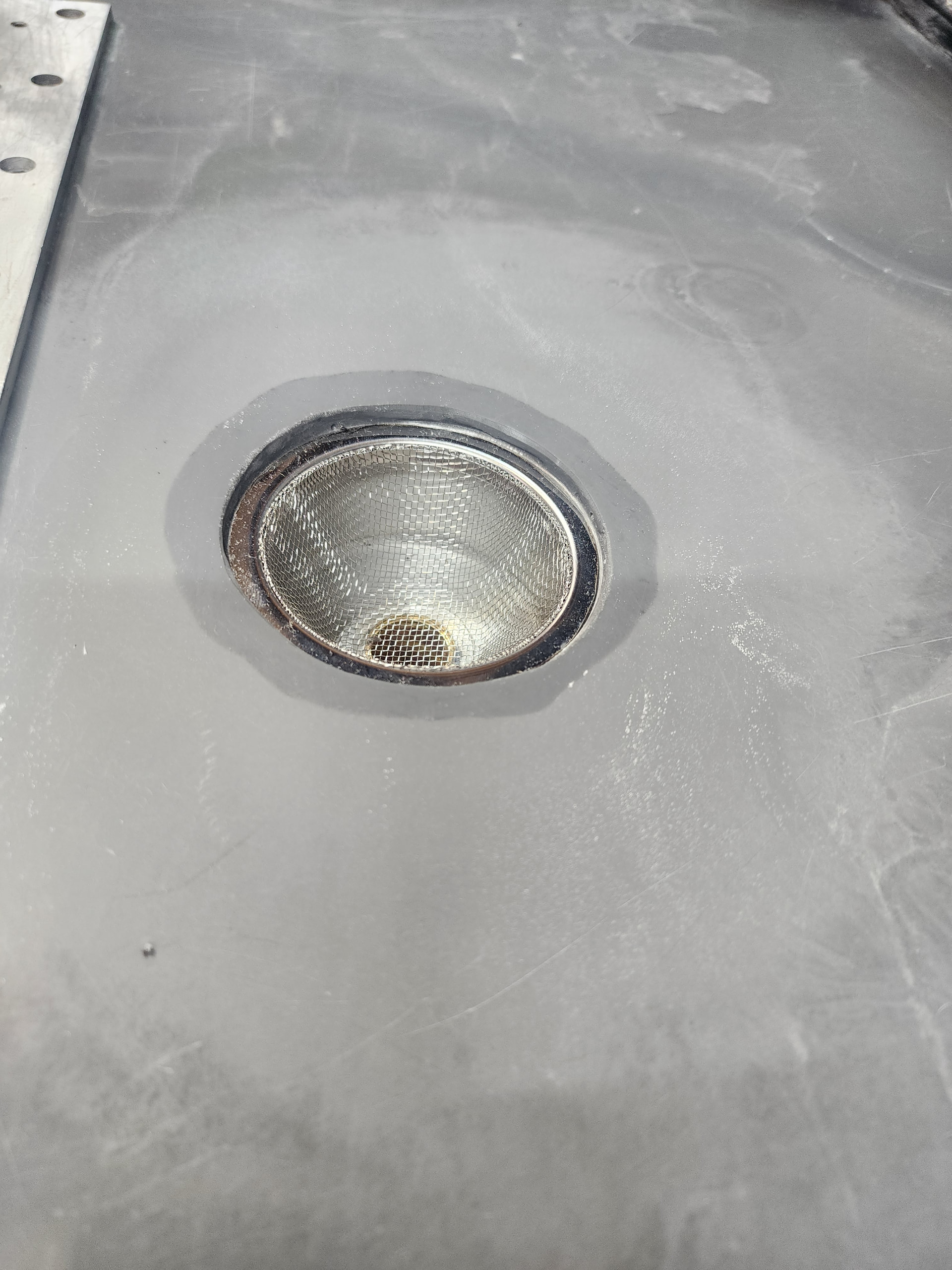

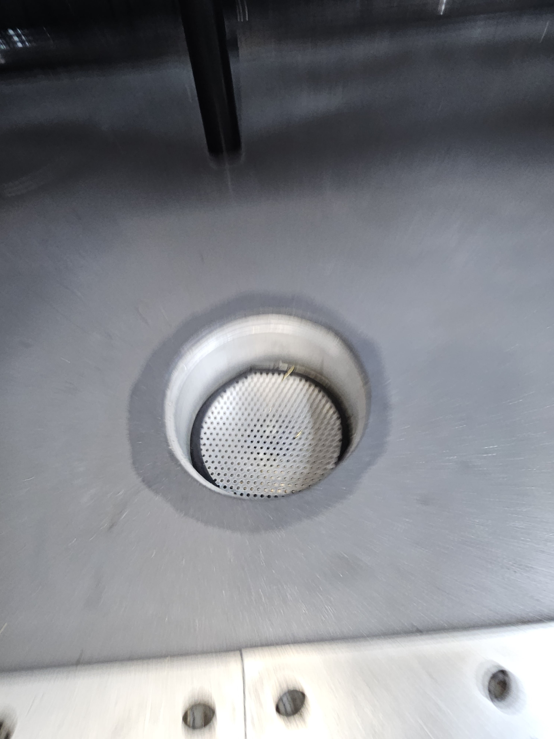

This is what I did. It works perfectly. 4-inch aluminum conduit with a bottom plate that has a 1-inch bulkhead fitting through the bottom. You will need to be able to heliarc weld it together. I have zero issues. The 1-inch hose drains directly into the coolant sump

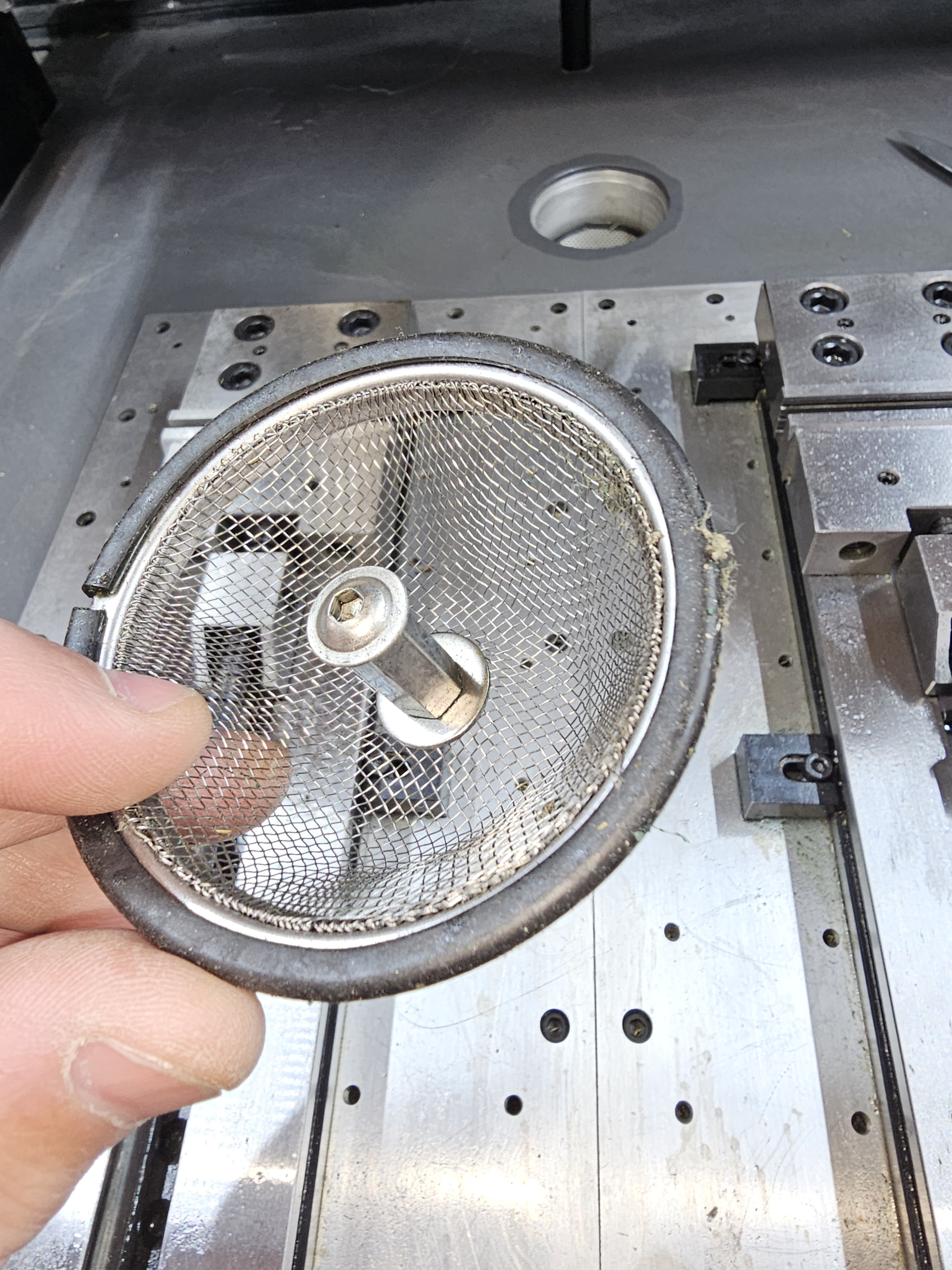

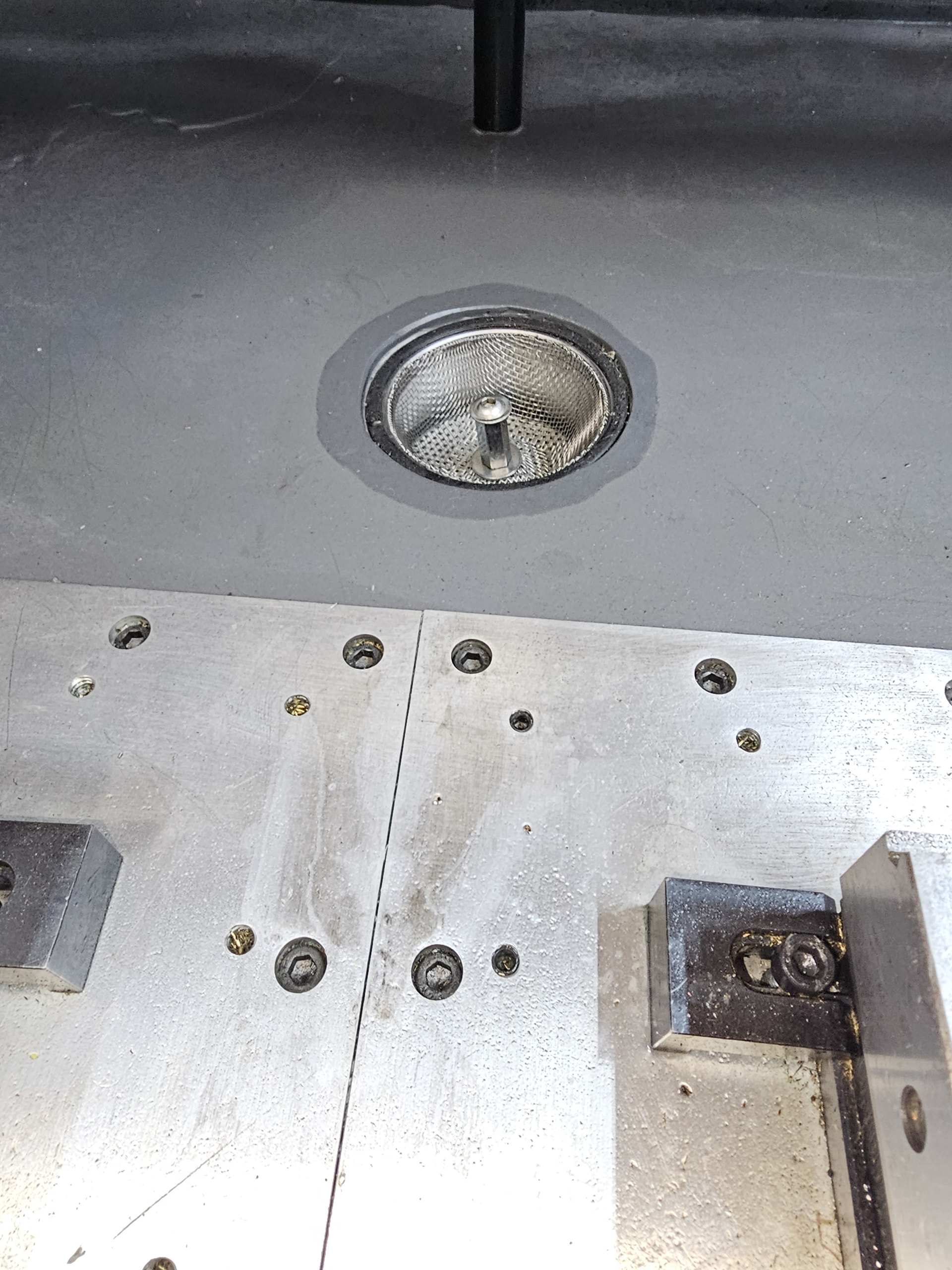

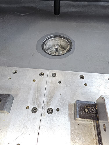

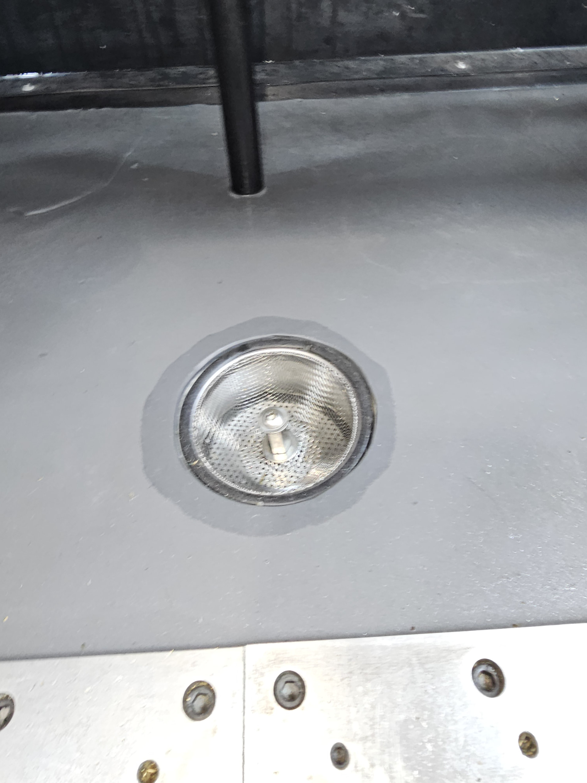

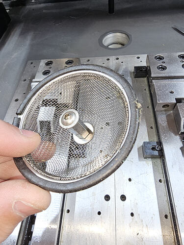

My machine was the first one, so the four corner drains are still in place. I made the screens from a sink drain kit from the grocery store.
