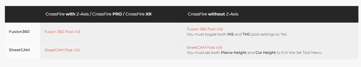

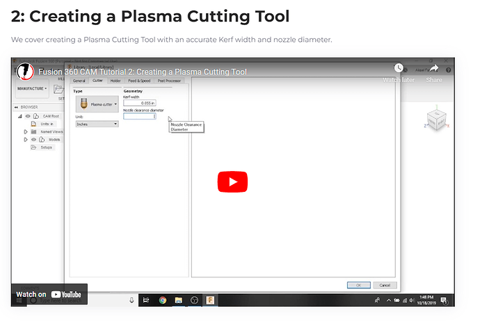

I understand. The part that really trips people up in Fusion 360 and SheetCAM the first time is that you do have to set some things up such as “tools” and the “post processor” file.
The post processor file is what Fusion 360 and SheetCAM need to make the g-code. The g-code from SheetCAM will be a xxx.tap file and from Fusion 360 will be xxx.nc. They are both simple g-code files that FireControl understands. It is basic instructions for moving the gantry and torch and turning torch on/off.
So it is good to have the post processor file loaded somewhere on your computer (where you can find it) and understand how to enter some simple details of the tool (torch cutting specifics for a specific metal type and thickness).
The post processor file is downloaded from here:
https://www.langmuirsystems.com/downloads
For the tool entry in Fusion, you would want to watch this video:
https://www.langmuirsystems.com/software/fusion
Now you are ready to take your file into manufacturing.
I’m newish as well and the videos Jim has linked above are great to watch each one from start to finish and follow along and it will show you how to create a simple bottle opener and turn it into G-code.
There is some settings in fusion that need to be setup or you will run into issue but the videos walk you through very well.

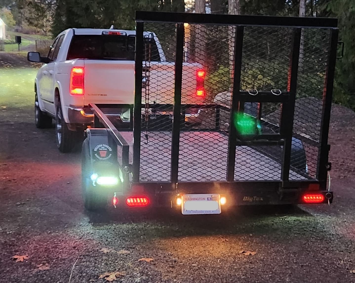

I wanted better lights for backing with my trailer. 3D boxes would be the answer:
2Rendered Light box
Unless you are making flat signs or support gussets/brackets you are probably interacting with a 3D object. So whether it is solid or sheet metal, the 3D world is where the fun begins.
