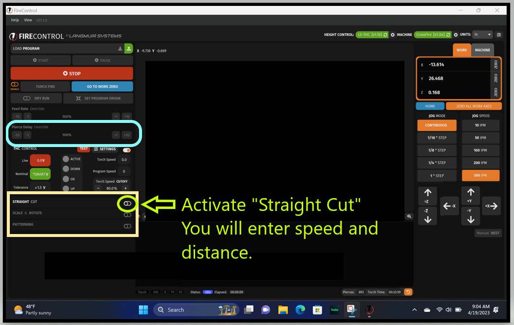

Just got my table set up.how can i do a test cut now without making a whole file…
Use the straight cut feature on Fire Control.
@ChelanJim
Posted this nice image of where to activate your straight cut feature. Just enter a distance, speed (from your cut chart) and pierce delay (again, depends on thickness, but try 0.7 seconds if say 1/8" or less)
