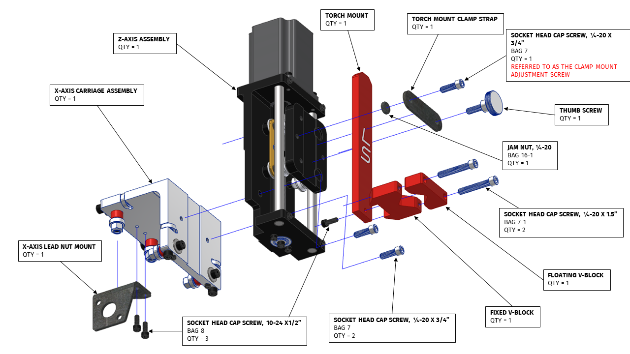

I have somehow broken the wires controlling ihs and have broken down the whole z axis mechanism. I am wondering if anyone could provide me the schematic to reassemble. Any help willbe greatly appreciated.
There is a couple of pictures on your Assembly guide.
Likely not exactly what you are looking for but a start
I haven’t seen any exploded parts diagrams for the Langmuir Systems tables.
Thank you every much.

This is what I needed , Thank you
