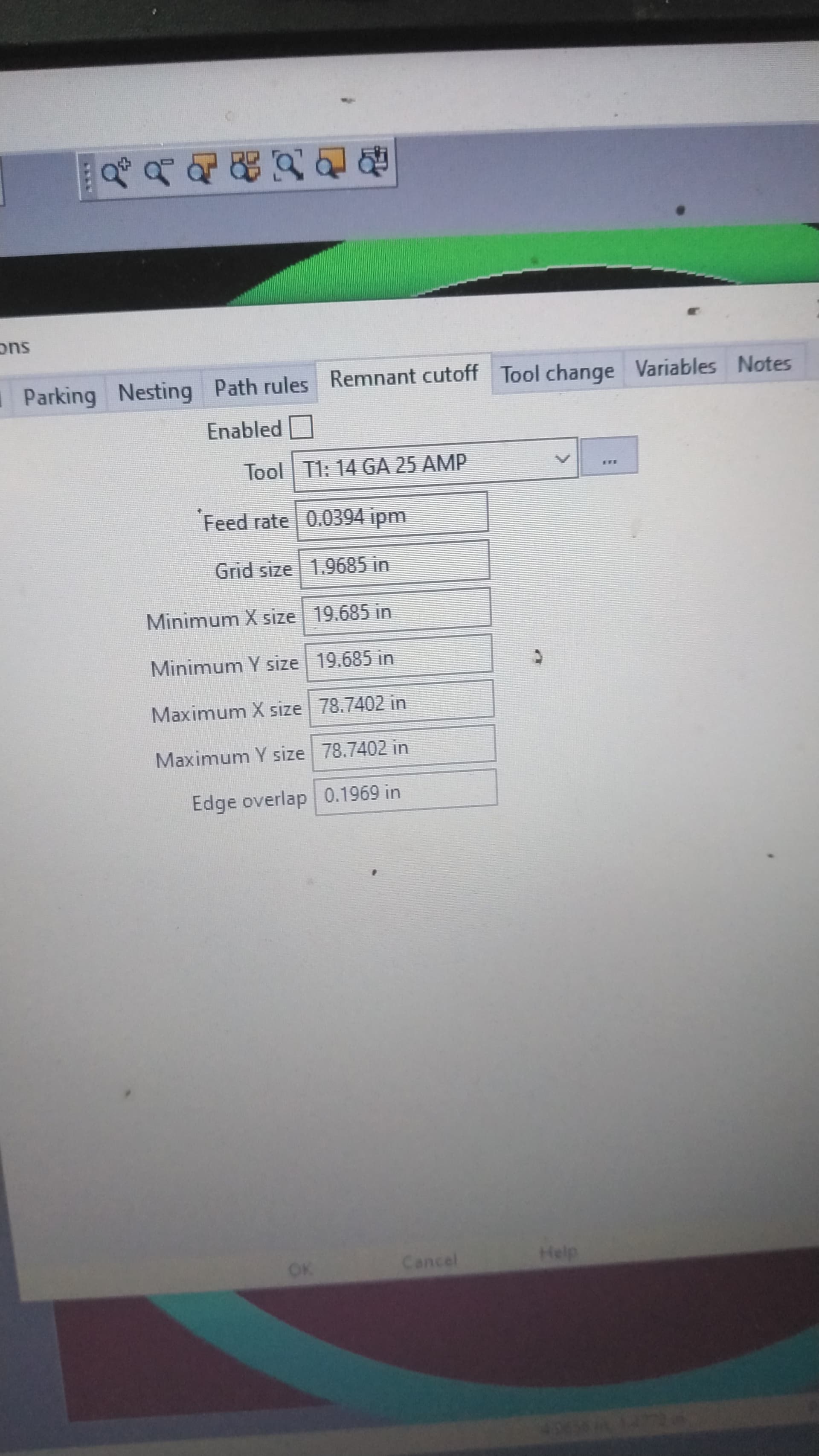

What do you have the plunge rate set at?

For some reason, it’s converting your feed rate to a negative number.

If you mean on tools and jet tool it says it is at 100 ipm

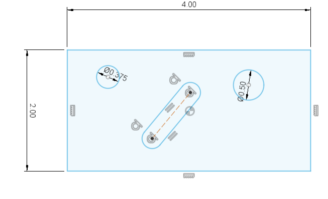

Do you have a cad program? You could sketch out a small piece. I could even post one later. Just something small so not a lot of code to look at. You can do this process with it and run the post process. The post the code or copy and paste it for us to look at it. That way we will know if it’s a glitch or something wrong.

Here is a simple bracket:
Simple Bracket.dxf (3.0 KB)
File is attached to this post. Phillip is saying that if you try a simple file to learn the CAM operation in SheetCAM, you will have less variables. Right now you have a very complicated piece that most people would not attempt until they had been cutting for at least a dozen projects.
Your feed rate in the simulator is -.0394, which happens to be the inch equivalent of -1mm per minute. I don’t know if you have entered that value somewhere or this is a units setting issue.

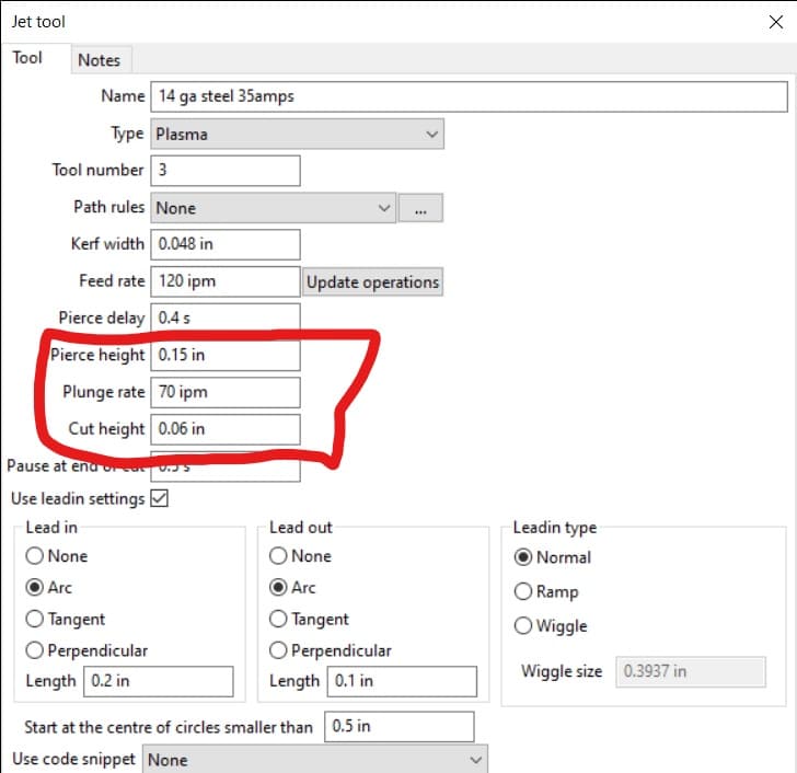

This is what your tool setup should look like, except the fields with the red box around them should be zero, since you don’t have a Z axis.

on mine it shows pierce height 0, plunge rate 100,cut height 0
would you like me to change the settings on the jet tool to what your showing
