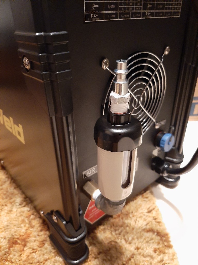

Have not used it yet but I installed a inline desiccant air dryer on the back of the plasma unit see photo but ignore the groovy carpet it’s in my den I’m not remodeled that room yet LOL.
I also have a inline desiccant air dryer up by my air compressor.
Those work great… for about 5 minutes :frowning:
Depends on your environment. I have a similar one on the back of my cutters. They work fine. I get a few days of cutting in the CT climate before I swap the dessicant out (I bake the pink stuff to dry it out & “recharge” it). I also have a couple of quarts of it so I can replace it if I haven’t had a chance to bake the old stuff.
I use them on torches, bead blasting gun, powder coating gun, etc. By putting them right next to the device I don’t have to worry about friction pressure losses in a pipe based water removal system or anything that might condense out in the air hose.
I bought one of those dessicant filters like that at Lowes and right out of the package it wouldn’t pass enough air to run the plasma cutter.
This is the one I use on all my machines.
https://www.amazon.com/gp/product/B07BR6W6D4/ref=ppx_yo_dt_b_search_asin_title?ie=UTF8&psc=1
Really understand your environment and the effect humidity has on the plasma process when choosing one of these dryers. I’m jealous that @jamesdhatch can run these little tiny desiccant dryers. I live in Phoenix which isn’t Tampa or anything when it comes to humidity, but we have plenty of moisture in the air. That first in line dryer that holes 1-2 oz of desiccant literally only lasts me 2-3 cuts and it’s completely pink. I wasn’t exaggerating when I said 5 minutes of use. The other dryer James linked holds 5 oz and would last me less than a week. I purchased one that holds 32oz and it’s fantastic. It’ll last a month downstream from my refrigerated dryer. I have another filter with a glass bowl after this as a fail safe so the desiccant material doesn’t end up in my plasma cutter and torch and there is never even a small sign of fog on the glass. 100% dry air. I would rather have one that holds 2-3 quarts so I wouldn’t have to change it but a couple times a year but the price shoots up to $250-600 for the big ones.
