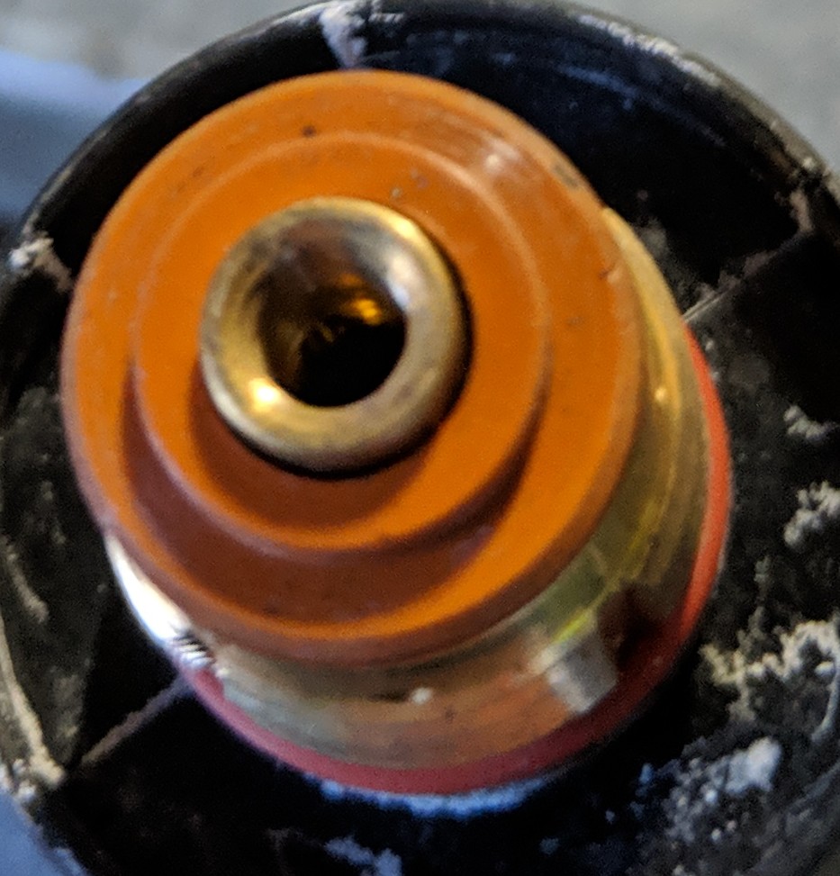

This picture shows what I was referring to.
The gap between the cap and the tip is the air exit from the retaining cap.

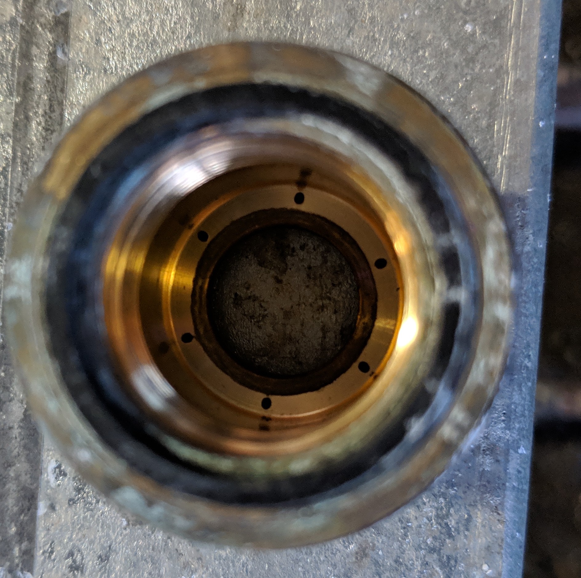

It comes from here. Notice the holes on the swirl ring are outside the tip’s body. As are the grooves in the brass base. In fact if you look closely from inside the swirl ring you should see that the holes are actually angled back to front. That’s what causes the clockwise swirl of the arc gas.
You can see the retaining cap has holes in the inside top to allow the air to exit through the gap in the first picture.

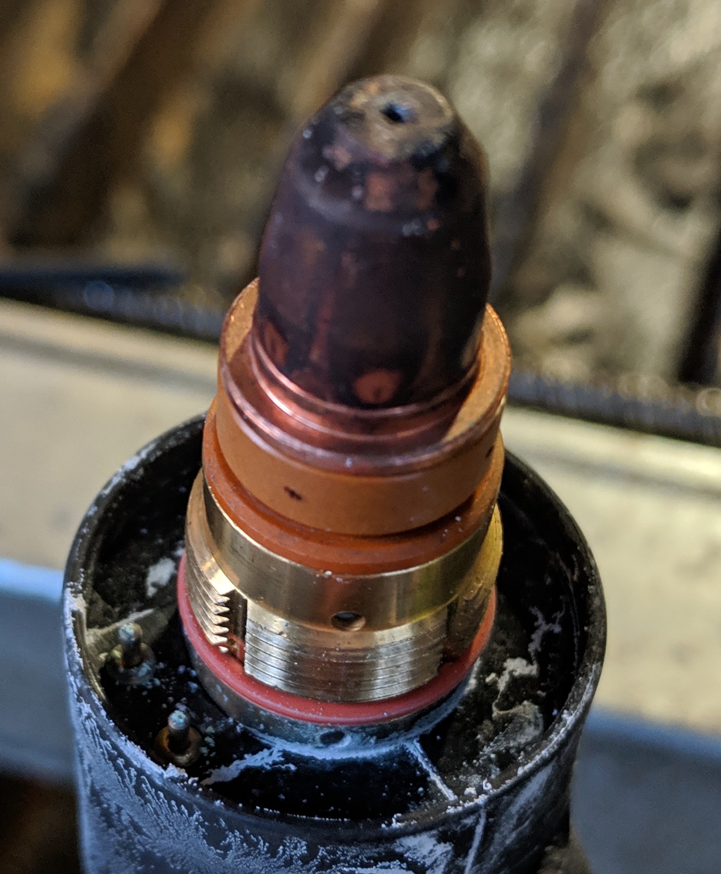

This is where the air comes from - note the gap at the base of the electrode. It actually opens up a bit when the retaining cap is screwed down - you can see that if you push down on the electrode there’s a larger gap.
So that’s the air pathway I was suggesting is not affected by the nozzle size.
The air has to do that because that’s what creates the plasma arc and after the electrode cuts out provides the cooling air.
(Yeah, I know my torch could use some cleaning :slightly_smiling_face: The white residue is the washing soda evaporate from splashback from the water table and I could use a swipe of emery paper for the cap and nozzle. The electrode is fresh though.)

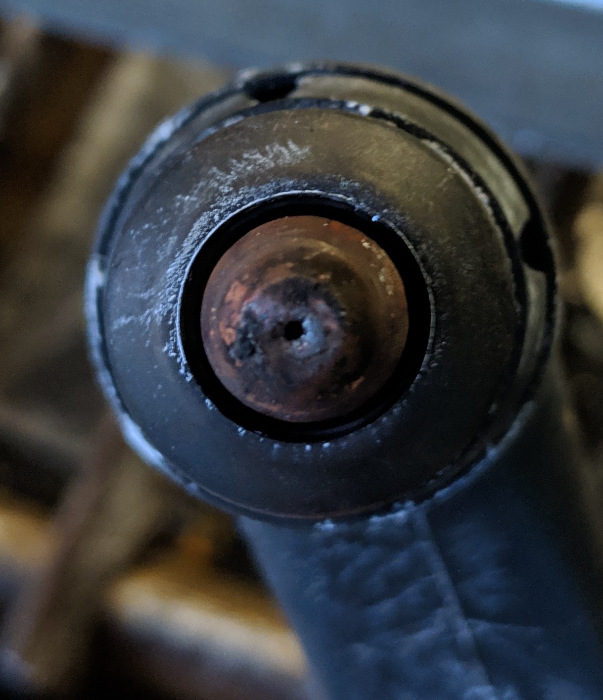

nice , high res pics. yeah i see what you mean. but it seems the shielding cap has considerably larger holes. anyway, just did some test cutting a few minutes ago. And there seemed to be little difference bringing up the pressure… So, the air consumption didnt change notably . I mean it wasnt like you used twice or 50% more air going from 50 psi to 70-75… I would say its less 10-20% difference, but i went back to the fine cut consumables. just from what I am seeing. So, regardless of PSI . I seem to get a larger benefit on air consumption based on nozzle size rather than psi. And in the end nozzle size seems to be relative to air consumption from my empirical real world experience.
@Jamesdhatch
Looking at the nozzle in the two pictures - how are they cutting? I would think this raggedness would affect the angle of plasma arc? are you still able to get an acceptable cut with a nozzle in the condition? because i would be changing this out a while ago// please advise./ perhaps i am changing too premature?
