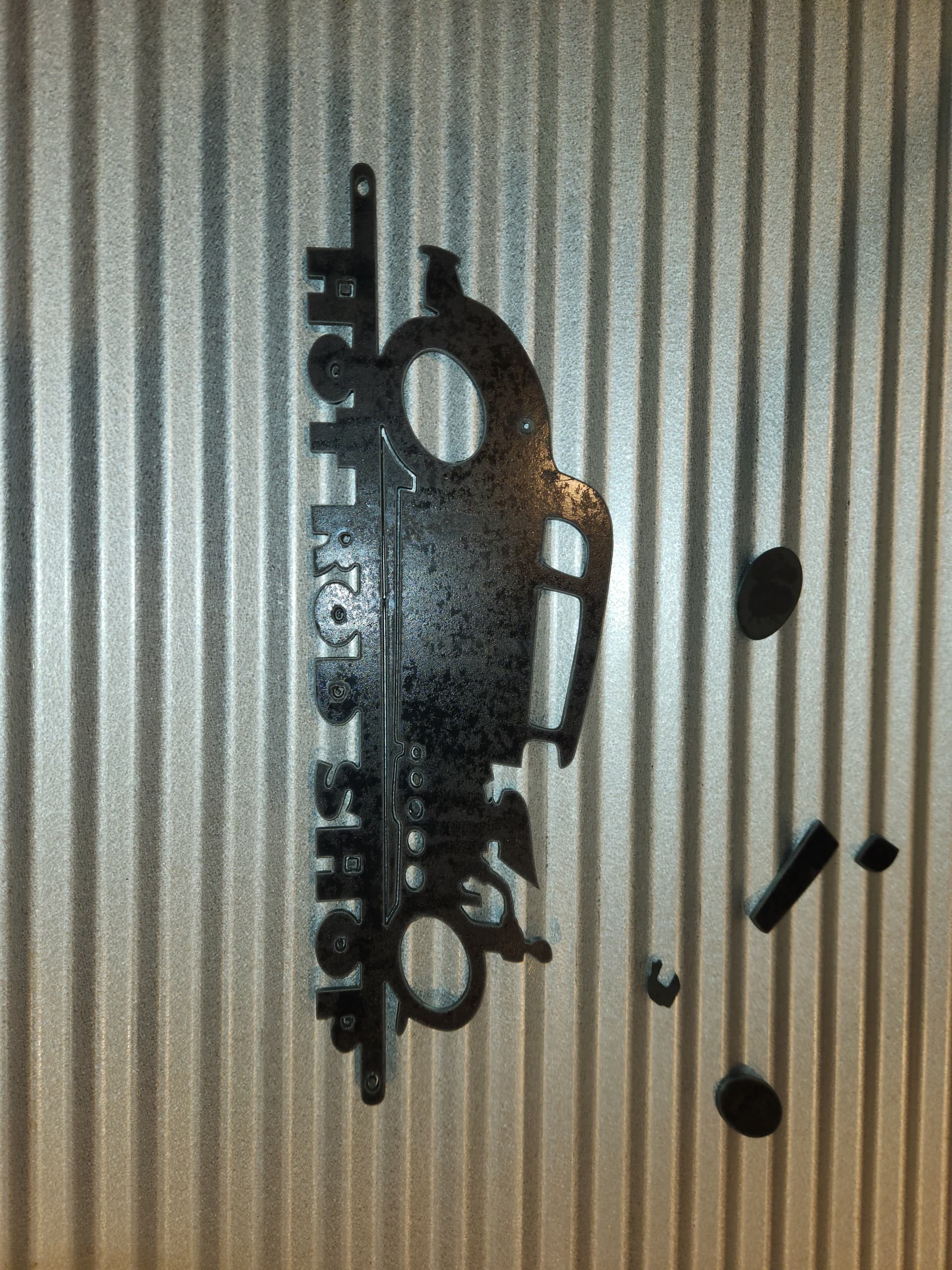

So i just went out to the shop so i could post a screenshot and for some reason what i was looking for was there this time. Lol. I was able to cut this out real quick while i was out there. Thanks for the fast responses everyone. The community support was a huge reason we went with @langmuirsystems.
