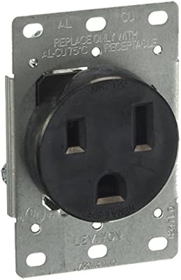

Add one of these:
along with a metal box and you have your 240VAC wiring done for less than 20 bucks. It’s a pretty easy job, much, much easier than the skills required to assemble and operate the CNC table

That is the outlet that I have. I am at work so I can’t take pic of box. I will have electrician look into adding another. I am a journeyman toolmaker and have limited electrical background. As far as skills running my machine, I am sure that I won’t have any trouble there.

George: if you contact an electrician, just tell them you want a second 240VAC outlet derived from that one and do not even tell them what you want to connect. Just let them know that it’s two 20A loads. If you have a 50A breaker in the panel, you are going to be fine. 6AWG copper wires are good for that.
