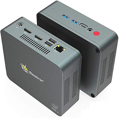

For those of you that have been using the small computers, how is it working thus far. Have you had any problems with any of the fire control software updates. I am thinking about getting one and looking at an I5 processor.
@sr71xjet - I bought a second one and put it and a touchscreen on my Shapeoko 3 XXL CNC router.
I think 4Gb is minimum memory required so Windows can do updates.
There are lots to choose from on Amazon.
https://smile.amazon.com/s?k=Mini+PC&i=electronics&ref=nb_sb_noss.
Let us know how it has worked out for you.
Jim
Looking at this one and the same monitor u have.
@sr71xjet - If you are only planning on running FireControl it is overkill. You can get one for half of that.
64Gb of SSD storage is more than enough so don’t pay for more than that.
Also, see how they are mounted.
This is the last one I bought
and mounted it to the monitor with this
