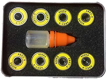

After completing the Y axis adjustment I moved the gantry assembly and “snap, crackle, pop” the lower fixed bearing block bearing snapped. I think I’m going to need another.
I saw this posted on here somewhere. Hope it helps…
Sackorange 100 PCS 608 ZZ Skateboard Bearings, Double Shielded,8x22x7 Miniature Ball Bearings(Pack of 100)
How the heck can they sell 100 bearings for about $18.00? Amazing!
Not sure, but it was recommended by an experienced Crossfire owner for replacement parts…:blush:
You get what you pay for.
Because the bearings run metal on metal I think these with nylon shells would be more reliable.
These also seem to be high quality steel bearings.
Whatever bearings you get, please let us know how they worked out for you.
They sell them by the billions and they generally don’t last long as a skateboard bearing. Fortunately a CF is not particularly challenging environment (as long as the bearing is sealed).
My home brew CNC router was built entirely from these cheapo bearings. Only had one fail in that application and that was an early fail.
They’re probably seconds. They’ve got no ABEC rating and the comments suggest the sizes are not within tight tolerances. But they’re likely fine for things like drawer slides and other non-precision projects.
They might be fine for the Crossfire since there’s a fair amount of adjustability in the gantry setup. But I’d match them in 4s so they’re all exactly the same before I used them.
Another alternative would be skateboard bearings with an ABEX 7 or greater rating. Not as cheap but way more dimensionally accurate.

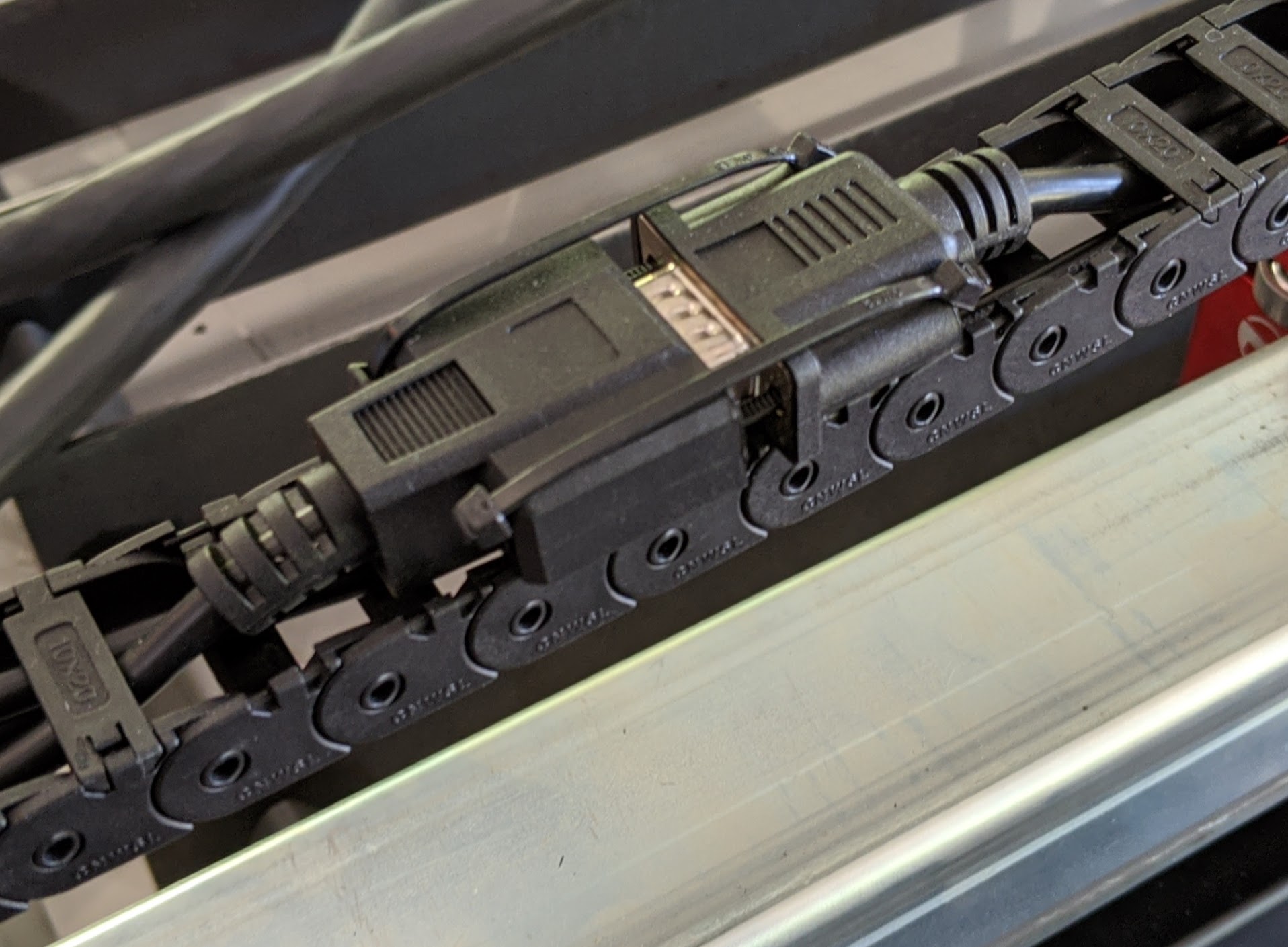

What size, and how much of the drag chain did you use?
I used 3 of the 10mmX20mm-outside open drag chain.
Amazon has them.
Ignore the 7x7mm in the description below - it is the correct link for 10x20…
https://www.amazon.com/gp/product/B07SFFT1K5/ref=ppx_yo_dt_b_search_asin_title?ie=UTF8&psc=1
If you order something else be certain to get the “Open Type” which allows you to carry cables with big connectors on the end.
You will also need to extend the Z-axis cable.
I used Amazon.com
Remove the screws at the connection and cable tie the male and female ends together.

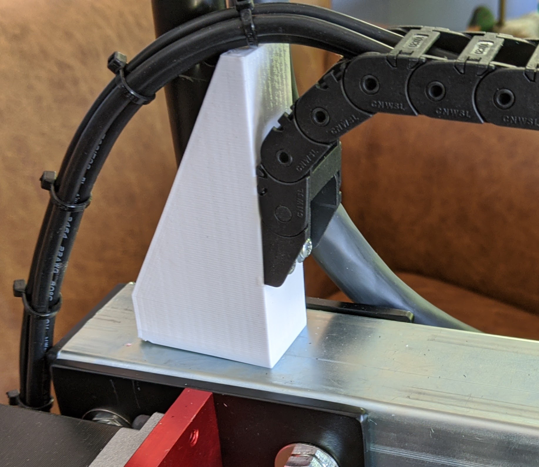

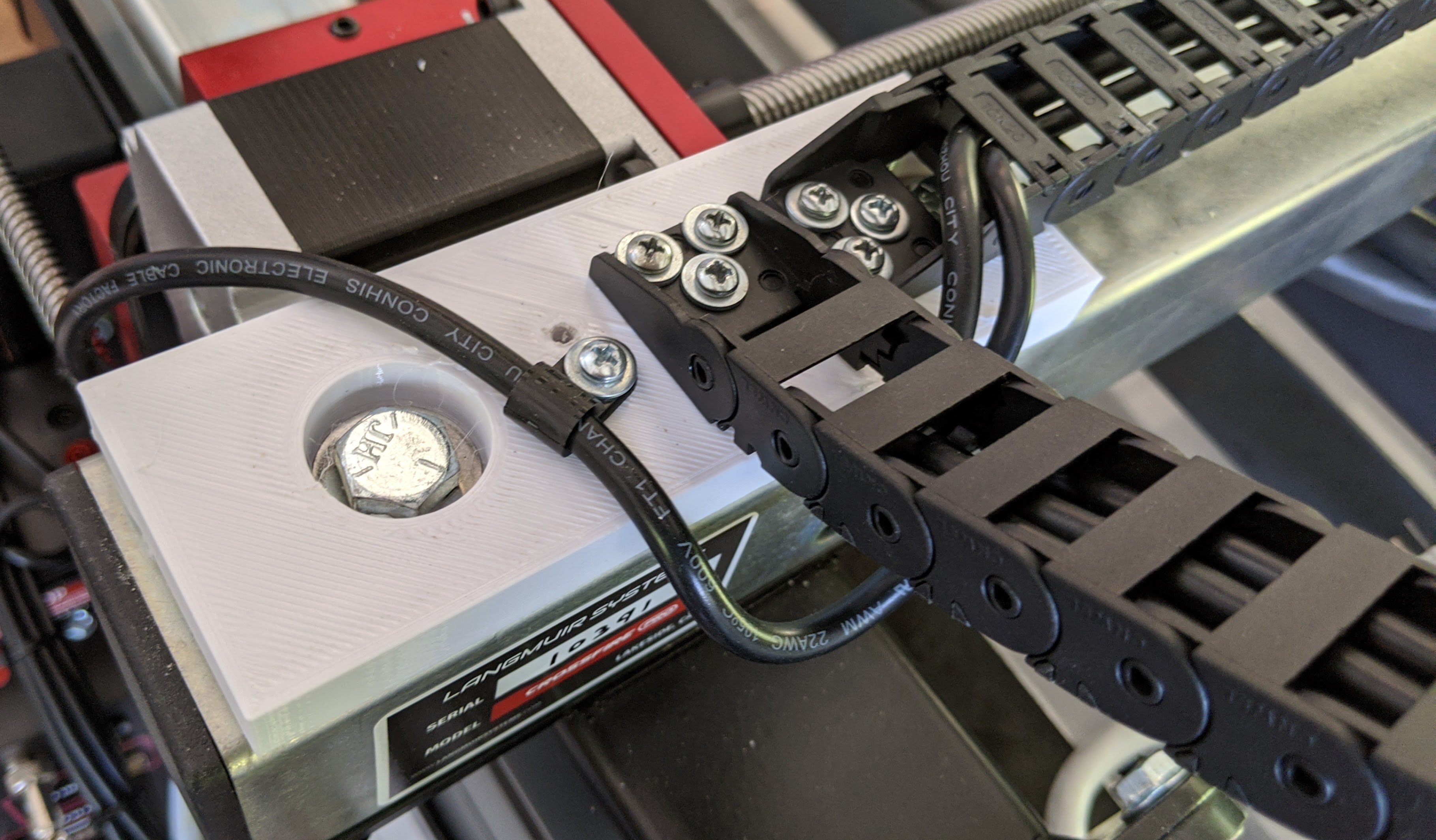

You will also need to make something to screw down the drag chains.

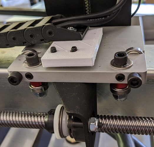

I drew up and 3D printed these.
On this one I lengthened the screws to be able to fasten it down. Note I haven’t put the nuts on it yet.

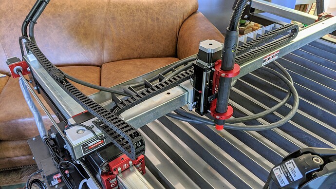

Can you post a picture of your setup with the drag chains zoomed out so we can see the whole thing? Looks like a nice mod.

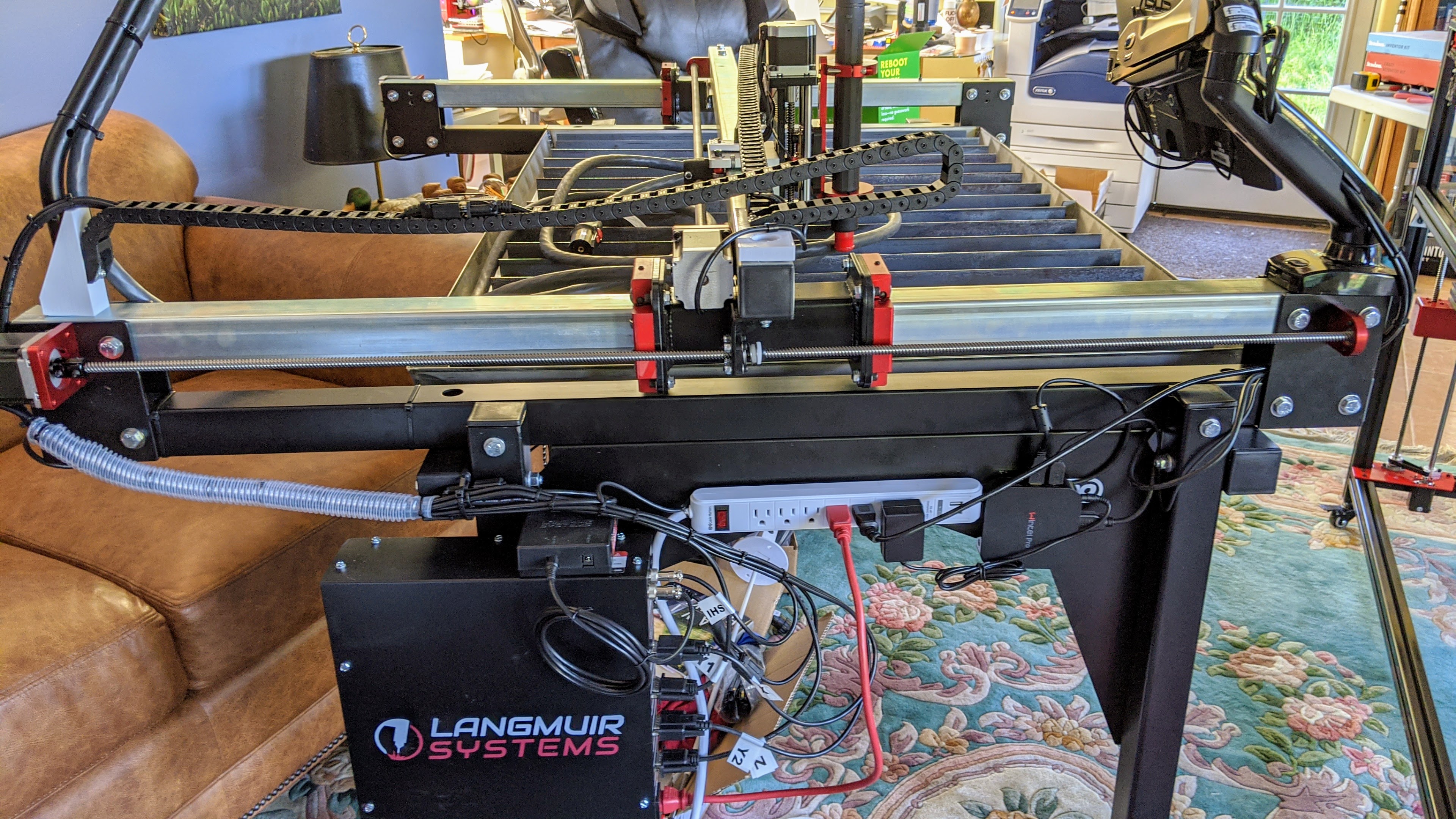

theworkshope - Here you go.
Looks like she’s ready to take out and put to work…:blush: very clean looking…
I figured that the first time I “butter fingered” a sharp piece and it cut a cable, I’d wished I had these. Great idea, they use on commercial tables, why not ours, huh.
I don’t know, Jim. While the CF appears to be ‘Basic Black’, the rug and the leather sofa match so well that I think you should, at least, go with ‘Espresso’ or something that would compliment the decor…
And that gaudy red torch holder? It’s just not happenin’…
However, having said that, I DO like the cabling! Fine job!

Why not just use nutserts or similar? Instead pf 3d printed parts as spacers? Easier since you can quickly 3d print?
