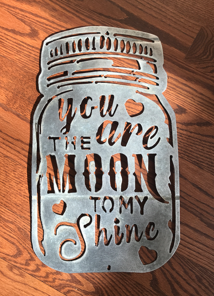

My 1st Susscessful Cut - Custom metal Sign
Man have I learned a lot in the last 2 weeks, thank you for those that have helped me. I’ve had a blast
Here’s my 1st successful cut, I did where a respirator and ventilation out the bottom of garage door. I’m aware of Zinc poisoning and took this exhaust seriously.

cleaning vinegar is the strongest of the vinegars…I am building a stainless steel tank to soak the finished metals…overnight soak is great…but keep in mind it will flash rust lightly very fast.
antique rust it…either cleaned metal…partially cleaned metal…or really well cleaned metal…spray metal with peroxide…sprinkle table salt over it…watch it rust
I’ve used a solution like the one mentioned below many times… Works perfectly and is somewhat curiously satisfying!
