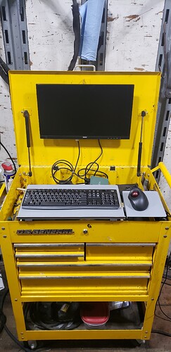

@TinWhisperer @holla2040 so because of you guys I went and spent more money. Space is super tight in my environment this is what I came up with.
Keyboard Tray and mouse folds down and then I can close the lid with the monitor attached.

That is really very helpful information and nicely presented.
Excellent workspace.

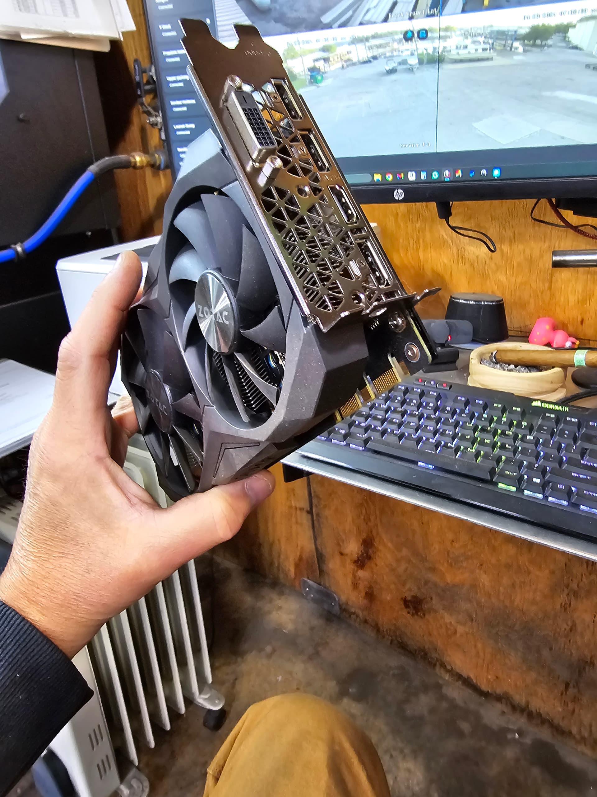

I can send you a Zotac GTX 1070TI video card to try. If it works, you will know what your problem is. Just send it back if it doesn’t. PM me your address. This is for a tower computer.
Appreciate it, but there’s no way my 3080TI is the culprit. Runs everything else on my system just fine, including intensive games (diablo 4, helldivers, etc), so yea. I’ll open the case up tomorrow and reseat the rams. Probably need to de-dust the thing anyways.
