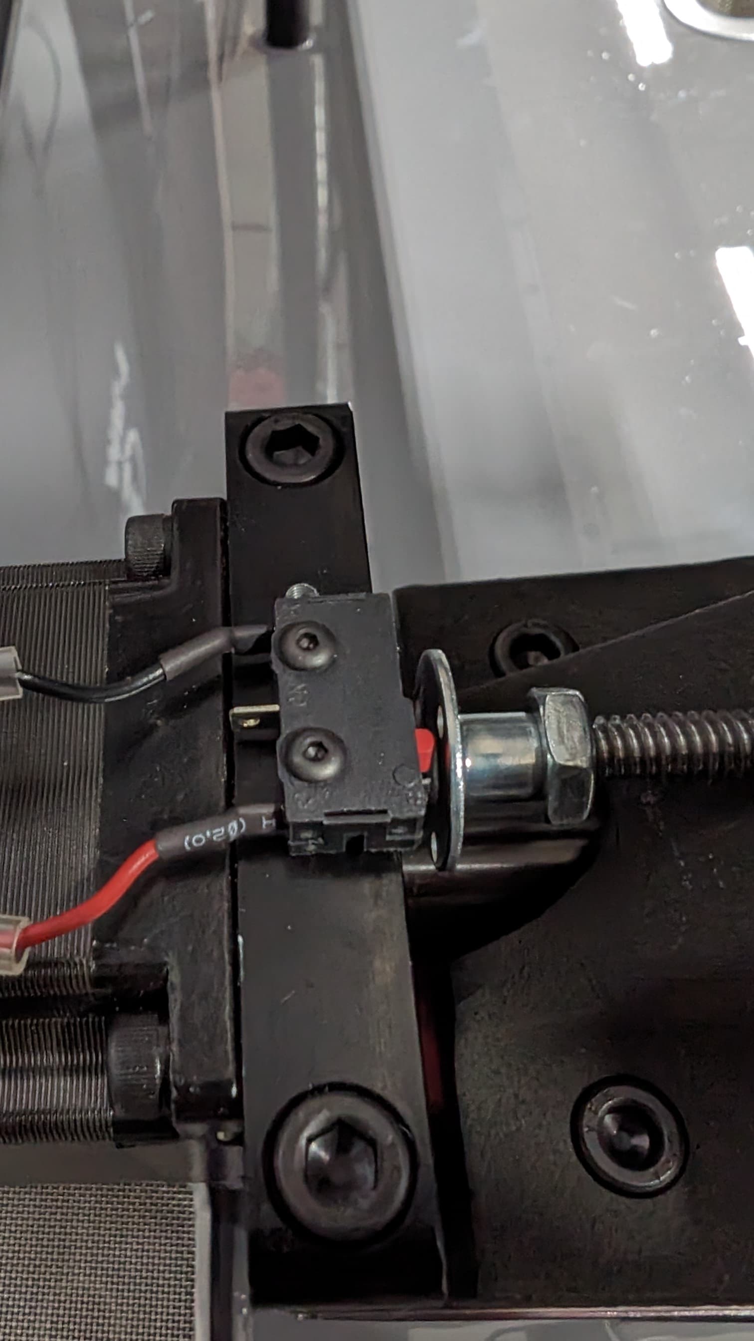

I was a bone head…reaching across the table and didn’t realize my jacket snagged the limit switch arm and broke it off. Found out what happens trying to home machine without one y limit working. Where can I get a replacement? Don’t see these offered on store at LS site. Wasn’t wanting to upgrade just yet…
The arms Langmuir use are industry standard.
You can find them on Amazon or eBay or similar for about 10 for $5. Just look for limit microswitch and match the arm length to the stock ones. Make sure to get NC or ones with both NO and NC contacts.
This is probably a cheaper option than Mouser. Plus prime shipping!
Looks like a fantastic solution! ![]()

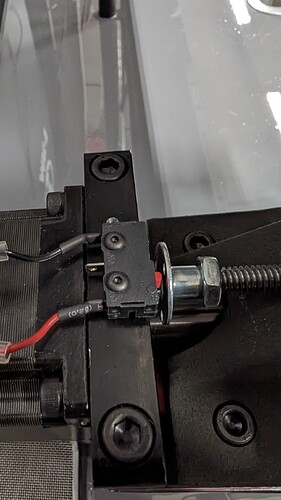

Think it’s a leveling foot for furniture but it’s a 1/4-20 thread with a flange to touch switch. It was actually easier to “time” with the other.
