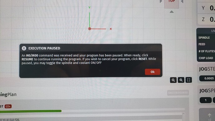

Update
I had a minute to swing by the shop this afternoon and tried a few things. I wrote a short program with interpolations and an M01, M00, M30, and M02 before each.
The machine ignored the M01, which I expected since there is no option to have optional stops on the control screen.
The machine DID stop on the M0/M00 with a pop up window saying the program was paused.
And neither the M30 or M02 stopped the machine from running.
This is the pop up for an M0/M00 command in a cycle for reference.
I can’t imagine there would be a lot of times that M30 and M02 not functioning at all would cause an issue except for the times like my instance where I only wanted to run part of a program.
In the future I guess I can use M0/M00 codes to stop it after certain cycles. Which would be handy for checking dimensions mid run also.
