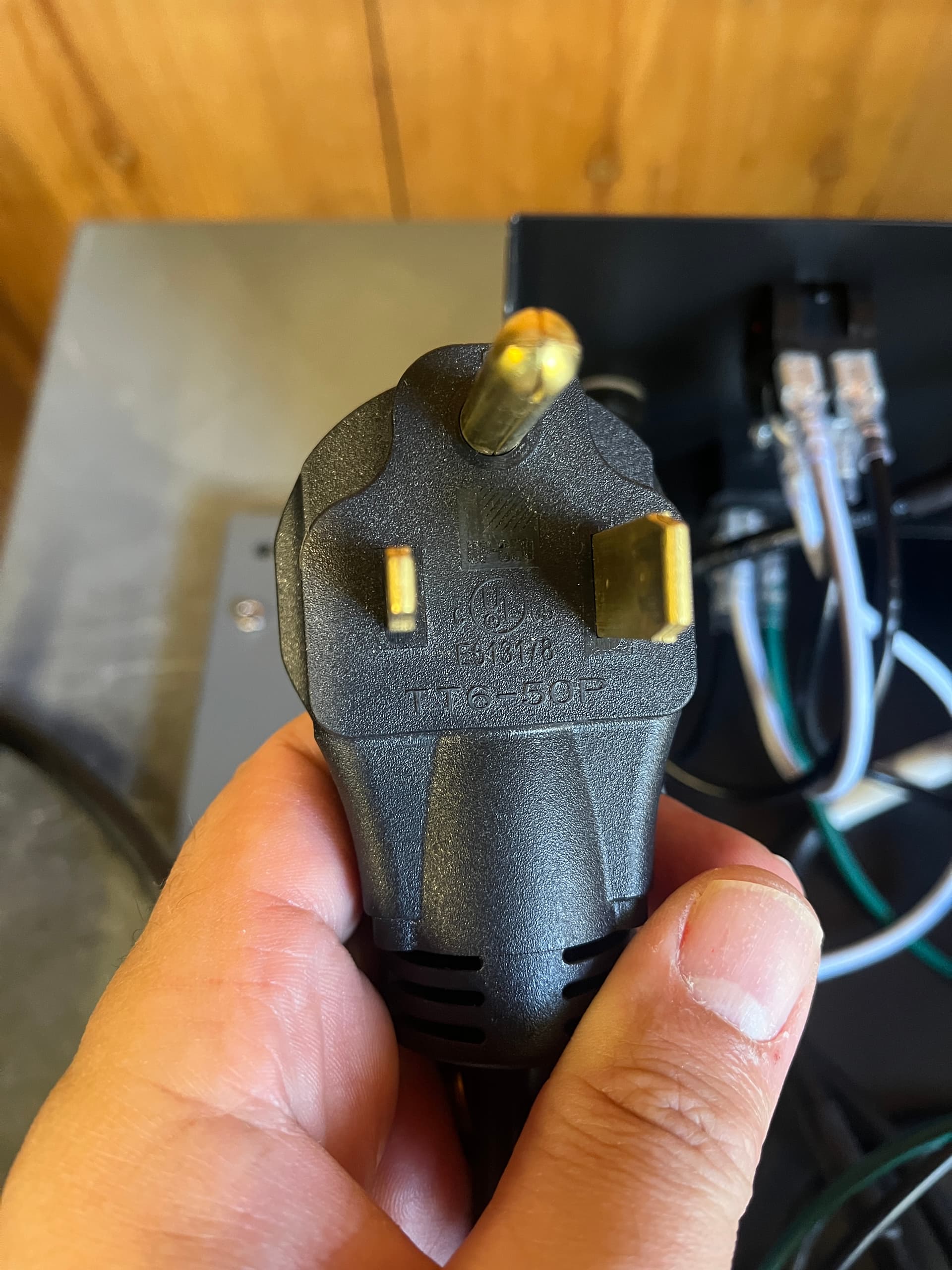

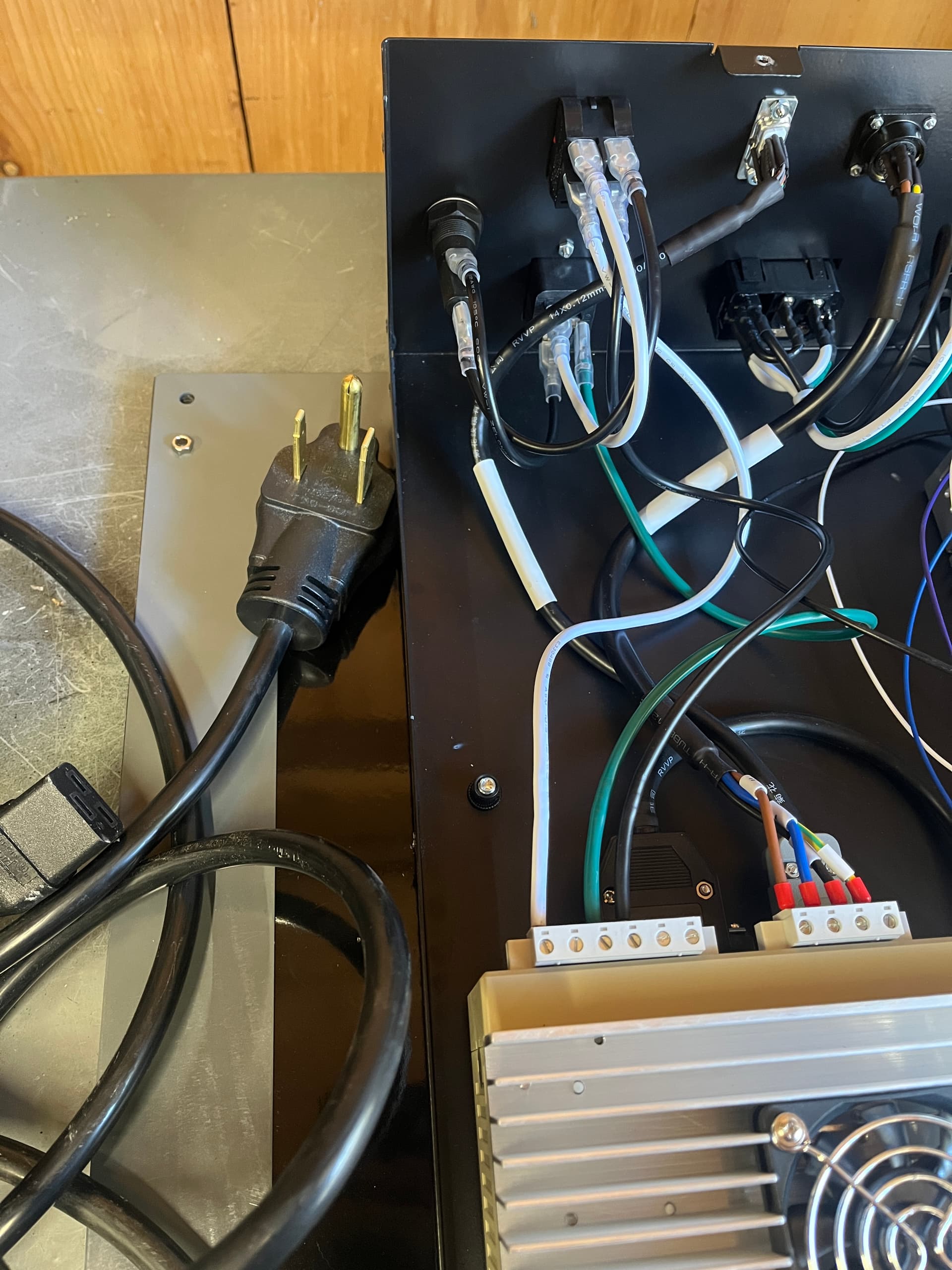

MR-1 Spindle uses 10-30, N connected to ground inside machine
I was looking at how to wire up my spindle outlet. I thought it was an odd choice to use a 10-30 given this is a ungrounded split phase plug. Opened the the machine, and the neutral wire from this 10-30 is connected to ground, which creates an unintentional N-G bond, will mess with GFCI’s etc.
I bet we have a mix of people using a 10-30 as if the N is a ground pin (most folks), 10-30 wired correctly with N-N (these folks are at risk of N-G problems), and some folks leaving the N open.
Some conflicting info from langmuir as well in this thread (2nd hand) “I was speaking with Langmuir tech support and they did say it should be wired hot, hot, neutral.” Spindle wiring help - #8 by MichaelBarker
That makes it sound as if the machine is expecting a correctly wired 10-30 outlet, but when you open the machine, you can see very clearly the N pin on the 10-30 is wired to ground.
My money is on the 10-30 should have been a 6-30.
I cut off the stock spindle plug and installed a new 6-50p plug, so that I can use the same receptacle as my welder.

I have a thread going with Langmuir and will update when they respond - I’m pretty sure this spindle is supposed to be connected to ground, and not neutral.

Response from Langmuir:
“” After some conversation with the design team, here’s what they’ve told me.
“So the final answer to his original question is that yes, the spindle, for best practice, should be wired to a 240 V, single phase, grounded outlet. You can pretty safely use a NEMA 10-30 outlet or the voltage converter from our website, but replacing the cord with a NEMA 6-50 or other single phase grounded outlets with sufficient current is the most correct by NEC standards.”
I’m sure this will be an important topic in our next design review meeting so we might be making a design revision in the future. “”
So based on this I (this is coming from me, not Langmuir) would encourage everyone to wire this in to a single phase grounded outlet such as a NEMA 6 series or similar, and if your machine happens to be installed near a pre-existing 10-30 outlet, do not use it because you will be connecting neutral where the machine is expecting ground, and this could cause electrical gremlins, at best.

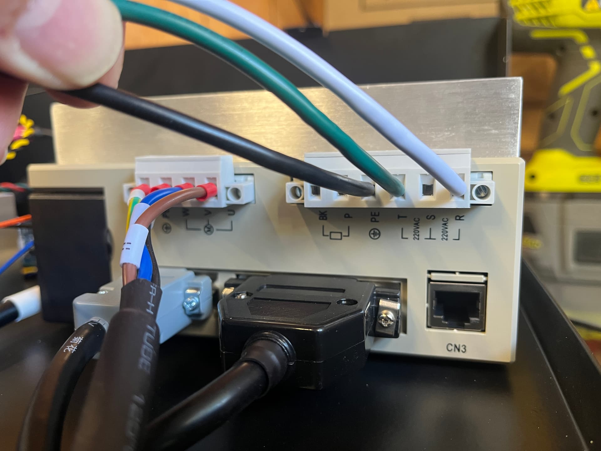

I realize this is an older post but thank you for the images and info. I wish I had found this particular post earlier.
I managed to blow my fuse and create some sparks upon connecting my spindle cable…So after looking inside to check the wiring… again… I noticed it’s different from the image provided here, with green and black in switched positions on the driver…. oof.
Langmuir have since changed to the 6-50p cable from what is discussed here, and I had a licensed, previously used, and trusted electrician for the job, install the appropriate gear.
Only reason I post here first is due to it being the weekend, I’ll contact Langmuir of Monday. But figured it might help others to post here also.
