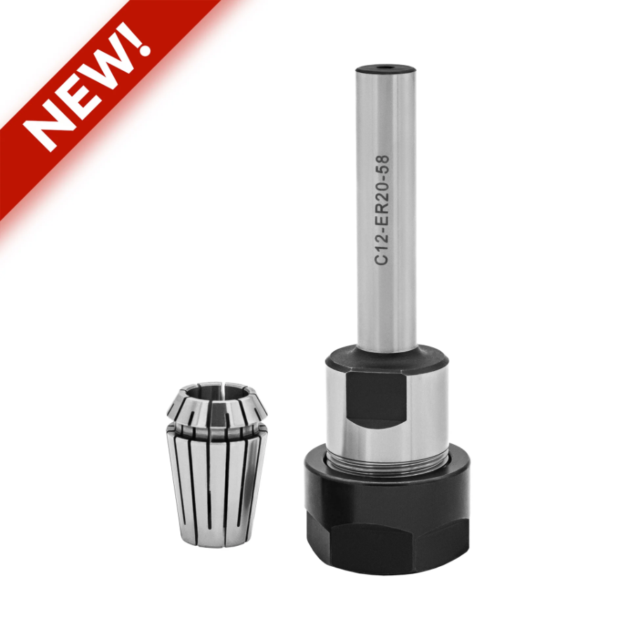

First up is the new Straight Shank Tool Extender. MR-1 - ER20 Straight Shank Extender – Langmuir Systems
The extender allows the MR-1 spindle to stay in the upper position and still be able to cut down on the baseplate or if you have a short cutting tool. This saves quite a bit of time not having to remove the spindle block and move it back when finished. Here’s a quick video if you want to see more of it.
Quick question, does this use same collet nut as for the spindle or are the threads standard? I bought extra nuts for my tools so I can keep a clean one for the probes.
I assume if this has standard threads we can get a collet nut from anywhere.
That is a good question. I just ordered one. I would hate to mix up those collet nuts.

I noticed that this showed up on the store. So does it loose any stiffness with the extension? I’m wondering if this should only be used for facing operations or if it can be used for any operations.

Yes the Tool Extender uses the standard M25 x 1.5mm thread so you can use other collet nuts.
You do loose some rigidity when using the extender so we recommend slowing your feed rate down and taking a spring pass if you have tight tolerances. Facing is a great use for it along with small diameter drills that normally wouldn’t be able to reach the baseplate.

Some of the first machines don’t use the 25mm x 1.5. They use 24mm X 1.5 due to a manufacturing problem on the original spindle. Ensure you don’t mix them up if you have a first gen MR1.
I have 4 of these that I’d sell for a bargain price to anyone who wants to pick them up in Seattle. Or buy all 4 wherever you are. I used them when I had the stock spindle to make tool changes easier – I kept a 1/2" collet in the spindle all of the time, and kept tools in these for quicker changes.
@Bigdaddy2166 Do the current machines use normal collet nuts?
I don’t know for sure. I would think that the spindles were updated after the original batch.
The problem is that the 25 mm nut goes on the 24mm spindle. You won’t tighten up correctly.
Our current spindles are still set to use the non standard M24 x 1.5mm threads so keep that in mind.
Don’t mix them up. Haha. It is all good as long as everyone is aware of the difference.

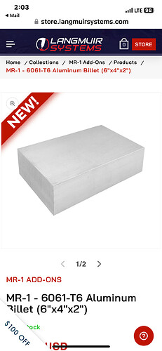

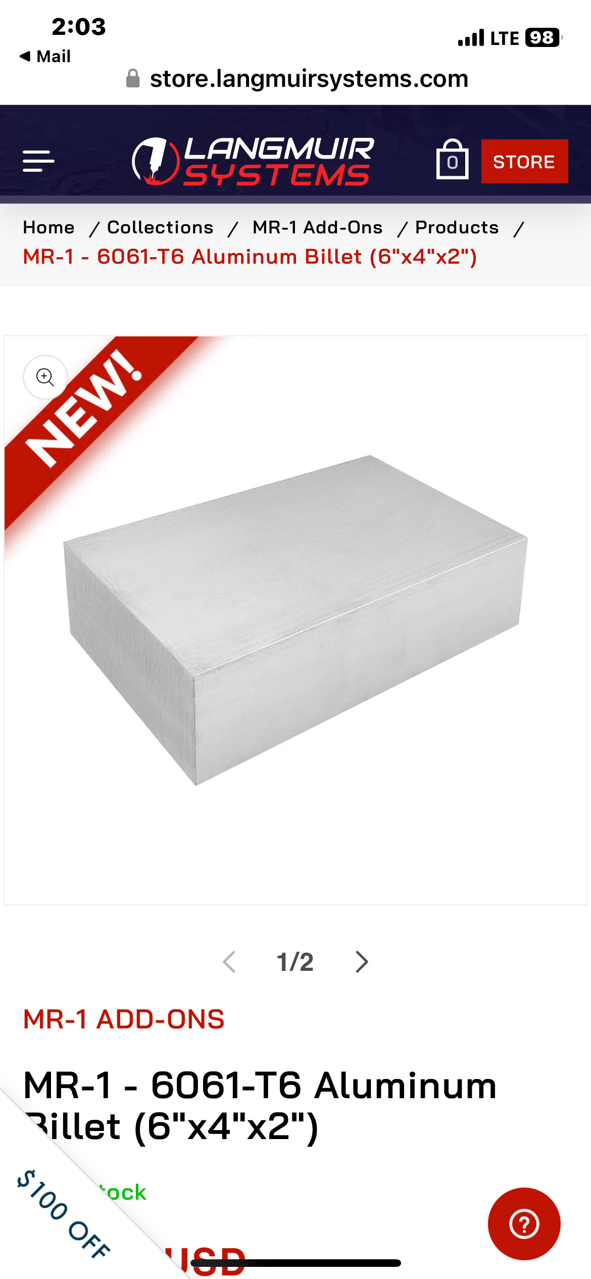

Is this going to be a permanent item, or are you just getting rid of remnants?
We plan to have these as a permanent item since some customers have been asking us where to find material for projects or for practice. If sales go well for these billets, we’d like to expand to other materials and sizes.
