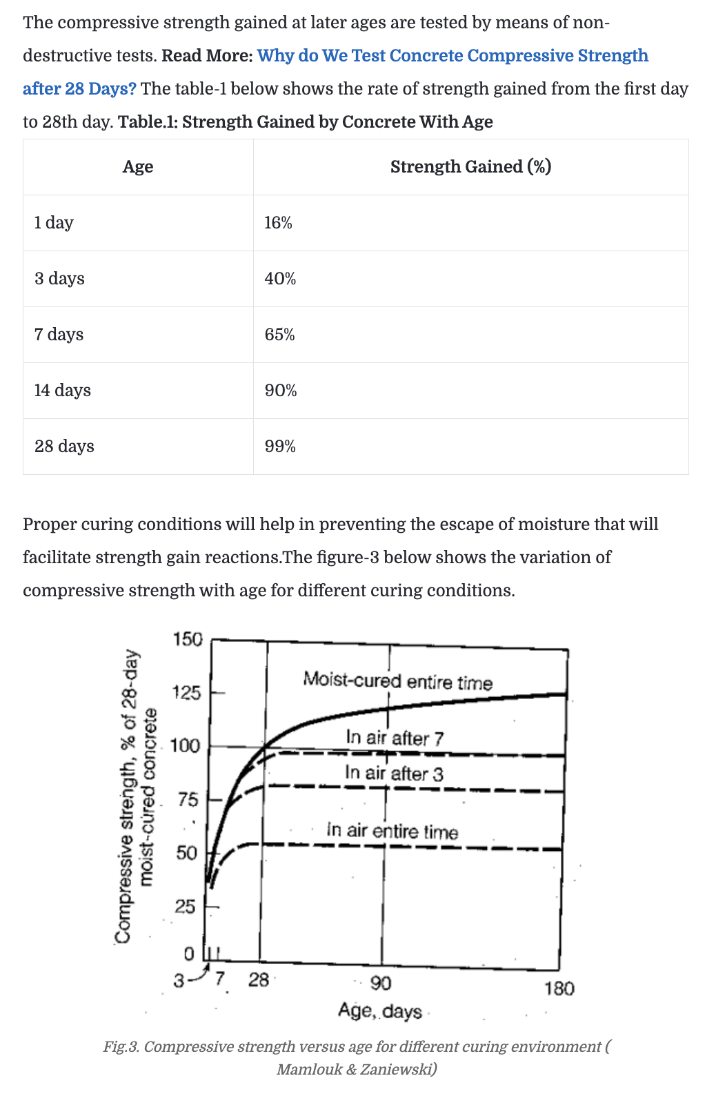

Just out of curiosity, how long are you curing the concrete before subjecting the machine to shipping? That gives a baseline if people need to move their machines that they built themselves …
Cheers,
Mike
It’s mentioned on here somewhere, couldn’t find it but i think they recommended a 3 week cure time before moving the machine.
