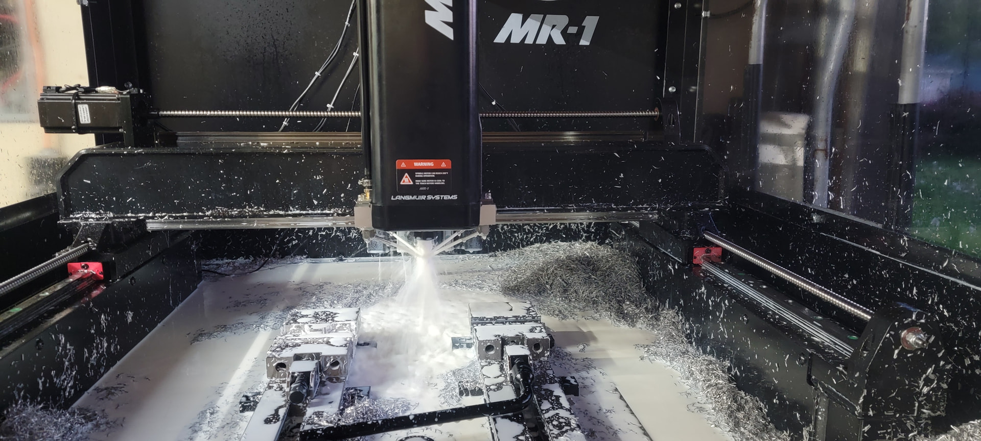

Hahahaha I’m only asking $6,000. Here are some pics.

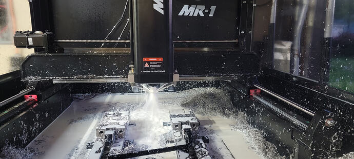

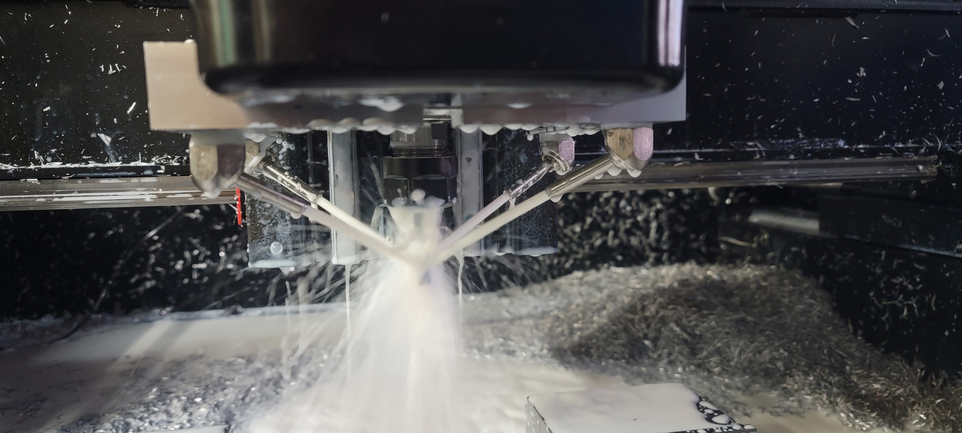

The coolant is a 4 nozzle manifold that doubles as a spindle wrench. So you only need 1 hand and 1 wrench to change tools.
Holy shit. First off love the coolant set up, where did ya get it? Machine looks really clean so thats awesome. I dont think youll have an issue selling it not at that price.
Dre, I will buy that coolant setup. Let me know how much. Your machine will still be worth $6k. PM me, and I will PayPal you.
You gonna share or make some right???
Its my own design. I’ve got CAD of everything. I got tired (and still hate but its not so bad anymore) using two wrenches to change tools. I also not a fan of the LokLine nozzle. I tried a ring version but it sucked just as much. I needed something that had enough pressure and volume to evacuate swarf. It also completely eliminated any need to re-aim coolant since each nozzle can be pointed for a different length tool. There’s also plenty of room to add more nozzles if so desired but 4 covers all angles so theres always coolant where its needed.

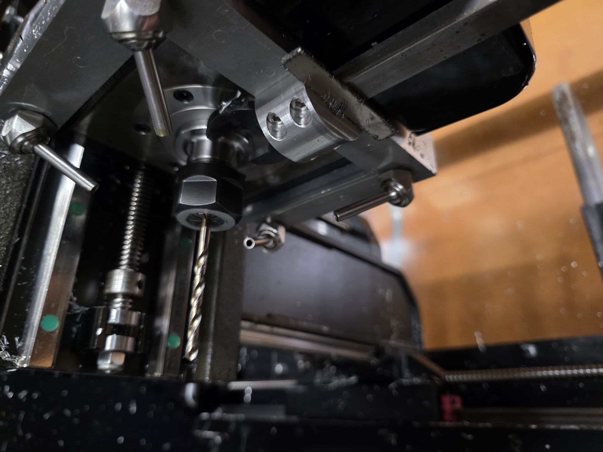

The internal channels are not something that can be made on the MR-1 For anyone wanting to make one at home due to the amount of Z required to drill them. I drilled this one on my lathe.
Installation does require trimming the bottom of the spindle shroud by about 1/2" but everything else bolts to existing features/holes in the spindle.
If yall want to purchase the setup, let me get my new mill running and I can make some for yall.

For anybody thats been asking, I got pricing on all the materials to manufacture a batch of the nozzle/spindle wrench manifolds, the material kinda hurts. If I’m going to make some I’d have to sell them for $300.
This would include the… I’ll call it the Spindle Lock, which makes for single wrench tool changes.

Yes, complete setup. Identical to what i have installed on my machine except probably a little better looking
The nozzles showed up Thursday actually. I’m still waiting on plugs but production on the first batch of 6 is starting today.
