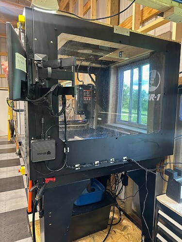

What, you guys didn’t get the optional sliding side windows with your machine? :grin: Here’s what it looks like. Ok, it wasn’t an option, I admit I did it because I couldn’t reach the back of the machine. Printed up some parts on the 3D printer and now I have access.

That’s a good idea, especially for machines using mist/fogbuster coolant. Did you make the tracks or find a good off the shelf product for them?
I made the tracks using a 3D printer. They are made in sections since my printer can’t print a 36 inch long track. Simple to design. When installed I left the track pieces spaces about 1 inch apart to allow for coolant to drain and not collect in the tracks.
Ah, that makes sense and is easy. This might be one of my next projects, I get very sick of pulling those panels out when I need to access the back of the machine.
I also printed the handle and various plugs for the original holes holding the glass to the machine. I just superglued them on.

Here is a pic of the CAD model. The brackets are 230mm long. The bottom bracket channel is shorter than the top to allow for the panel to be lifted and removed if necessary, The bottom channel is 3mm deep and the top is 6mm. Overall height is 28mm and 31mm respectively.

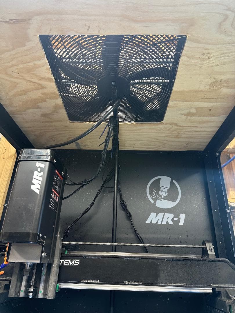

I have considered many options for removing chips. I think I have come up with the best compromise for my situation. I installed a small box fan that I purchased at Lowes on the plywood ceiling that I made for the mill enclosure. After a long day of making chips I run the fan over night to help evaporate the coolant from the chip pile. Then in the morning I just vacuum the chips up with my shop vac. I originally tried to vacuum the chips while they were still wet but even though my shop vac is a wet/dry model this just made to much of a mess. Additionally, an added benefit I found was to run the fan while machining. The enclosure gets pretty hot and swampy inside but with the air flow it is much cooler and way less humid.
