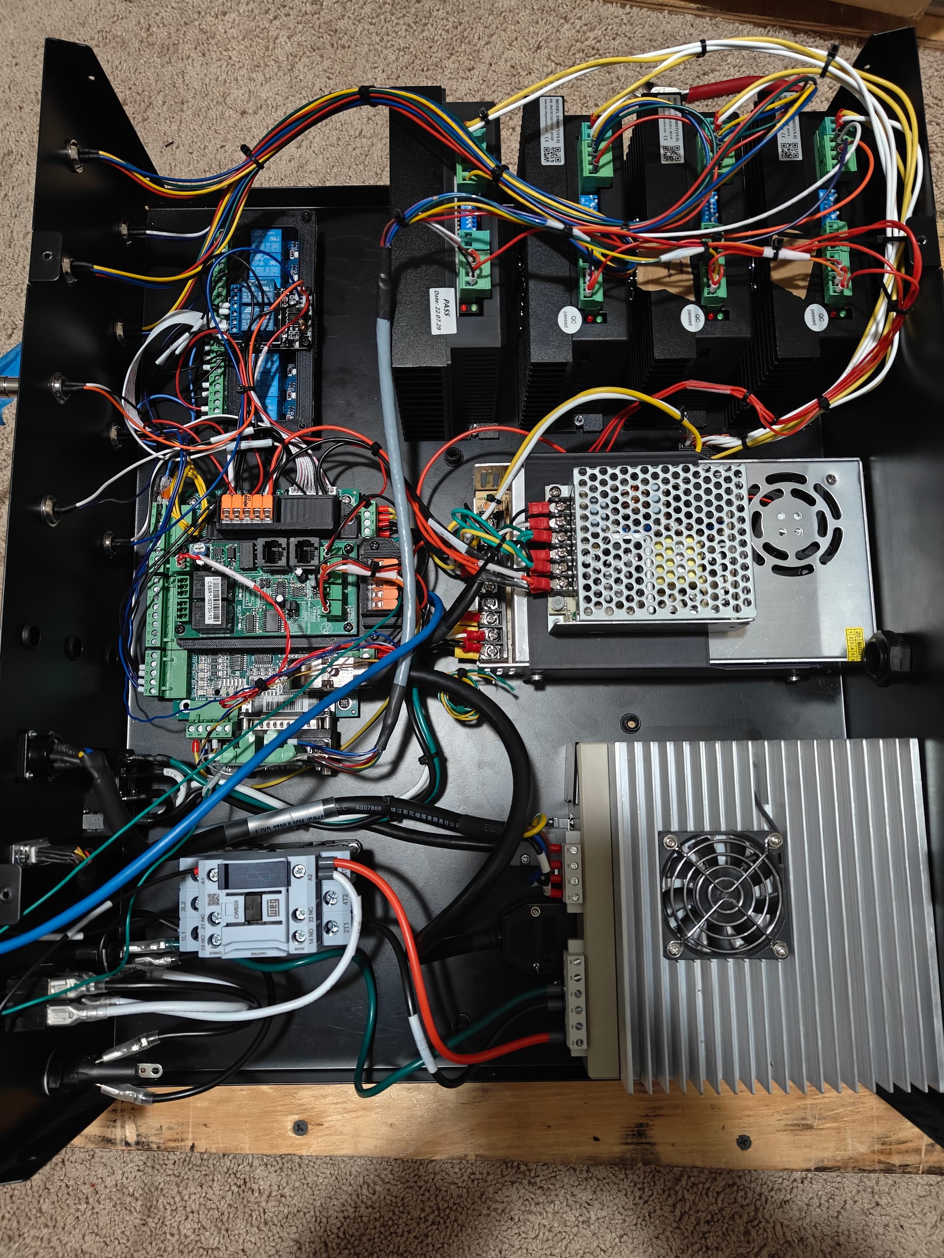

Inspired by @AlexW, @MrmachineTX and @Arcnsparks, I have decided to upgrade the control board in my MR-1. I am trying to keep everything in the existing enclosure. Space is tight, but doable. I had to use WAGO connectors as terminals as there is not enough room for DIN rails, terminal blocks, relay board, and the larger stepper drivers. Not ideal, but I have been using them on one of my 3d printers for 3+ years and no failures so far. One day everything will likely get moved to an appropriately sized enclosure.
Here are the improvements so far:
  • Upgraded the low power steppers to STEPPERONLINE DM860T drivers
  • Added forward and reverse to the stock spindle using a CNC4PC C89 speed control board
  • Connected the VFD encoder output to the Acorn encoder input to get actual spindle RPM (accounting for 2:1 gear ratio). This may allow for rigid tapping.
  • Wired in a magnetic contactor to the VFD so the e-stop button actually cuts power to the spindle rather than being a software stop.
  • Added an E-Stop with two switches to send an E-Stop command to the controller
I am documenting everything and should have a pretty detailed wiring diagram. The VFD needed some programming changes as well. If I can remember everything I changed, I will include those settings.
In order to get everything to fit I had to create and print mounts for various parts. This includes mounting the C89 on top of the Acorn, mounting the 24v/5v PSU on top of the 36v PSU, and mounting a 2 channel relay on top of the Acorn relay board. The limit switches needed to be rewired so I designed a new strain relief to help support the wires.
Here is a picture of the box for those interested.
Forgive some of the messiness and the misaligned contactor. Wiring a control box is new to me. I am waiting on more wire to clean up some of the ugliness and mismatched wire colors.
Here are the issues that needed to be tackled:
  • The VFD is not configured to allow reverse. It needed to be reconfigured. The gain on the analog voltage needed to be adjusted as well. There are 2 or 3 parameters that need to be changed to accomplish this.
  • The Acorn uses sink to ground for its inputs. This does not play nice with the tool setter and touch probe. As a work around I installed a 2 port relay that uses the 5v signal from the probe and tool setter. It is connected to the relays as NC and opens when tripped. This allows the touch probe and tool setter to be detected. It also disables the spindle when the probe is connected.
  • The stock E-Stop on the MR-1 is only a software E-Stop. It does not actually disconnect power. If the controller locks up or has a problem, there is no way to stop the machine. I bought a Schneider Electric E-Stop with two switches. One is NC and powers the magnetic coil for the contactor. The other is NO and tells the controller the E-Stop button has been pressed.
  • The limit switches are not wired in a way that is optimal for the Acorn. They can be connected to the controller without issue. However, it takes 4 inputs to get them to work as intended. I cut apart the cable and wired X, Y1 and Z in series. Y2 is wired by itself and shares ground with the others. This only requires 2 inputs for homing. The Acorn will home one axis at a time and square the gantry using the standalone Y2.
If there are any questions, please don’t hesitate to ask. I haven’t installed the control box onto the machine yet and have been bench testing. I hope to get everything back up and running this week or next. I can add videos if there is a demand for it.

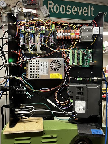

You can flip the 48V power supply on it’s side to get more room. Thanks for @MrmachineTX for pointing this out to me. The Acorn board looks quite a bit bigger than the Mesa board that I used, so I see why you had some tough space issues.
I also used smaller stepper drivers, which got me more space on that side of the cabinet.
I kept the stock enclosure for a year, but I just started the project of moving to using Clearpath servos and their PSU doesn’t fit into the stock enclosure, so I’m moving to a new one. I’m pretty excited about doing it over from scratch and arranging it how I want it to be. The new one will also have a door, which will be such a huge improvement.
This is a photo of my stock cabinet re-wired for LinuxCNC from about 9 months ago if it’s helpful. You can see how I squeezed in the DIN rail in the upper right.
I followed your GitHub closely! Your content there and on here has been a tremendous help!
The Acorn is quite a bit larger and the relay board adds to that. Your DIN rail location is exactly where I hoped to put mine. I wanted to mount the stepper drivers and relay board to it. The problem I ran into is once on the rail, the steppers hit the enclosure lid without wires in them. I was able to model and print a rail mount that was low profile but the high power Z driver still needed another 5mm to clear.
I also tried mounting the PSU on its side, but with the 5v PSU on top, there wasn’t much space savings. In the end, I really needed a better enclosure, but this is a good start. I imagine my path will be similar to yours as far as the enclosure goes. I really wish I could have laid it out better, but a new cabinet and required parts wasn’t in the budget at the moment.

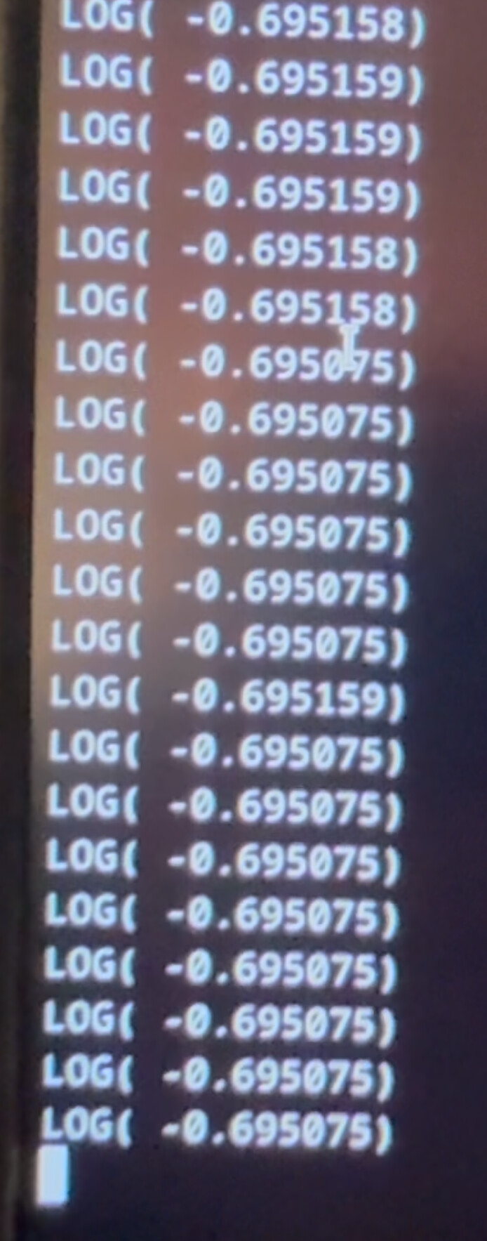

I got the $35 one mentioned above and set it up today. I’m getting good enough repeatability for my needs, about .0001 inches using a script that repeated measuring the same tool a couple hundred times.
The Drewtronics looks nice too, but I accidentally smoked my Langmuir tool setter and needed a quickly obtainable replacement.
Internally it is just a simple pair of switches — it has no electronics. I haven’t setup the air blast, but that’ll be a nice feature too.
Here is a screenshot of output from repeated testing:
Two complaints are that I did see more variation in results on the first 50 or so measurements with a total variance of about 1-2 thou. It dropped about .000075 (probably 1 step) every 3-4 samples until it settled out and bothered between two values. I expect that this was due to springs settling from initial use, but I’ll need to see if it happens again after the machine rests.
Also, the cable is 2m and too short.

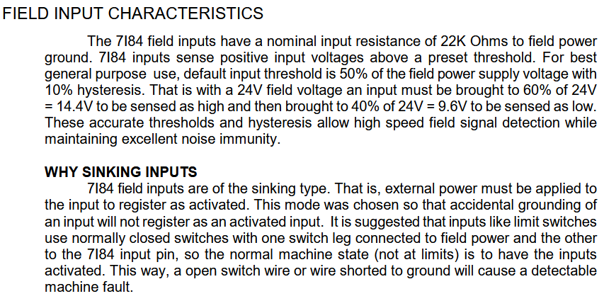

My one criticism of the Acorn is the lack of inputs. There are only 8 and adding more is substantially more expensive. The tool setter and probe take up half when using detection circuits.
Oh, 8 is very limiting! The Mesa 7i96S (the board that I used for LinuxCNC) has 11 which got me started but became an issue, so I recently added an $80 I/O board called the Mesa 7i84 to get another 32 inputs and 16 outputs.
I feel a lot better with this, now I have some things that I wanted but couldn’t afford I/O for like individual fault signals from all 6 motors (5 axis, 1 spindle).
The 7i84 also sinks to ground. The 7i96S is very flexible in how you configure the inputs. This is from the 7i84 manual:
