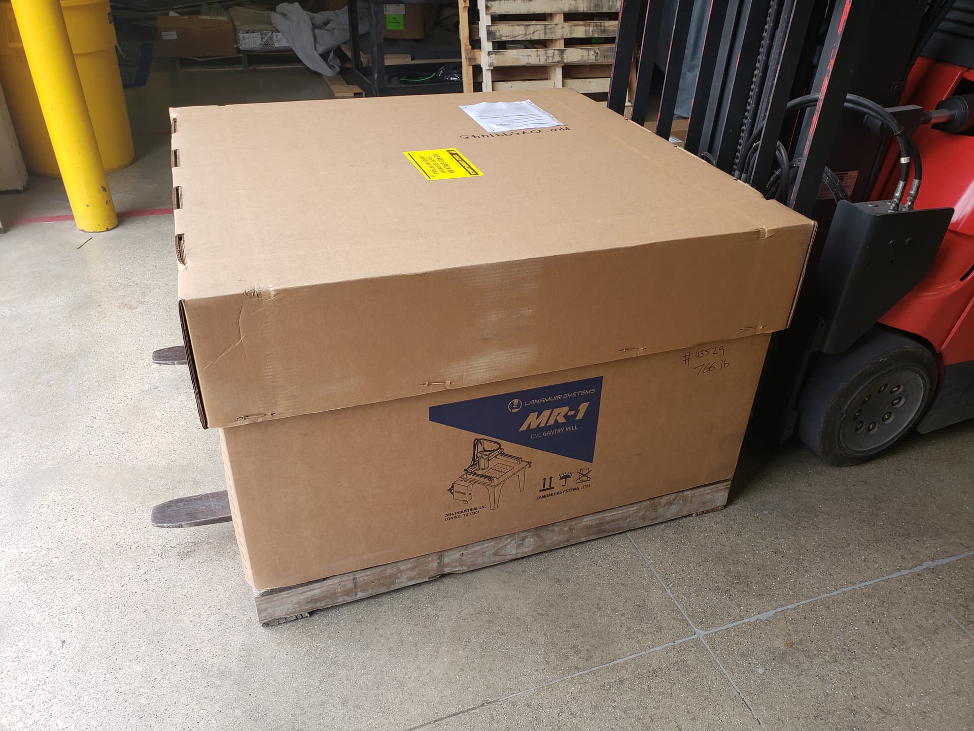

Mine showed up today! It safely traveled all the way to SE Michigan.
I won’t be as fast as some of the others but I hope to get started on it soon. I have a few modifications in mind that I would like to share as I go.

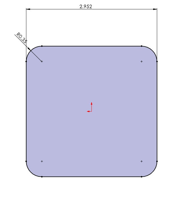

I rummaged through the box a bit and everything is packaged really nicely. One thing I wanted to do is make blockoff plates for the corner drains. I measured this out and the sketch of the opening is in the image below. The DXF is undersized .020 per side if anybody wanted to plasma them out.
I am going to print a set with a finger grip. It should print upside down with no support. I would include the STL file but it’s not an allowed filetype.

I think you can change the file ext and upload that way

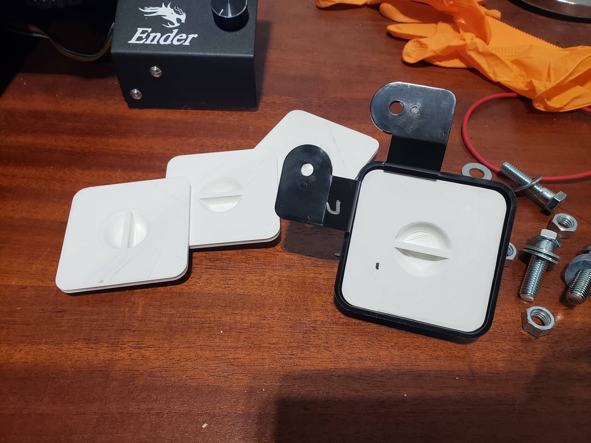

Good call on the filetype. 3d print file attached.

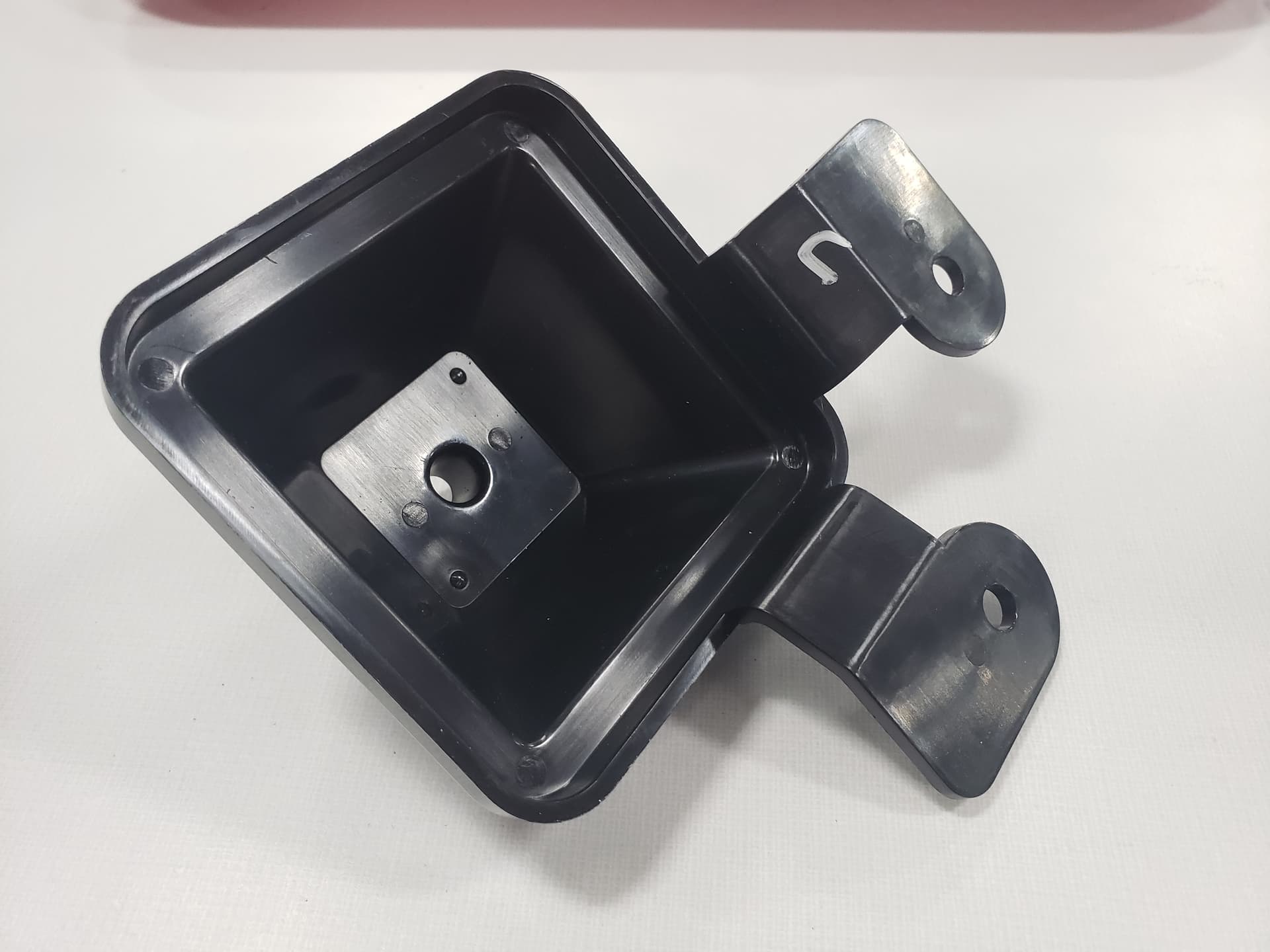

Any chance i can talk you out of the height from the drain top edge to the mounting tabs. So basically how far below the top ofthe machine tray the drain sits. Im going to build my own coolant system higher preasure and in tern more volume to evacuate chips in pockets. So want to build higher volume drain.
@Lenness I measured it at 0.410"

Change file extension to dxf and then we can change back after downloading.
I’m slacking behind all the other builds. I got the whole mess unloaded and the drain covers printed. Woot
Nice job.That will ensure you don’t get any epoxy in the drains. Geat idea.
Ill be printing these soon.
Did the 3d printed covers need supports? I will be printing them soon. Thank you.
No supports required. They are drafted and there is a little bridging that occurs at the bottom of the finger holes but mine came out good enough for what they are.
