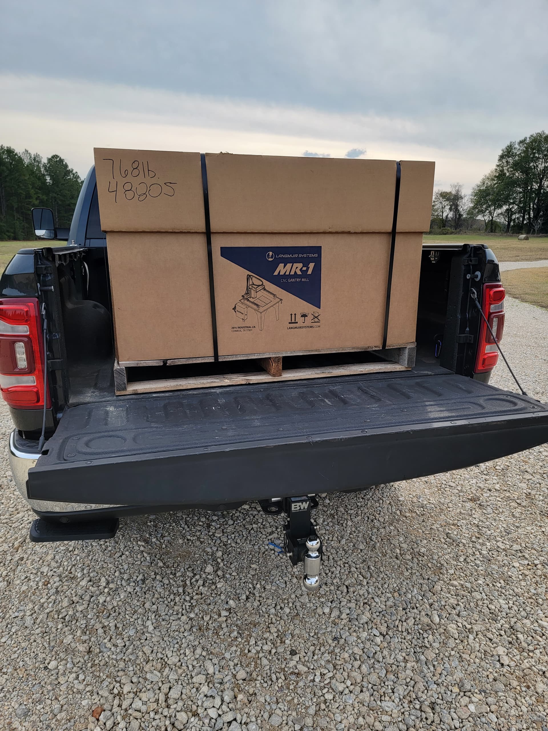

MR-1 Build Fifty-Seven
Picked up my MR-1 yesterday. Assembled the base last night and poured concrete today. This is build Fifty-Seven because it seems like Heinz Ketchup, with the waiting and anticipation. Waiting on the concrete to dry out for 5 days now and then another 2 days for the epoxy. My MR-1 Serial# is 0009. Not sure how the units were packed and staged, but there were over a hundred other orders in before mine. It’s all good!
