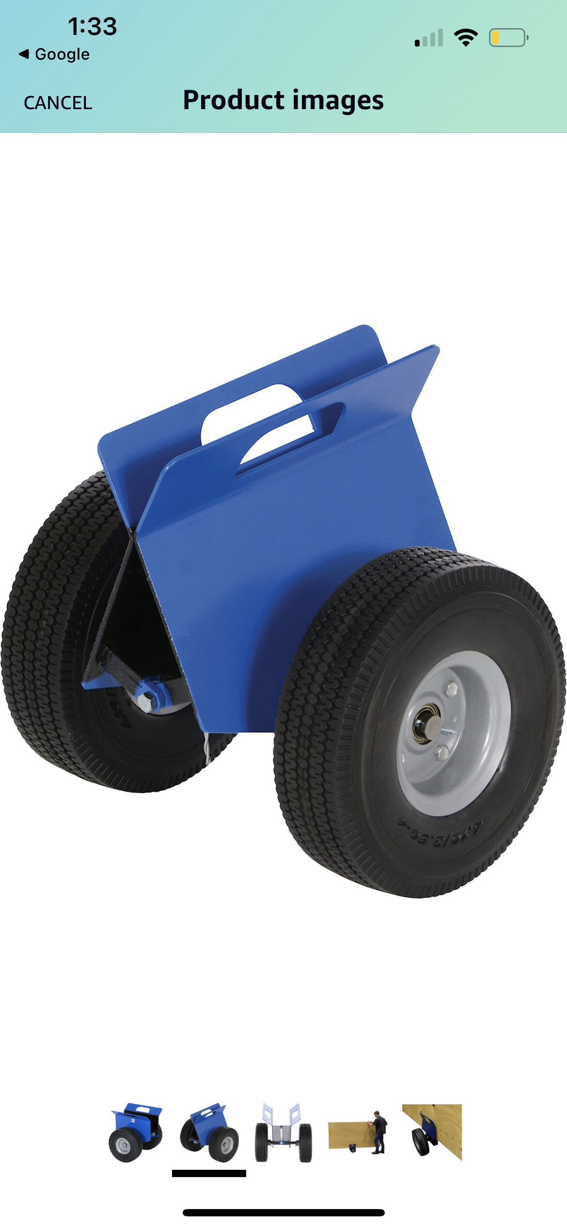

I found some “panel dollies” that look like the may be decent to get the plate into the shop. I’m thinking a come along to an over head hook bolted through a beam above.
My biggest hurdle will be getting the plate tipped on edge and into the panel dolly…… while it’s in the parking lot….
I think you might have several hurdles: A quick calculation has a 3/8" x 4 x 8 sheet weighing about 500 pounds!
But the dolly does have merit for lighter sheets.
Welcome to the forum!
This one is rated at 500lbs, other similar styles are rated at 1000lbs.

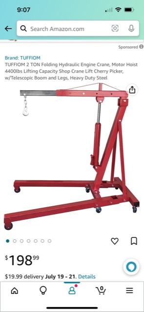

If I can find an engine hoist I’ll use a plate clamp and tip it up….
It’s insane that the price I was quoted from a local shop to cut this table out would cover buying an engine hoist….
You would need to change the chain setup.

TUFFIOM 2 TON Folding Hydraulic Engine Crane, Motor Hoist 4400lbs Lifting Capacity Shop Crane Lift Cherry Picker, w/Telescopic Boom and Legs, Heavy Duty Steel https://a.co/d/dGMqakw
