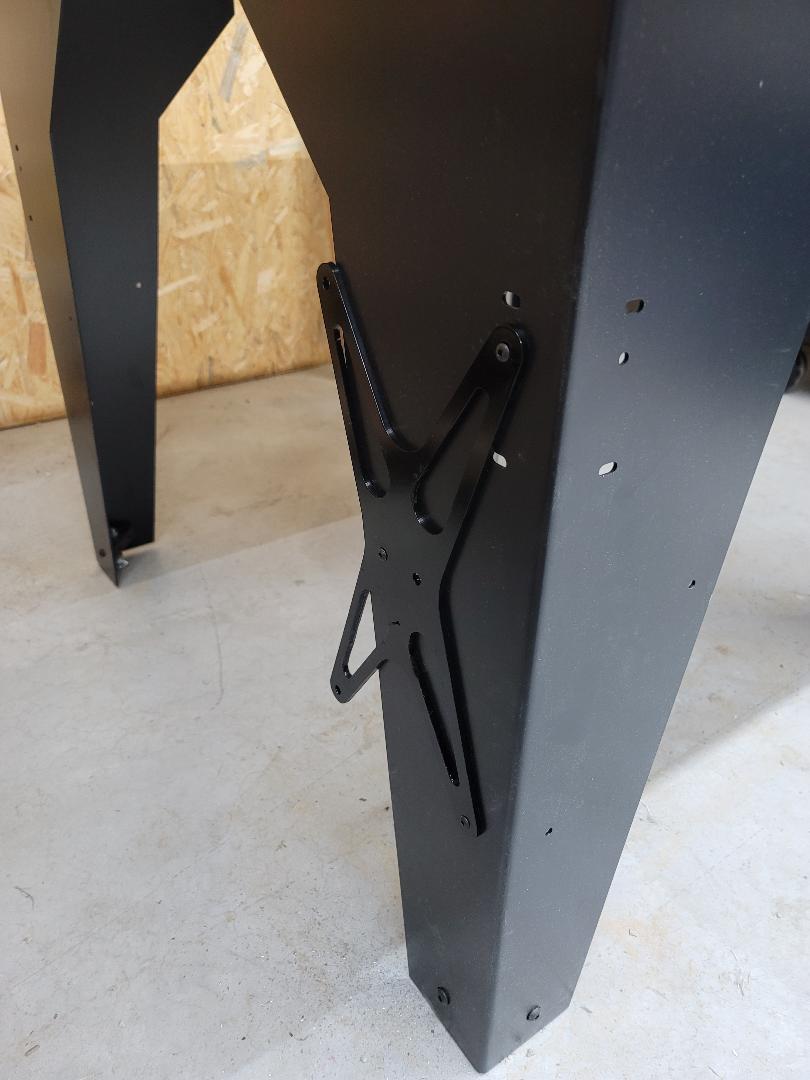

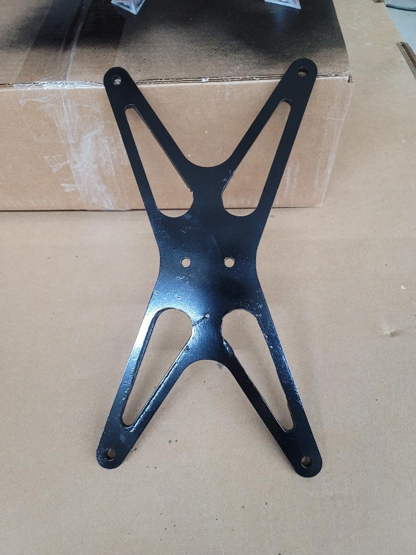

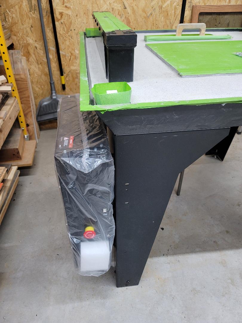

I moved the control box to the front left leg instead of mounting it at the rear left leg. I fabricated a bracket that would attach to the front leg and allow me to attach the control box to the bracket. Only sticks out about an 1 1/2 inches in the front and adds 3/16 additional stick out to the side. (due to the bracket being 3/16 plate steel). A measured drawing (DXF) will be available at the end of this post. LOL

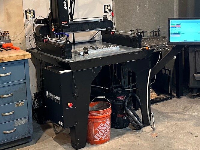

I did the same on Sunday, also move the monitor to the right side, the only cable that is short is the USB connection to the controller.I ordered a right angle connector on Amazon with a 10 foot cord. For now it’s twist tied across the front

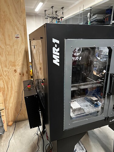

I moved mine up the side of the enclosure and turned it, so I can reach the e-stop and the power switches from the front easily.

Hey @motoracer450 , Did you forget to put the DXF? shoot me a message or a email. I’d be willing to purchase the DXF you made. Michael@halespeed.com
I thought I posted it. Here it is .
Control box mount v2.dxf (456.5 KB)
I appreciate it very much! Anything i can do to helpyou?
This definitely does not work if you have the enclosure, cables are too short :pensive:
I moved mine to the front left side and had no issues with the cables.
Hm. I have an assembled version so maybe that’s why. I would also not be surprised if they’ve changed their cable lengths since the early units and/or didn’t have very consistent lengths at the beginning.
