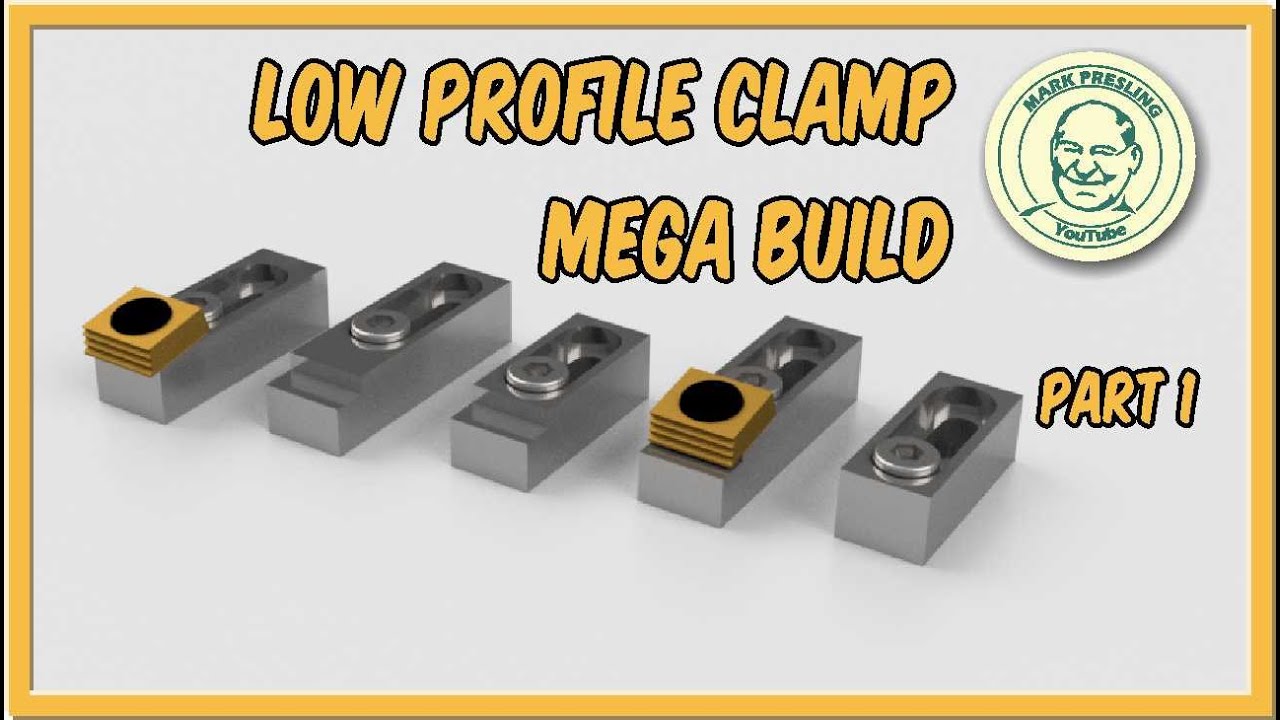

If you have more time than money you can knock out your own mighty bite style clamps.
And make hardened jaws for them.
I’ve also made low profile “mitee bites” fore use on a fixture plate. Some brass hex and turn an eccentric bolt on the lathe and done mostly. Much cheaper and once your set up you can bang a bunch out. Not sure how mine compare in strength to the actual product, but I’ve never had an issue with them. Side note: I agree that 4 jaw is the way to go on the mill. Small 3 jaws dont have the holding power of a 4.
