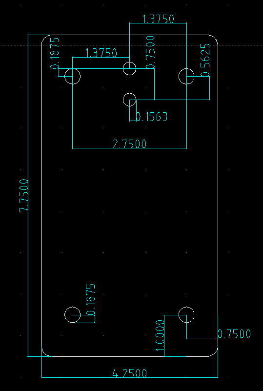

I’m modeling the CFPro in Fusion and need a few measurements can anyone help me out?
left or right rails the table gussets. Even a straight on picture of the gussets would be good enough. I can trace them in fusion.
Thanks in advance. I will make the file available when I get it done, I could also share it if others want to work on it.
Here is a DXF s of the stanchion risers og and 2 risers. 3/16" thick.
Stanchion Crossfire Pro TinWhisperer.dxf (3.4 KB)
Stanchion 2 inch Riser Crossfire Pro TinWhisperer.dxf (3.4 KB)

@TinWhisperer would you happen to have to overall dimensional measurement of the taller stanchion. I downloaded the file but i never trust dxf files to be scaled properly. currently i am measuring 7.75 overall height and 4.25 wide. also…would there be any issue that you foresaw using 1/4 plate instead of 3/16?
I’ll check my drawing on the computer.
I think you have to use 3/16 on the outside but you might be able to get away with quarter inch on the inside plates.

I found this really handy while making my version, so I added a dimensions layer (in librecad, hopefully it works elsewhere). I’ll add a png of the dims as well. I’m doing the holes on the mill with the DRO, hence dimensions. Thanks for doing the bulk of the work Tin.
Stanchion 2 inch Riser Crossfire Pro TinWhisperer.dxf (46.7 KB)
