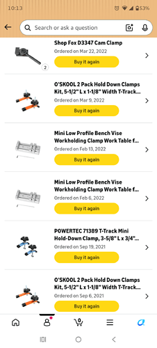

I totally get that. Heres the stuff i use on the router.

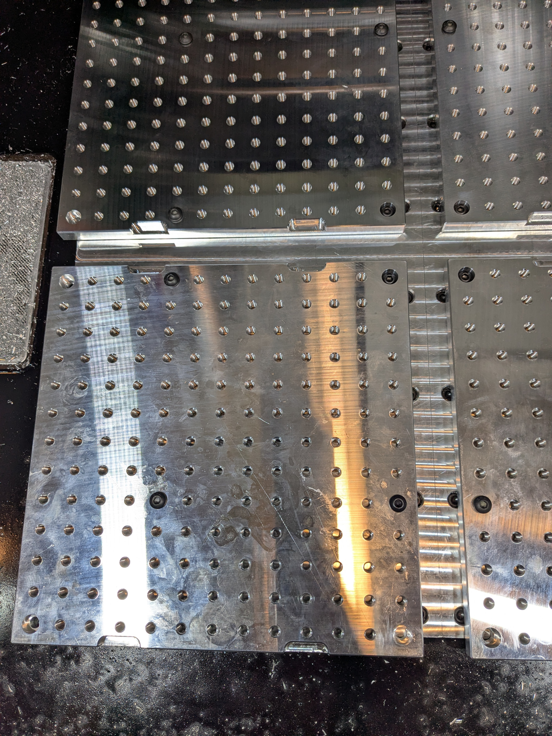

I went with making some aluminum spoil blocks and put a grid of 1/4-20 holes on them. I try to lay out my thin parts where I can screw down the sheet.
Work process is to clamp the sheet down, drill holes for applicable 1/4-20 locations, bolt the sheet down, remove toe clamps and mill the profiles leaving tabs at the screw locations. After that op I’ll use an engraving mill to cut along the edge of the parts at the tabs and give them a breaking point. Then snap off the tabs and file or sand the edges on the finished part.

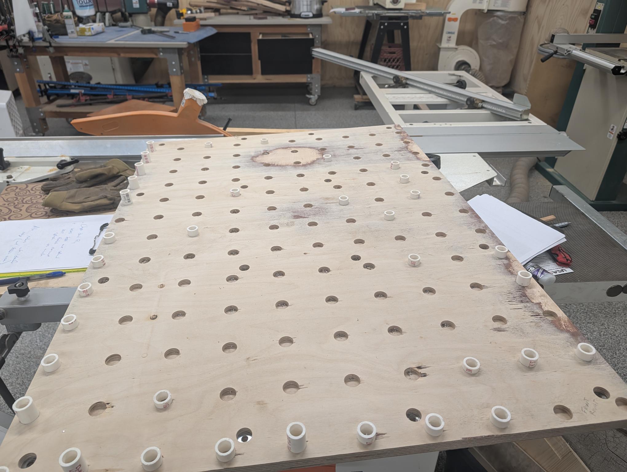

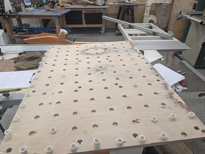

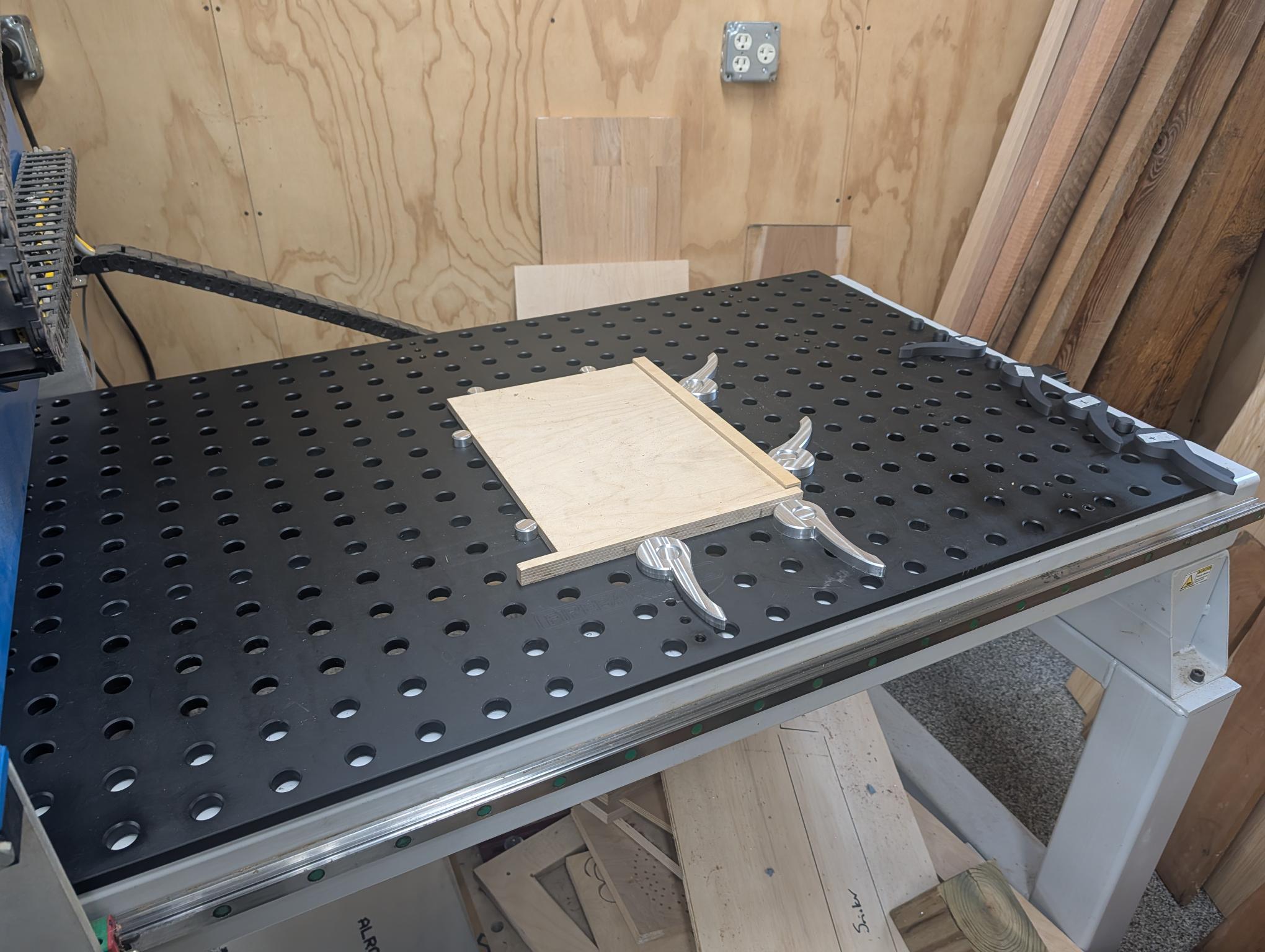

I have had a router for 10 plus years and I have tried may hold down technigues….t-slots, clamps, etc. By far the best I have ever used is dog holes and dogs with wood wedges to hold down flat pieces. I don’t use the wedges anymore as now I made the offset clamps on my MR1. However,
I used this wood one for years and yes, pvc dogs. Worked excellent. And strong.
As far as finishing, I used tabs as has been mentioned, but I made them only as large as needed then cut them out on a bandsaw or multitool saw. Then I use a flush cutting bit on a router table - on aluminum too.
Clamps just seem to get in the way. Glued stuff (super glue and painters tap) is a pain. Screwed down stuff takes extra steps.
Since you sound like you may do quite a few, bolt some pvc dogs to the plate and make some slow tapered wood wedges and you will see what I mean. At the very least it would not take long to try it. And the zero location is repeatable too.

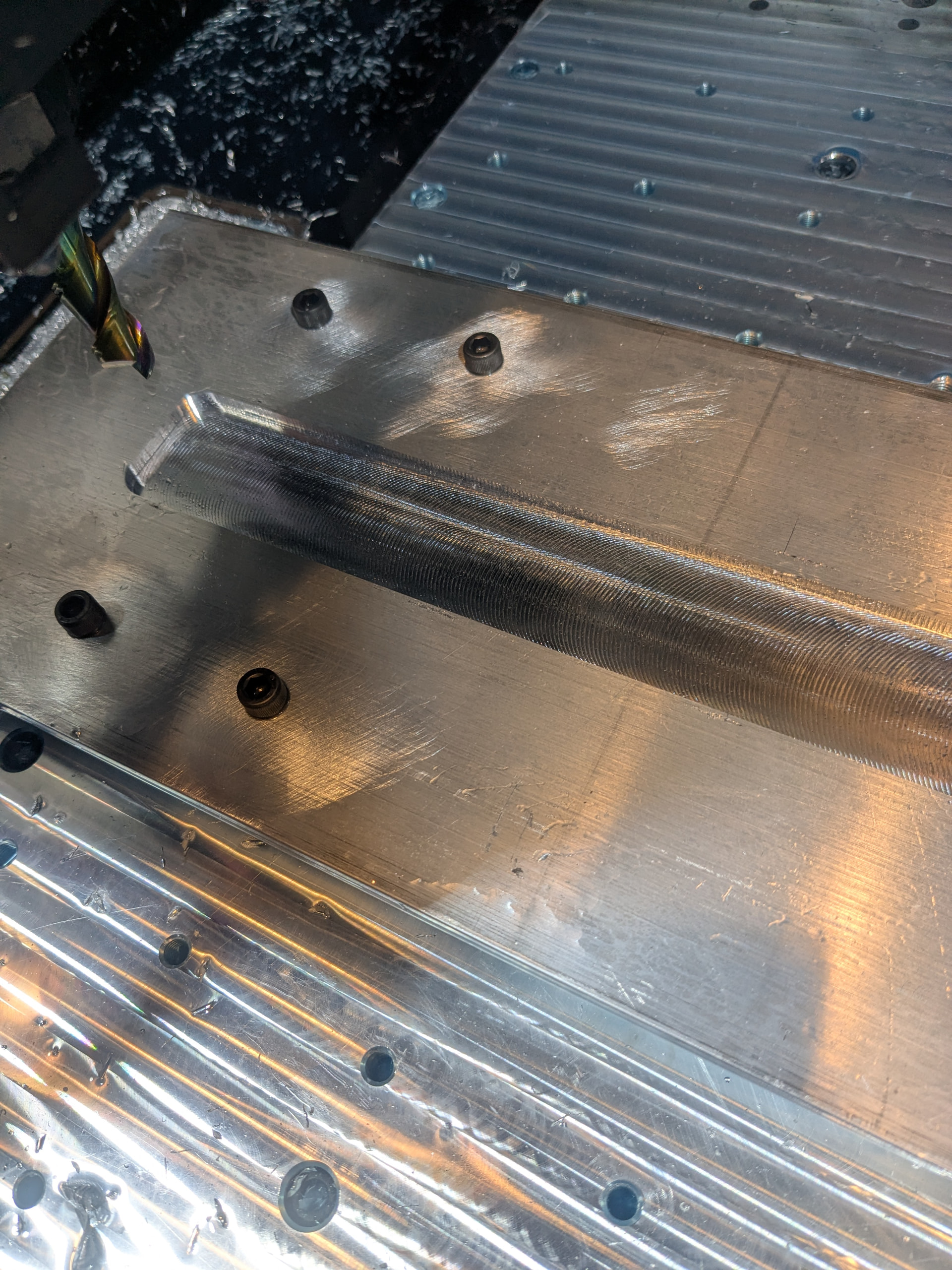

I don’t have any pics, but imagine a grid plate like this:
Made up of 4 pieces of 1x4 x 10” 6061 aluminum. I bolt them down to the MR1 table and skim the face with my fly cutter to make sure they are all level and then mount my plate.
It’s a welding table I bought :slight_smile:
Looks like a good table. But my curiosity is about the black sheet on top with the holes. It looks like some kind of plastic?

Seriously it is a metal welding table top. It fit my CNC router footprint like it was designed for it.
Bought it here https://www.fireballtool.com/ The will sell the whole table or just the top.
Wow… that’s cool piece of steel plate!

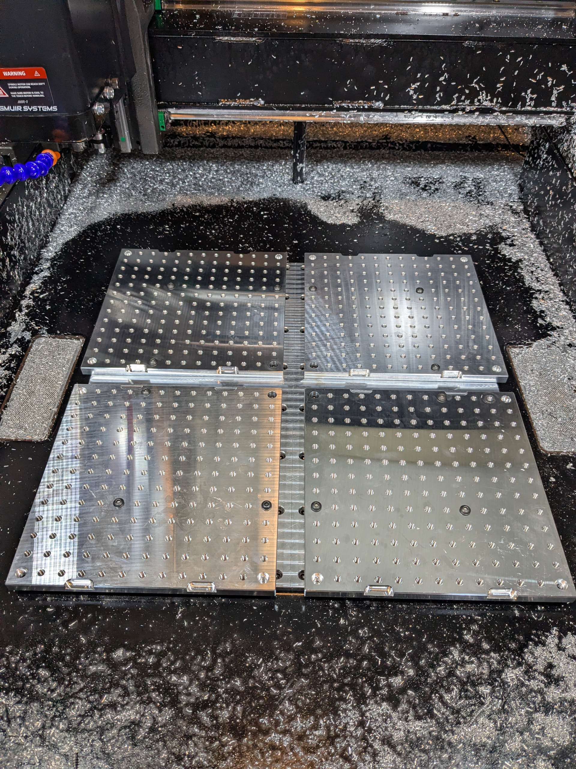

@bcrimmins I am milling thru pockets on flat sheets as well. Im a beginner, but we have the same application so lets share our learnings! Heres my learnings so far in trying to machine thru pockets in 1/4” thick 6061 aluminum plate;
  1. Mounting the spindle in the down position was problem for me, I couldn’t get a good tram. So I mounted in the up position intending to reach the baseplate via the shank extender from Langmuir more to follow on that in point 3. Also This tram tool was invaluable for me SST - Mini Mill & Lathe Tramming System - Tram, Align, & Square for Machine Calibration - For Angular Misalignment - Precise & Powerful - 0.001” Dial Indicators - Designed in the USA: Amazon.com: Industrial & Scientific
  2. I decided to mount my plate via these bolt depot standoffs. I chose aluminum because of price. I probed these all for accuracy once torqued into my baseplate and surprisingly the z axis runout was only .002” across the entire span of the baseplate and 40 different standoffs. Also the worst hole center runout across x or y was .003” *Note my baseplate holes are not square to my gantry (normal due to placement errors in the concrete) but are pretty good, .02” runout across all axis. I drilled the mounting holes in my workpiece plates 9/32” and this gives me enough play to tram the plates in perfectly. https://boltdepot.com/Product-Details?product=29307
  3. I machined my first pocket with a 1/2” endmill from Langmuir and had horrible chatter. I tried all adjustment settings and just couldnt get the chatter to stop. I removed the shank extender and boom, chatter was gone. Im convinced the extender cant be used to reach the baseplate without introducing chatter while cutting with endmills.

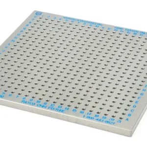

  4. Now that the extender is out, I cannot reach the bottom of my 1/4” plate with a 1/8” endmill. I need the 1/8” endmill for my corners and finish passes. I solved reach issue with two products; 1- Fixture plates from CZ industries. These increase my workholding envelope, give me tons of mounting options, and mount right up to the MR1 baseplate. The SMW baseplate is the gold standard but I wanted to try these before springing on a $2k upgrade. So far Im tickled with how they work. But I still couldnt reach the bottom of the 1/4” plate with a 5/8” standoff and a .5” fixture plate. So now I ordered up the 7/8” standoffs and will try again. I did some ChatGPT calcs and with 8 of these standoffs I can have enough rigidity to machine with no deflection.https://www.czindstore.com/product-page/imperial-fixture-plates
