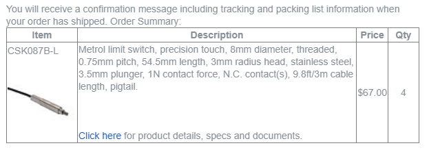

I installed my switched and installed the limit switch main cable. First question, when the switches are in normal state with no plungers being depressed, should the leds on the cables be lit? They are as I have it wired currently. If I switch the wires then they do nothing, well they don’t light up.
What drives this question you ask? I have an error on limit Y2/Z. LS was gracious enough to help me trouble shoot and decided it was the cable. They sent a new cable and same issue. Now it may be internal. Before I do that, I want to be sure I am wired right.

Did you purchase the N/C switches? They have two versions. N/C is what you need. If you got the N/O, that may be your problem.
CSK087BL
Thought about that too. these are what I have.

Those are the correct ones. Are you sure they actually sent you those? They should be closed without being pushed. I cut off the led section and shortened the leads to match the Langmuir harness. I wonder if the led is confusing Cutcontrol.
I posted this question on Facebook as well and that was one response I got was the leds on Z could be throwing a bad signal to the shared cable of Y2/Z. Makes total sense. Thanks!
Let me know if it works. I cut mine off first thing. So, I never tried them with the LED on. There may be enough resistance to mess with the program
Will do for sure.
Ok, as promised I would give you a status. West Travis suggestion worked. I cut out the LED from the z axis limit switch and the problem was solved. The LEDs on the y axis made it super simple to set up the home state. We are off and running. Thanks everyone who responded. Special thanks to West.
