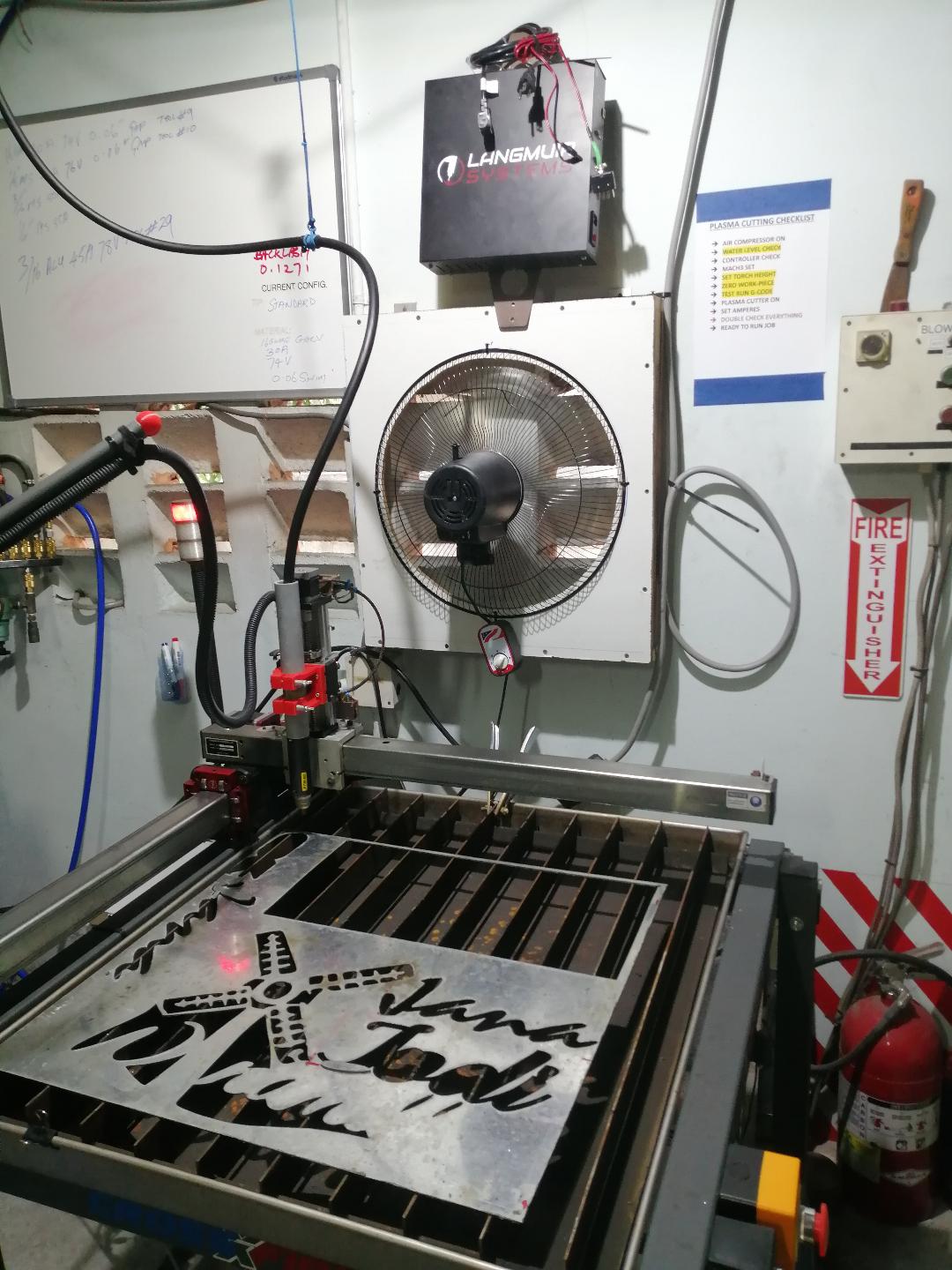

I’ve got an extractor fan in the wall just behind my machine which seems to take care of it nicely for me (not sure how the neighbor deals with it :rofl: )
