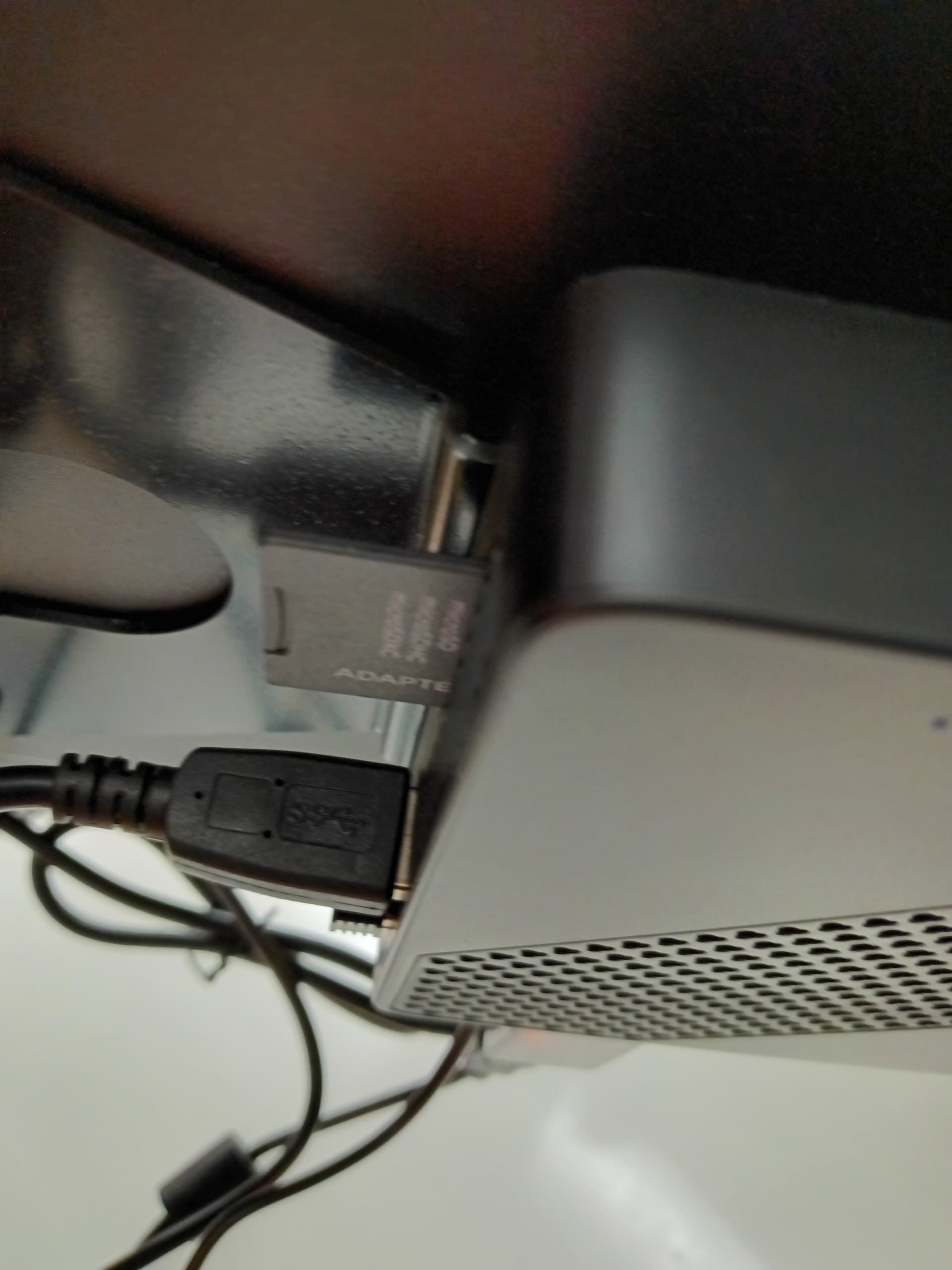

** SD card not showing up on mini computer**
Hello, is anyone else having problems getting their SD card to read using the Mini PC? I’ve used up all the usb ports and figured that I would be able to use the SD card slot to transfer the NC files to the MR-1… No go. I doesn’t even show up. I’ve looked at the device manager for solution, but nothing. Also, I can’t get the Mini PC to show up on my network so that I can transfer files over the network. Any thoughts?
My little sd card in the reader.
I had this problem, just go force windows updates to run on it a few times and do some reboots. It seems like it struggled (or was too slow for my taste) to do all the updates. Once I got through a few of those, it was a much happier little machine. As for having it on your network, my default state is disconnected from network as I am not really looking to properly secure the machine :slight_smile:
Thanks so much for the feedback. I really appreciate it. Did you update your mini pc to windows 11? Mine is asking me that as I run windows update.
