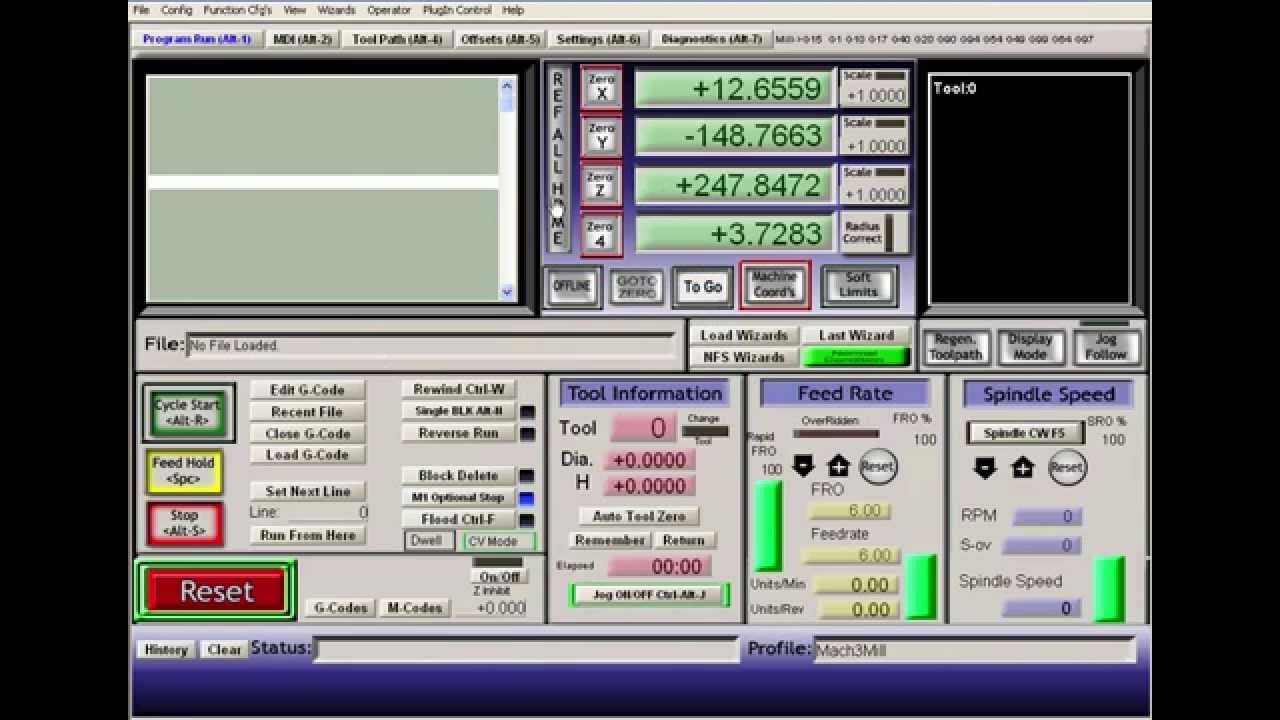

When I start a cycle in mach 3 the image looks good I am home in the bottom left corner. Everything looks good. When I hit start. It runs off the image and cuts it on a slant till it bottoms out the screws. I have a video. Here is the link. https://youtu.be/x2Ktwag0M-s

Are you setting your orgins to zero when you align your torch to the bottom left corner? Not sure about the cutting on a slant, almost sounds like the gcode has some rotation built into it, depending on what your video looks like.

Soft limit warning. continue? Is what it looks like his pop up says.
I’ve never seen that, I was just wondering if his machine home buttons are set at something other than zero? that’s why I asked him to hit the zero all?
What do you think? post processor maybe?
I would regain tool path , after i made sure lead screws didnt slip and was tight. And the table cordanance was where i wanted it. And the pop up I have never seen so no idea about it. And I think it could have something to do where the project was placed in the begining. Last time I had an issue simular to his vid: I was manually jogging and bottomed it out and didnt regain tool path. A few things it could be. I dont think it will be hard to figure out, but still a real pain. At beginning its all zeroed out in vid. After watching it again I see the image is in the upper right corner. Mine is always in the middle.
Whats weird is you machine command is telling it to go to X 3.37, and it’s already past that number in your DRO, which started from Zero… There also seems to be a common number in your program… 03937… Which is used to convert metric to english and vise/versa… All my programs have a units code in the beginning, I believe G21 for Metric, and G20 for english… Not at my machine at the moment so take with a grain of salt… I’d do as stated above… set your corner to 0,0,0 on the read out in your lower left corner, then hit regen toolpath and see if that helps… The softlimit error is in Z which is one of the 03937 errors… seems to be a small tip to material distance anyway, but shouldnt effect your machine taking off in X and Y… You can also set Zero, and manually jog the machine around and select jog follow to see what that looks like… On screen vs. at table. What is M06??? I don’t use that at all… Just M03 torch on, M05 torch off…
M06 is a tool changer command… Delete that line from your program… What post are you using? I’m suspecting not the right one… It appears the first command is to go to your toolchanger and grab tool number 1… That may be your problem…

One other thing… It looks like a green light is lit up around your soft limits button, so they are active, click that button to turn them off, that will probably get rid of the error if you have never actually set up your soft limits… Also it looks like there is a red light around your machine coords button. I can remember but I think that is lit when you are looking at machine coords… so zeroing the machine coords is not actually zeroing the programmed coords… toggle that switch…

Yea. I have my soft limits set at 23. And when it runs my program it will cut one section. Move to the right about 5 in. And repeat till it bottoms out the screws
No. It is all zeroed in the corner
I use inkscape and sheetcam
It’s a soft limit warning. I have it set at 23 inches. But the table will cut a section. Move approximately 5 inches to the right. Then cut another section till it bottoms out the screws.
