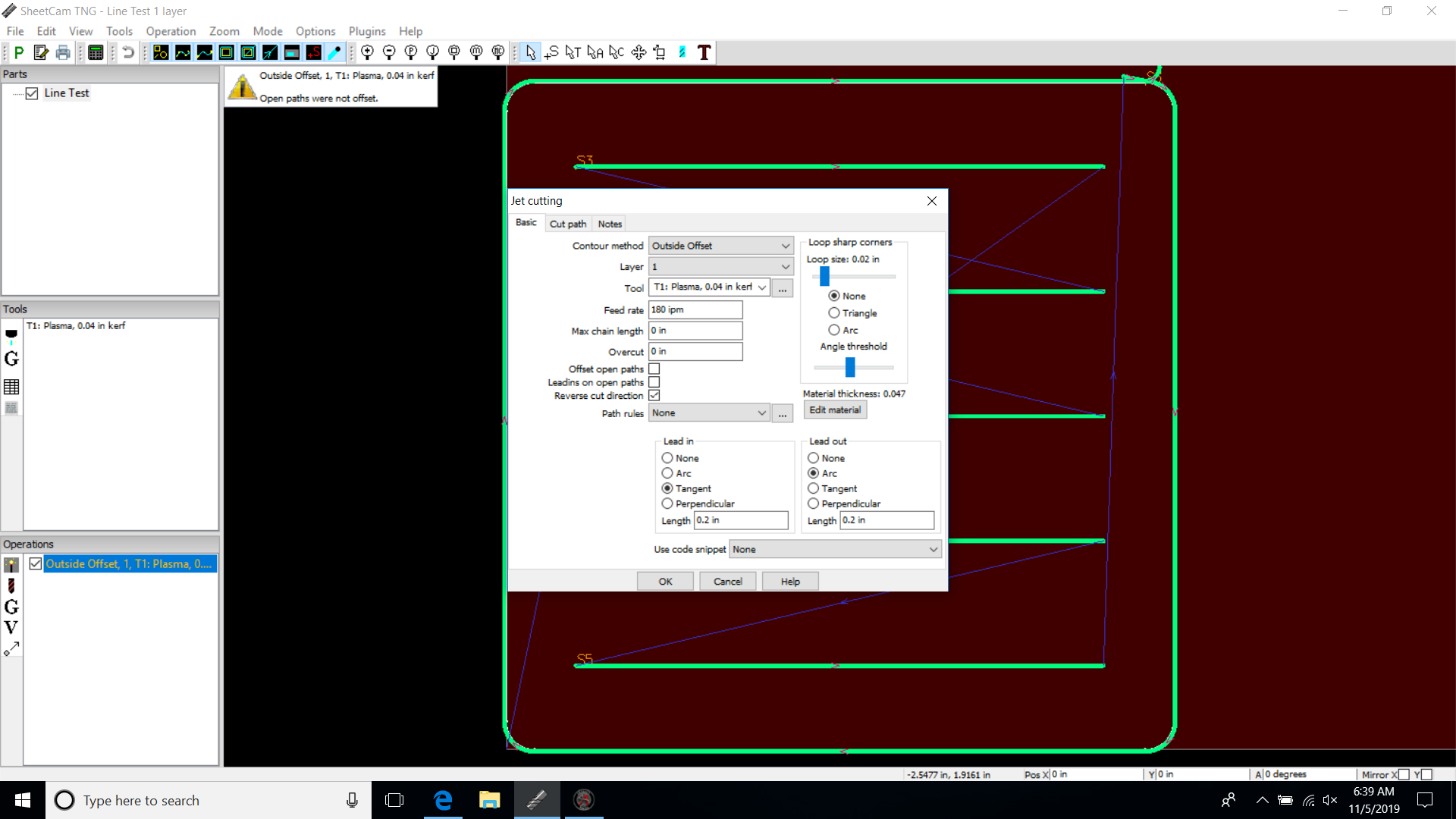

Looking for your Sheetcam setup.

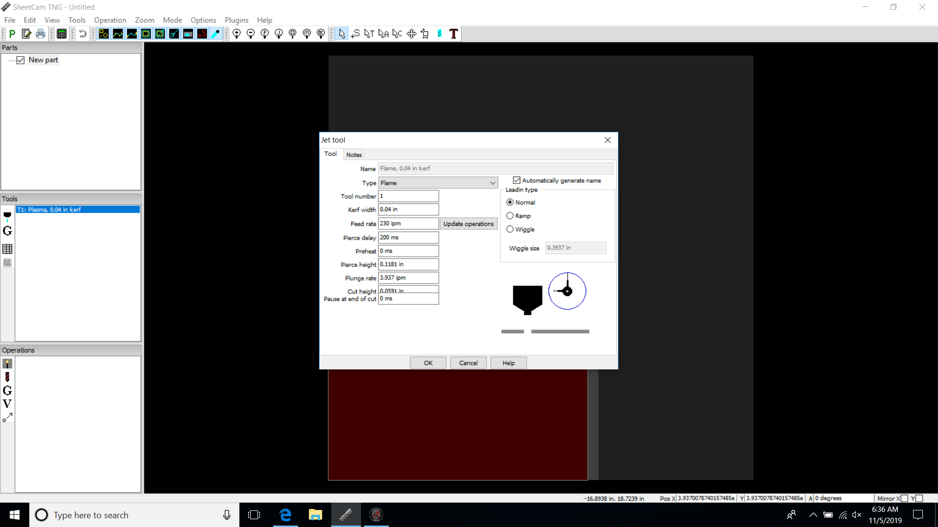

On the left there’s the Tools set:
Pick one and double-click to open it up and show the detailed definition:
Then in the lower left is the Operations box where you define your toolpath operations:
Pick one and double-click so I can see how you’ve set the operation to use the tool.

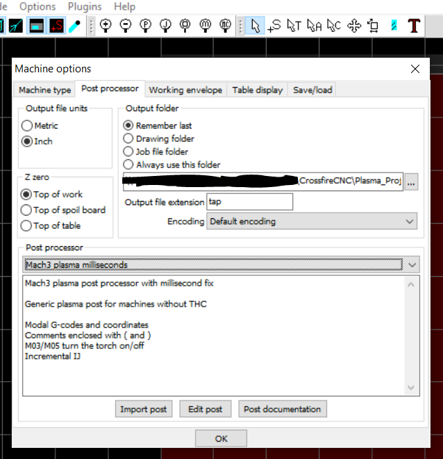

While you’re at it, can you also grab your Options|Machine|Post processor window?
I’ve got my no-THC profile (modded) but I haven’t changed any of my tools or operations after I swapped the modded post and didn’t see the delays you were seeing. I’m thinking possibly my settings don’t cause the creation of anything meaningful in terms of Z controls so there’s no delay associated with them.

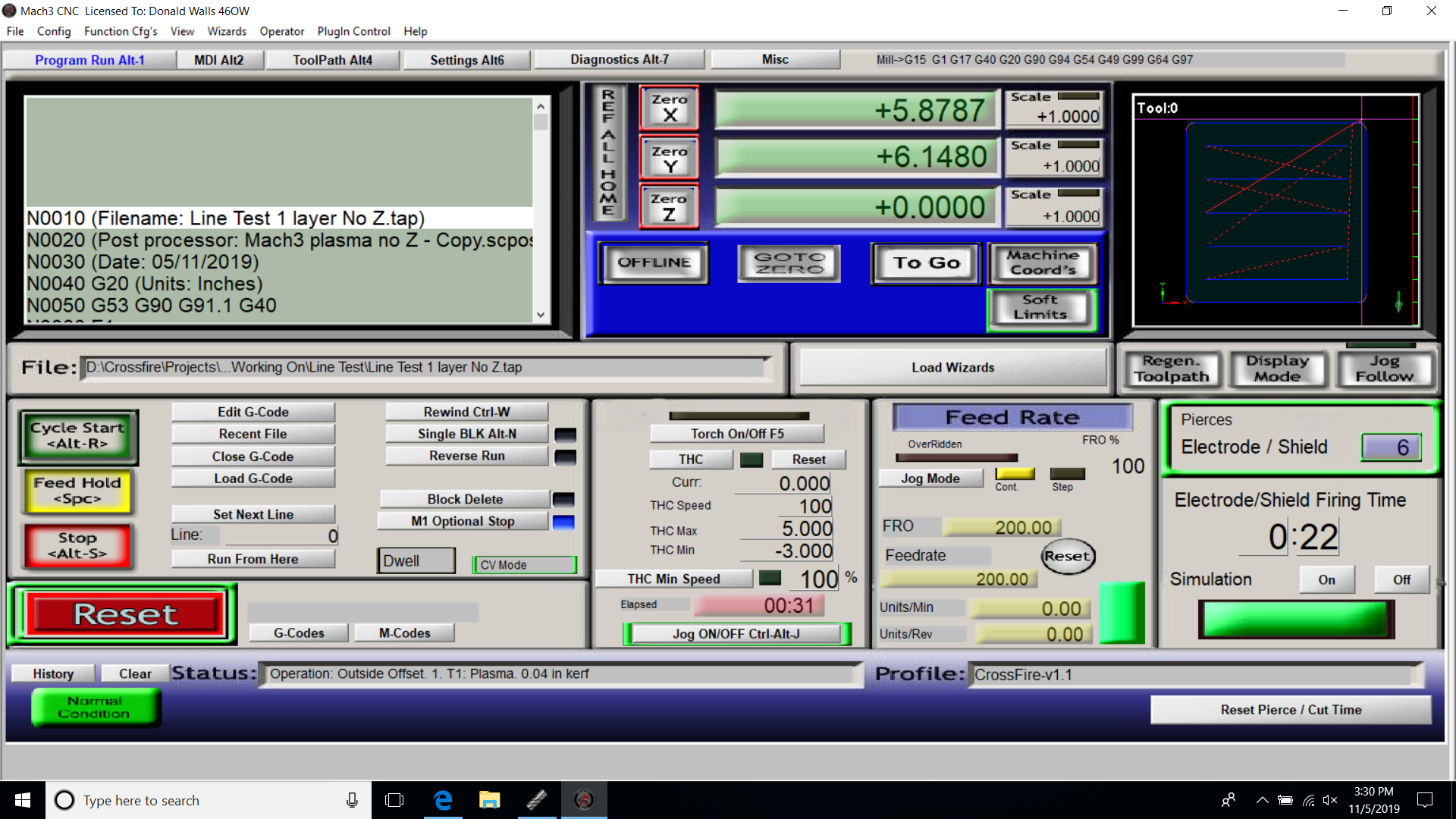

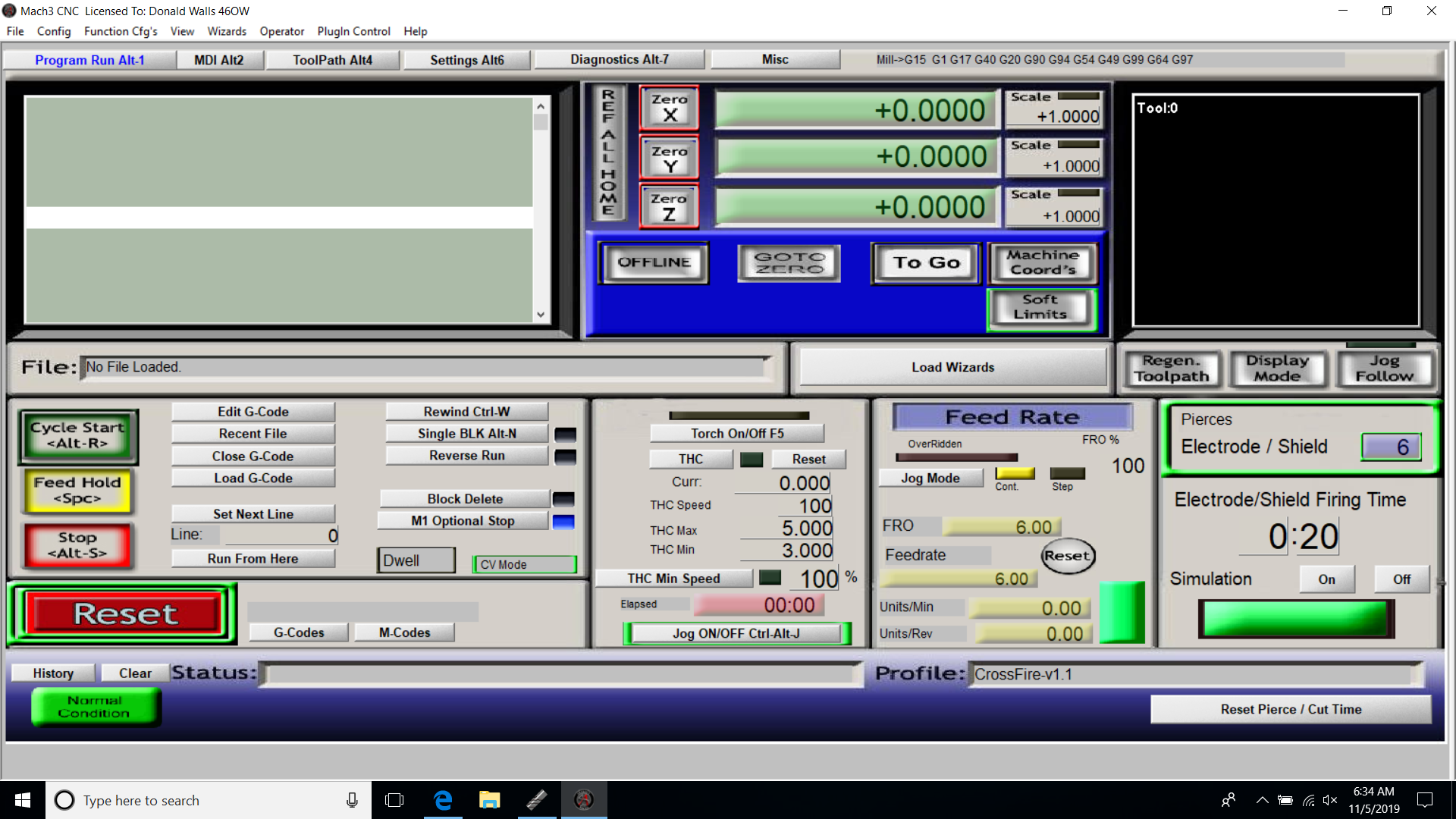

I think that one of the differences is that the other day I hit the THC Min and entered 3 to see how it did something and haven’t been able to get it back to -3 yet, I believe that is what it was on.

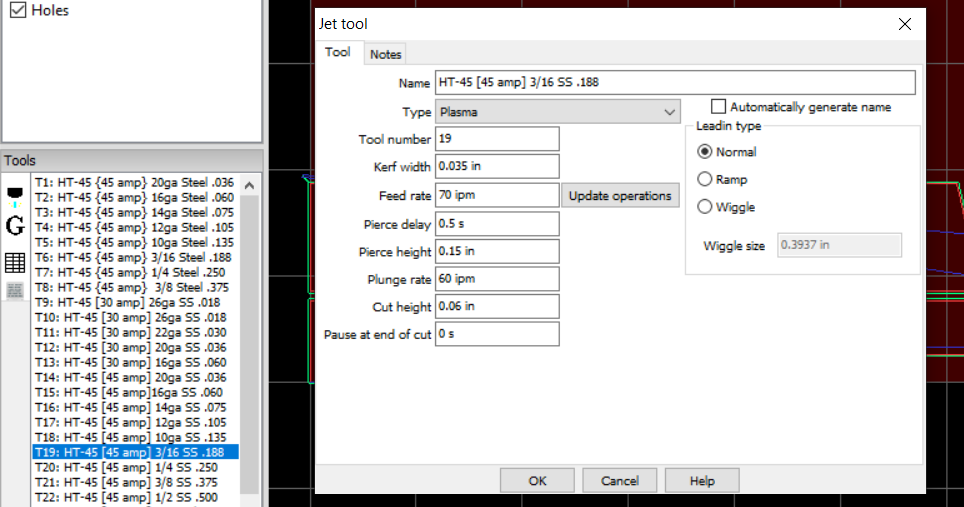

The next thing that I see is that you have your plunge rate set to 60ipm and mine is still set to 3.937 and that would explain the additional time that mine is taking to allow for travel when the z axis lines are in there.
I made a copy of the no z post then applied your fix to it.
Ok, I changed my plunge rate to 60 to match yours and I got my THC min back to -3 then ran the post again now it runs the same on both, 22sec firing time. So I believe that anyone seeing longer than expected delays using your post needs to check their plunge rate and up it to 60 or more like you have your’s. I even went up to 300 but it made no difference so I believe that your getting all you can at 60.
